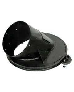

My father is in the middle of replacing what I call the auger rotating collar on his early serial number Gleaner M2. A used assembly runs about $500-$700 which is nuts for a part that could be nearly as bad as yours, and only show it after a few uses..
We've priced the new unit and have located one for around $1300 and it seems to have been redesigned to use nylon guides instead of the ball bearings like the old unit.
The local Agco dealer is looking in to having our unit rebuilt and is currently checking with some other machine shops, etc, before they give us a price and let us know if it can even be done.. So we're playing the waiting game right now..
So, my questions are:
Has anyone here installed one of the nylon guide auger rotator collars, and if so, what are you thoughts on it? Does it work well? Any problems since your installation?
From what we've learned so far, our combine is an early serial number and will have to have the auger's hydraulic cylinder chain reduced to a smaller size to fit the new rotating collar. We don't like the sound of that, but that seems to be the current method of "fixing" this badly designed rotating joint..
Here is an example of the part I'm speaking of:
Thanks in advance for any advise, anecdotes, thoughts, etc..

Mine bound up the balls last fall, wouldn't go up or down. I replaced it with one from A&I for $1000.00. No problems what so ever so far, it has the plastic slides.

Everyone I've heard using those as replacements are happy with the result. Never heard a negative comment but there is likely someone who had a bad experience. Some have put larger balls inside and got by. The circular ball design is not happy setting out in the weather especially if the joint isn't cleaned out well after harvest. Rust opens up clearances quickly and many have fell apart when folding.

I was just telling dad about that today. That i could likely order up some new, larger steel balls from a company like McMaster Carr and rebuild it myself. It would certainly be worth a try before buying a $1300 part.. And we've still got time before harvest to test it plenty.
I noticed when we had it freshly removed from the M2 that there was a large gap between the balls at the top. About the size of 1 and a half balls. So the groove is worn fairly deep in to the collar, or it's possible that a ball may have gotten left out by a previous rebuild, when assembled at the factory, or one broke and got crunched up and fell out.. Who knows..

Swivel assembly was assembled with a one ball short gap from the factory. That is the way they had to be built or it will get tight and bind up during a swing. Oiling the ball track area regularly extends their life. Keeping the combine shedded and clean in the off-season extends their life as well. I have no experience with the after-market and less expensive plastic track design and wonder if the life is going to be there ?? The old one lasted 40 yrs.

Our M2 has always been shedded except for when it was for sale at one time. We've not been able to source an original, ball bearing design rotating collar from anywhere. Our local Agco dealer is very knowledgeable and has some excellent old school mechanics there, and they all agree that you can't get the old style ball bearing rotator anymore, and the new nylon "guides" seem to be a good design from what they've seen. It's just that we're trying to save money if possible, so a rebuild is a possibility, and my father hates the idea of using anything plastic.
Another thing we don't like the sound of is that our Gleaner is an early serial number, and apparently because of that, we have to convert it over to use a smaller size of chain on the rotating collar, because the new style rotator has been designed for a smaller chain size.
So, that leads us to our current predicament. Saving money and getting the original rebuilt. So far, the Agco dealer hasn't offered any solutions on having ours rebuilt, but they say they're looking in to it. A couple of the older mechanics say that rebuilding them is a waste of time and money, because they'll fail in short order if you do. Apparently they say that from experience..
Oiling or greasing the unit seems like an extremely bad idea. You're only going to make more debris stick inside of the ball bearings. In my opinion (as an industrial maintenance mechanic) using dry lube heavily and often is the only way to go on this.. At least on the original ball bearing style of rotator.

I've seen one rebuilt and it failed soon afterwards. The chain change was from a roller chain to a forklift (leaf-type chain) which is stronger . It isn't any smaller, just attaches differently to the swivel. Your swivel design fits up thru the N-5-6-7 combines, so the chain had to get more robust to handle the longer unloader tubes and faster hydraulic swing times. Your swivel design was used 1972 thru 1982 and then it was beefed up with reinforcement to the elbow and the stronger chain. So, that meant M-3/L-3's got the new design along with N-5-6-7's 1982 or 83 and newer.

Put the new one on. If your bearing race is sprung, don't rebuild. What will it cost if old auger falls off on new truck cab?
I like to oil balls with light oil when it is put away for winter.     MACK

I believe our old one is still flat and could be rebuilt. As far as the auger falling off, we'd be more worried about the auger itself being damaged. None of our farm vehicles would be missed that much if they were dented up. lol

I have several grease zerks on mine.  I grease them daily when greasing the machine. I'd think it'd be a good idea to tap in about 6-8 zerks.  Not sure if that will collect more dust, but never had a problem yet.

EDIT: so it looks like by buying this part, we're essentially converting our early M2 over to a heavier chain style as used on the M3 and N series combines. At least that's my thinking on it. I'm also assuming we can buy this rotating collar and then buy a leaf style chain meant for the M3 or N series combines, as well as the thread block that attaches to the end of the hydraulic cylinder, to make everything fit our early M2..
My father called Sloan Express and they didn't know anything useful.
I called TractorPartsasap and they didn't know a whole lot either..
There is no phone number listed online for A&I Products.
I'm worried about converting the chain over to a different style, and how much additional cost and difficulty that will add. I can't find any business that knows anything about the conversion.

I went and had a look at an R-52 today and if it's anything like our early M2, then we'll have to switch over a lot more parts than just the rotating collar and chain type. The upper roller is different, the lower roller and it's bracket are different, the screw-in block on the end of the hydraulic cylinder is different so it can attach to the different style of chain...
This doesn't seem like Gleaner's best conversion/solution to the roller ball problem..

Why don't you buy the new swivel and cut off the chain connection block from the old swivel and carefully re-weld it onto the new swivel?? There. Problem solved.
You know, that's a great idea. Can't believe I hadn't thought of it. My only concern would be the nylon guides melting.
Now that has me wondering if I could just modify the chain connecting block on the new collar, to hold the old style chain..

The welding could be done in short bursts and then immediately cooling down with cold water to avoid getting things too hot.

I’ve replaced several ball swivels with the newer nylon swivels with good success. Here’s what I’ve learned about it.
To better fit your new nylon swivel into the auger tubing for riveting (I bolt them together), place whole nylon swivel in a deep freezer for 1-2hours before assembly. Deep freeze shrinks nylon swivel metal & it easily slides into auger tubing.
Per the nylon swivel manufacturer’s recommendation, I drilled 3 (equally spaced) grease zerk holes in outer area near nylon swivel area & grease them (half pump) daily. This happens at the same time I grease auger’s yoke (cross bearing) & auger’s bushing.
Dirt, grain, & grain fines are no problem. I’ve had them in service for over 5 years. If they get wet from setting outside, it has had no bad effects either.

Have you ever changed one on an early M2 where you had to convert over the the newer style chain that Dr. Allis mentions?

No I have not worked on an M2’s swivel. Mine are K2 machines. But the new nylon swivel’s chain configuration alignment took time to adjust properly. Besides tightening the 3 bolt chain clamp, I further adjusted the chain roller bearings (2- 1top & 1bottom)with relation to hydraulic cylinder positions. That allows proper auger movement to outer stop & inner cradling.
When I installed my first nylon swivel, I wasn’t pleased with it’s movement. It was stiff and shuttered thru it’s cycle. So I called it’s manufacturer & talked with their technical department about it’s nylon possibly requiring a “wear-in” to operate smoothly. Manufacturer was unaware about any stiffness. So I videoed it’s operation & sent it to manufacturer. Upon watching my video, they concurred & advised me about where to drill grease zerk holes in relation to its inner nylon strips. They guaranteed me that if I messed it up somehow, they’d send me another swivel with grease zerks already inserted, at no charge. Anyway, I did the work & its Works great. I’d never go back to the ball & rack design.
Because of their higher price, any of your questions pertaining to a newer nylon swivel’s adaptation, should be addressed to its manufacturer.
