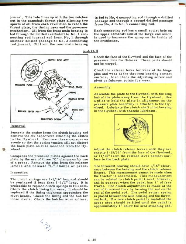

Need to adjust  play between throwout bearing and fingers on pressure plate on a g but can not figgure out how to get to the nuts to do it, It has hyd.  Thanks

  clutch is adjusted when engine is removed  with correct measurements   info. at shop   puter at home

from the service manual -
