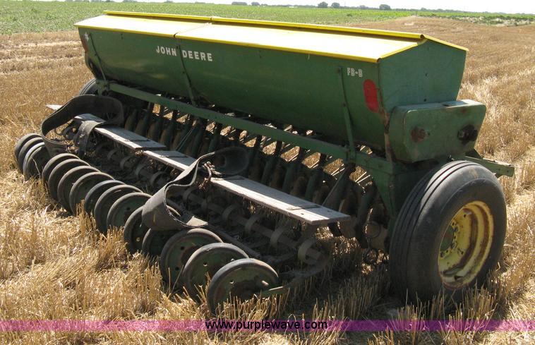

Has anyone ever added press wheels to an older drill? I have a 1950s-era John Deere FB-A drill, but if something worked on an AC or any other brand of older drill it would be a similar concept.
I searched and couldn't even find any pictures of AC drills with press wheels. They did not seem to be a common option on the JD and IH drills of the time. So far I think my options are to luck into a set from another drill or a complete parts drill with them, which hasn't happened over the last couple of years, or buy some new press wheels and fabricate something similar to the original JD attachment that attaches where the foot board goes.

Here's a picture of the JD press wheel attachment on a FB-B drill, which is probably identical to what would've gone on my drill. I was thinking of making something similar.

Those are about what I'm looking for, just hopefully not 5-6 hours away. My drill is only 7' wide so if pulling behind it I would need something a little smaller, but I may have to make that being an odd width. Alternatively doing a quick pass after seeding with a 12' packer wouldn't be that bad but it sure is nice to get things done in one pass instead of two.
I see Agrisupply has 9 1/2" wheels for $13.29 each after the bulk discount, so that might be another option if I'm willing to make something.
