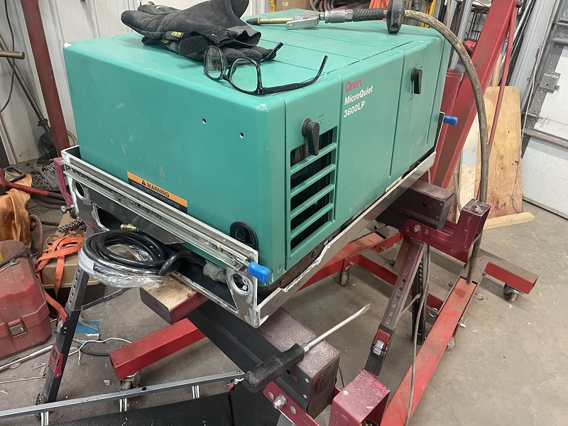

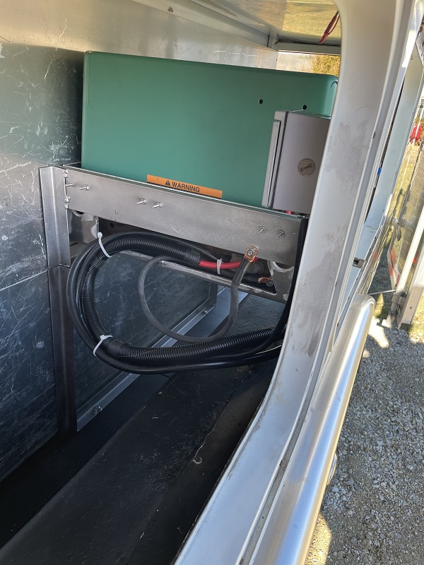

Been hard at upgrading the Living Quarters trailer we purchased, hung a 12v TV in it for the wife, have a better Antenna system coming, bought a Used Onan generator and have 'enganeared' a drawer system to mount that where will be slid Outside the body to run and utilize.  Is all slowly coming together.
Generator may not be expected to be used much but will be there Just In Case should we decide to Boondock off BLM areas.

LP, bought a 40# bottle just for the genny.

Another question: Is there an electrical Plug on the Generator to plug the Trailer Power Chord in to, or are you hard-wiring in to the Trailer?
Points: 34887
Post Options Post Options   Thanks (0) Thanks(0)   Quote DMiller Quote  Post ReplyReply Direct Link To This Post Posted: 15 Feb 2025 at 1:53pm

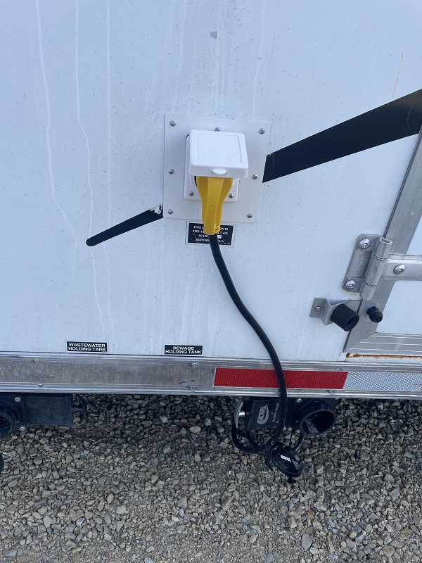

Will be hard wired.  And at max consumption CAN burn up to .7gal but expected at .5gal per hour/Half rated load. Half Gal expected.  Around Eight hours continuous duty to run the AC if not on Shore Power connection.  Should I get a Diesel or Propane (LP) RV Generator?

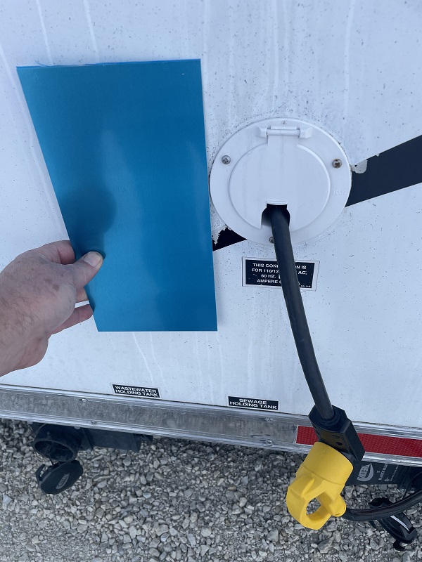

I also changed from a Stowed at entry point cable to a Plug in on the outer wall for electric power, the added connection for a generator is already on the Breaker Board panel.

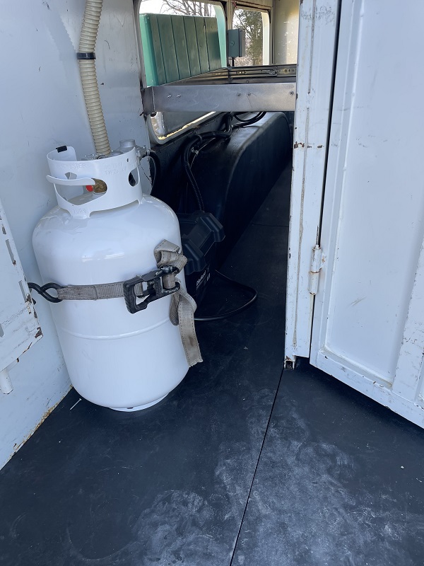

Dave just curious, was that a storage compartment before?
Nice work looks like it’s made to go in there.
This rig will be much better made than a camper only.
Impressed.
Points: 34887
Post Options Post Options   Thanks (0) Thanks(0)   Quote DMiller Quote  Post ReplyReply Direct Link To This Post Posted: 16 Feb 2025 at 6:11am

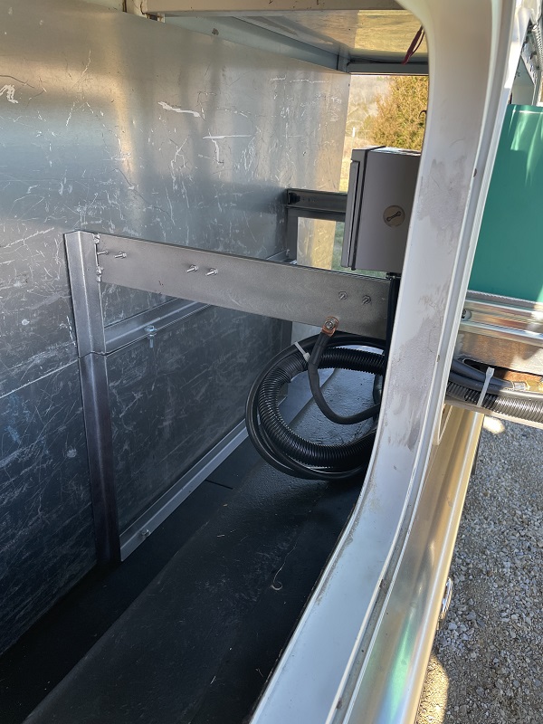

The compartments were for feed or hay storage for the manger above them so could feed from outside. Just happened to be adequate to install this. Was seriously looking to a portable genny when this one showed up on a search for less than half new price. Most take outs if catch one at salvage yards are near to new price.

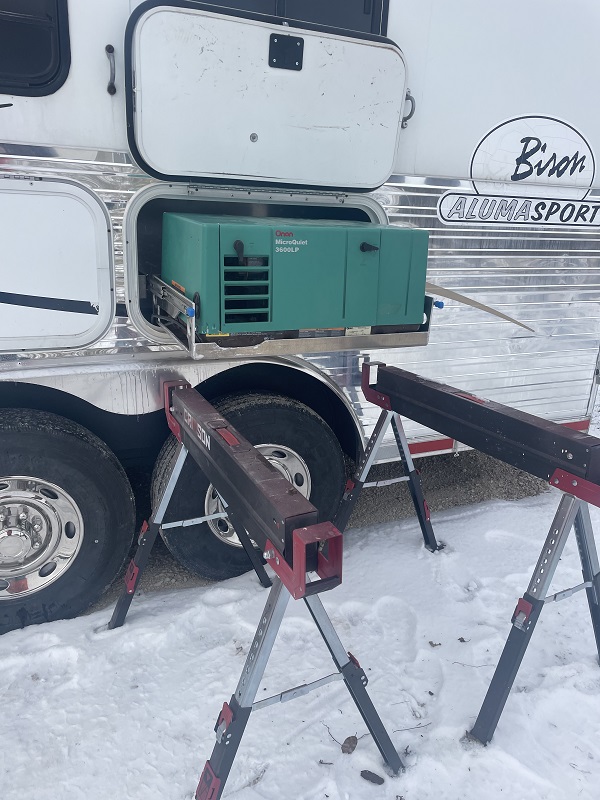

Curious, Is that compartment SEALED really,really well ???
if not , maybe spray some 'flexiseal' to 100% of it
 Concern is gas fumes getting in.
Points: 34887
Post Options Post Options   Thanks (0) Thanks(0)   Quote DMiller Quote  Post ReplyReply Direct Link To This Post Posted: 16 Feb 2025 at 8:45am

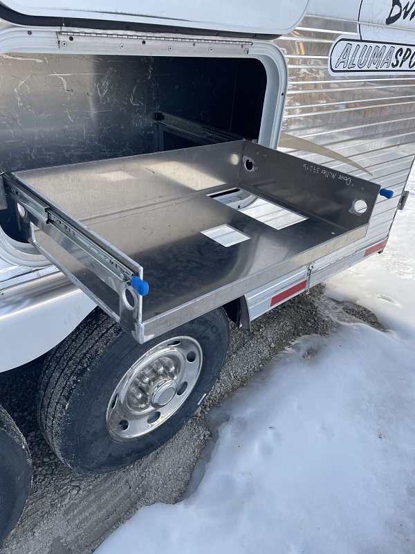

Gen will not be Inside to run it, such is why in a Drawer and not a fixed shelf, also aids in keeping Cooling air across Gen Electronics packages and Engine.  Most RVs have a dedicated Under Floor Open bottom package stowage point with a grating Door or cover to allow that air flow, will see the tiny exhaust pipe pointed Out from under those locations on most of those.  Ours will be Unstowed, operated Externally and then returned to stowage after shut off.  Did not wish to Cut access holes all over the body just to have a Generator aboard.

Generator is completed for our use, will be a outside start not remote and a cord to the Shore Power plug on the trailer to feed thru.
It is a Backup, should we use a site No Shore Power available or 'Boondocking' in unimproved sites.
