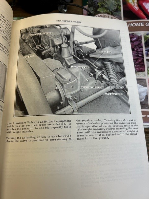

This is a picture of the transport valve and the brief description from my WD45 Diesel operators manual.

CS,
 Interesting, if all a guy wanted was a delay a flow control could do that. I suspect that this valve is internally piloted and pressure sensing. The valve could be set to shift based on certain pressures that it sees on the supply line. I'm sure others know exactly how it functions.

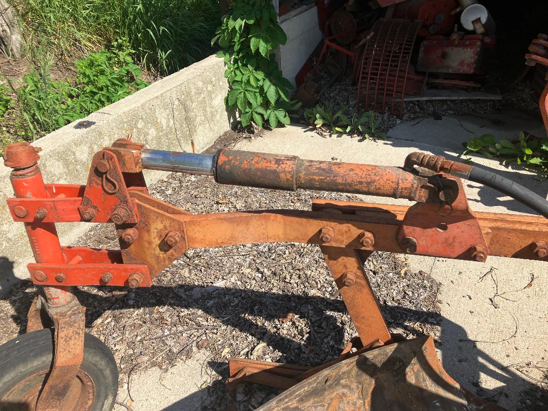

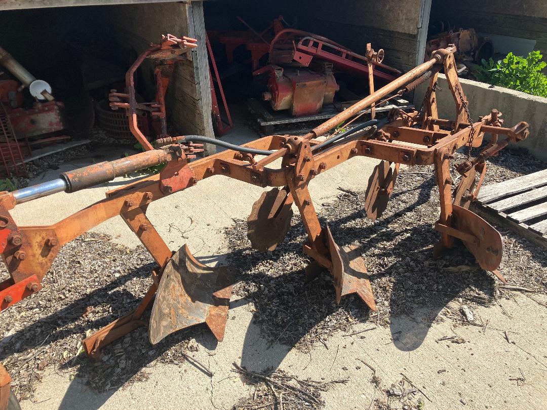

Attached is a picture of the actual plow. Not a great photo but it's all I have.

  Allis Dave,  I have a 60 series semi mounted plow and it has plenty of ground clearance when raised.
Points: 55230
Post Options Post Options   Thanks (0) Thanks(0)   Quote DiyDave Quote  Post ReplyReply Direct Link To This Post Posted: 26 May 2023 at 6:15pm
I'd say a 64, but it does have the square frame above the regular frame...  It is also missing the gauge wheel that goes in the slot forward of the tail wheel.  Post a picture side view from the coulter side, and it will help the ID process...Wink
Points: 5271
Post Options Post Options   Thanks (0) Thanks(0)   Quote PaulB Quote  Post ReplyReply Direct Link To This Post Posted: 26 May 2023 at 6:23pm
That looks to be an 80 series plow frame, as I can see the spring trips for the beams.

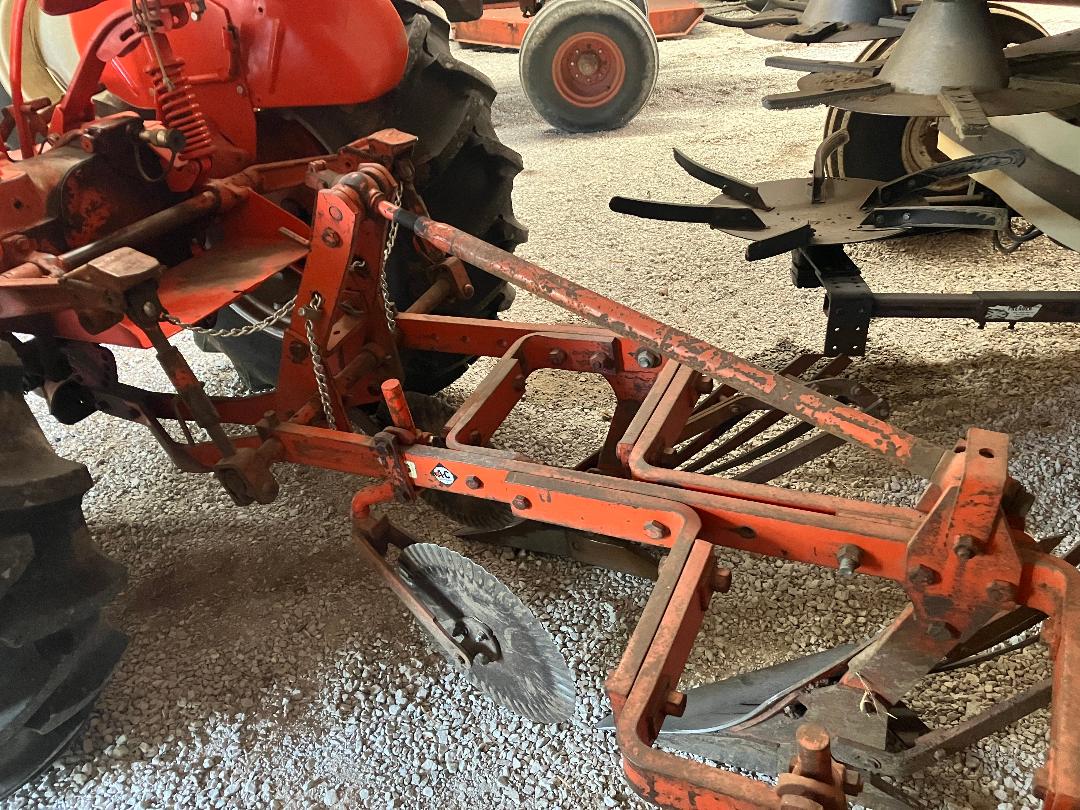

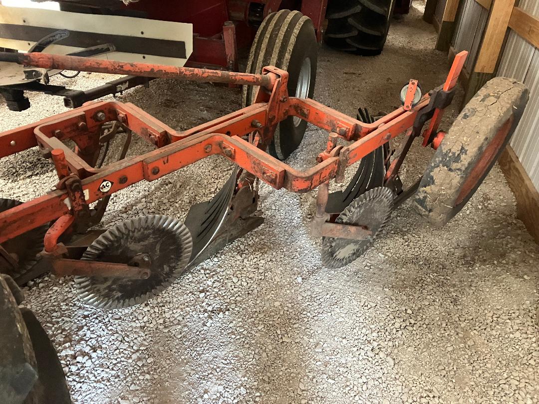

Got a few pictures yesterday, maybe get a few more today. Couple of the 73 to show the adjustable frame and a couple of the semi-mount and one of the lift cylinder.
