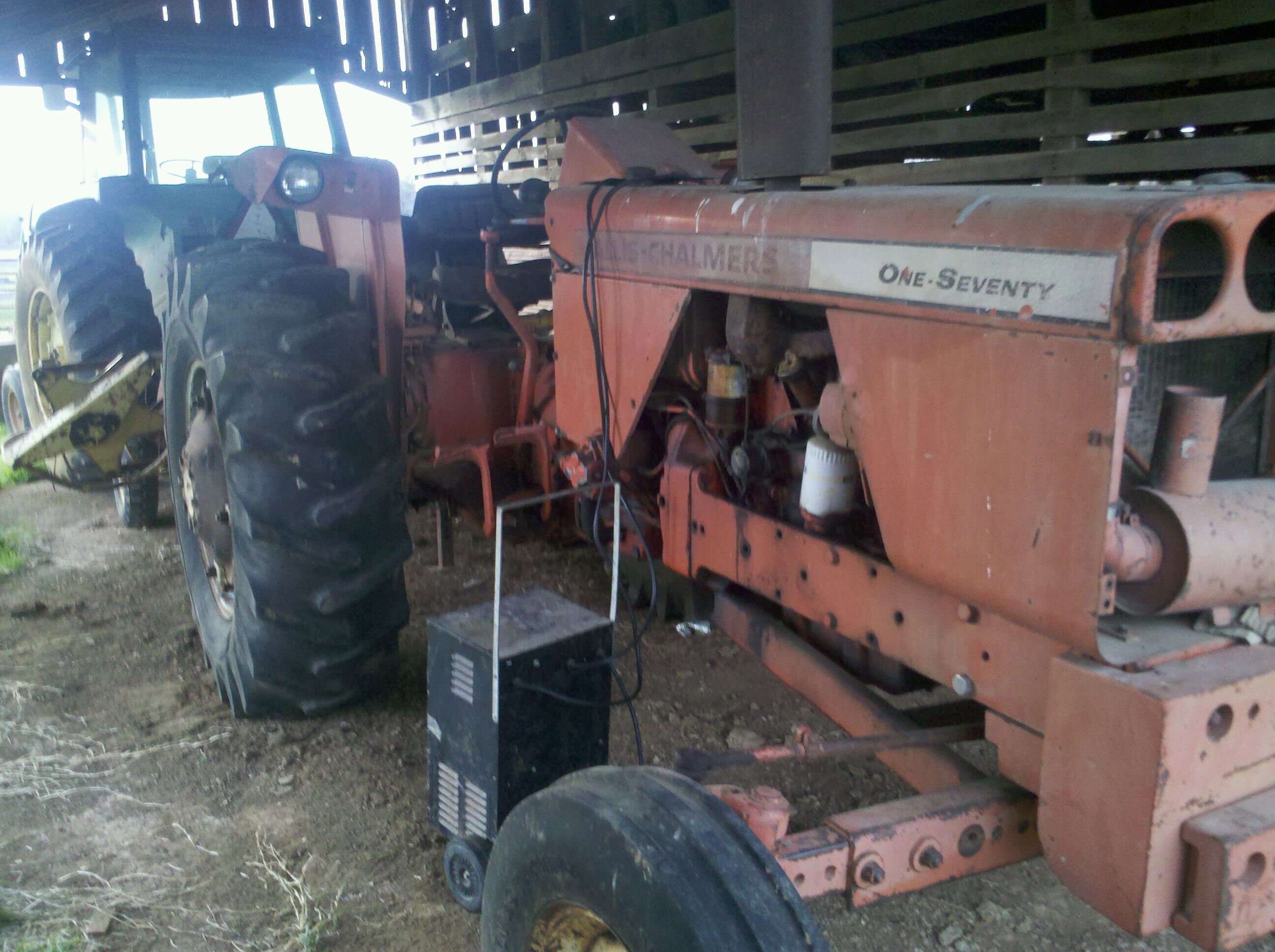

hey everyone im not new i lost all my login info and had to register again..i bought a 170 today for $600 w/cracked block and was wandering how hard it is to find a used one and how bad expensive they are?

depending on where the block is cracked...can ya JB weld it? the rest of the tractor looks good, i think that was a GREAT deal $$.

Gas or Diesel? if it is a gas a Gleaner "E" combine engine will fit right in. they are selling for about $500-$1000 for a good running one. Does the tractor run? Might be easier and faster to try to JB weld it or something like that.

thanks guys gonna try to remove the jb weld thats on there now and do a better job  than the first guy thanks all

Better weld it. Good Perkins block is about $1500

I have a rebuildable Perkins I'd let go for $1500...on Ebay they want $3-4k for a core!

Seems head and crank are each worth almost $1000 each too. So that puts your core at near $4000.
