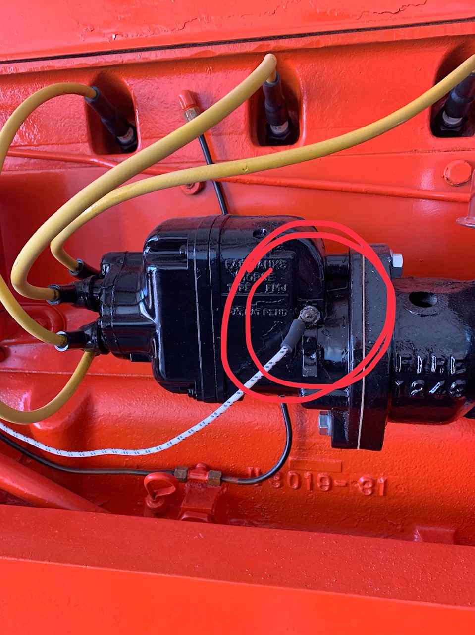

    Posted: 28 Apr 2019 at 5:50pm
Yes, and the other end goes to a normally closed push pull switch at the operators station, in the "control" box.

Post Options Post Options   Thanks (0) Thanks(0)   Quote Ted in NE-OH Quote  Post ReplyReply Direct Link To This Post Posted: 28 Apr 2019 at 5:30pm
Yes , Bingo you got it right

Post Options Post Options   Thanks (0) Thanks(0)   Quote bhaynes Quote  Post ReplyReply Direct Link To This Post Posted: 28 Apr 2019 at 5:09pm
I am at the restore point of installing the new wiring harness. My question for this is the diagram says wire #4 (I think) to "Magneto Ground Switch to Ground". Are they referring to the kill switch on the Magneto? This is how I have it now (see picture), but not sure this is what they are meaning.
I also have the manual, but honestly can't follow that thing for the life of me. If this ISN'T right, then where does this wire hook too? AND. . . . What wire goes to the Magneto "kill switch"? LOL
