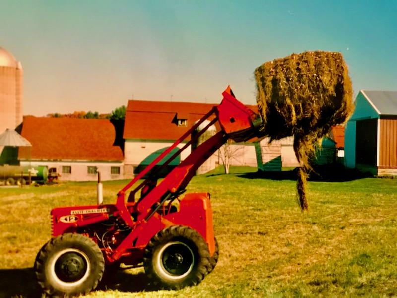

Well its a A/C forum so most like my self like A/C also. Have had my TL-12 since early 90s although it wasnt beat to fk and was maintained, some have gotten abused. Built pretty tuff but if operated not to brake um eeeh. I havnt had to use my Bridgeport or lathe on it as much as newer crap.

That's a great shot of a TL-12 in action.  More often than not you see photos of them painted in industrial yellow rather than Persian orange.

7580/190XT - That's a darn nice photo of what a TL-12 can do! Still very useful after all these years and doing some reasonable chore work. I had a look at the Caterpillar the other day - couple of tires down, has a pretty heavy fiberglass cab on it with forks and about a 4 yard snow bucket.  Certainly too big for the boulders I need to move around.  All the gauges were in very nice shape.  This unit must be a very early one as it has the pony motor along side the D330 in it.  Next visit will be to evaluate the TL-16's.  I see a winter project in the making ~  Orangeman
