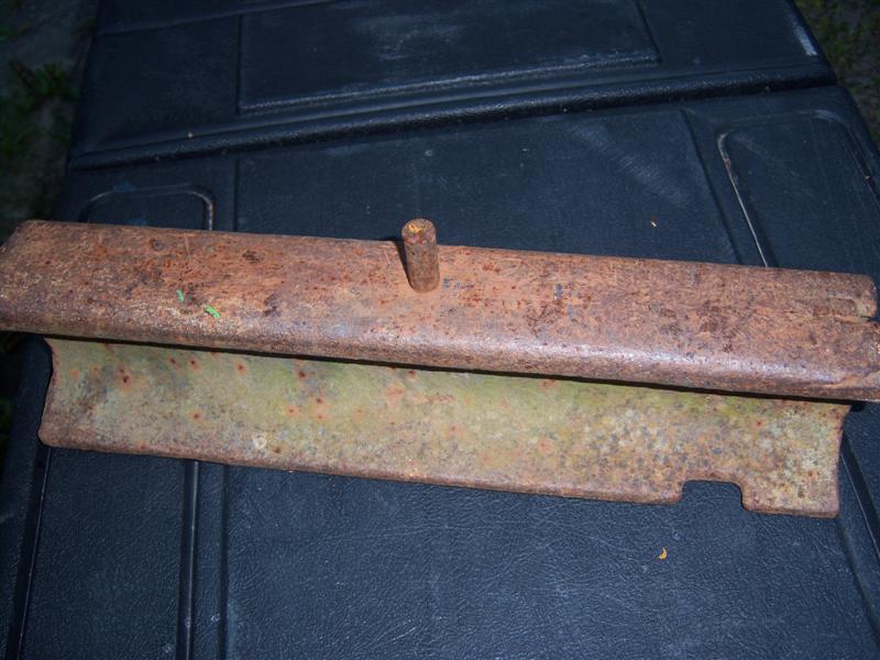

I got the sickle out. I put a 2x8 under the foot and lowered the sickle down and took off the bolk with the fitting to secure the sickle knife onto the cross bar. I had to take a breaker bar with a handle extension to break loose the bolt. I found two sickle sections that need replaced. Tomorrow's project to do some riveting. I do have an old piece of railroad iron to use to help with the riveting.
Edited by allischalmerguy - 16 Jun 2016 at 9:42pm

One of the sickle sections that was loose
Location: Deep River, IA
Points: 2895
Post Options Post Options   Thanks (0) Thanks(0)   Quote allischalmerguy Quote  Post ReplyReply Direct Link To This Post Posted: 16 Jun 2016 at 9:46pm
I used the old screwdriver and hammer to hold up the crossboard drive..
Here you can see the bolt and the bushing (??) that the bolt goes through to hold the sickle to the two wheel drive

There sure are some variations in those knife sections...can't imagine that is good.
That one with the "I" on it looks a little out of place. It may be an optical illusion as the knife next to it is askew. The back sides of all the knife sections should be relatively uniform in order for them to ride smoothly on the wear plate. Incidentally, the wear plate closest to the cross bar appears to be seriously worn and should be replaced. I would guess that "sad" looking knife to the right of the one with the "I" has a sheared rivet and has been moving back and forth for some time.
Allis-Chalmers must approve of sharpening the knives as they stipulate that the angle and bevel must be maintained when grinding. If it were me I would replace any badly worn or misfitting knives including the "I" knife and the one next to it.
Getting all things lined up and fitting properly will result in a clean cutting mower.

Wear plates are available from Webb's Sickle Service but they are the short ones.
Allis mowers were equipped with long wear plates originally.
Using as many of the short ones as will fit should work.
If that bolt in the bushing is original and the threads are not worn, you should have no problem.
It appears that the knife with the "I" sticks out on the back side more than the others....might be an optical illusion? The left rivet on the knife to the left of it most assuredly is sheared and allowing the knife to move. That is why it is "out of line". Being as worn as that knife is, it no longer fits snugly against the other knife which puts even more strain on the rivets of both knives.
