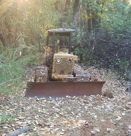

Hello there I just acquired a allis Chalmers HD6B it need some parts and repair I am trying to find out as much about it as I can as in year. Can anyone offer me any resources the sn# is HD6B-17873. Thank you in advance.

1964 Post a picture

Steven, post some more pictures. Get up close and personal with that tractor. There's lots of help here with more pictures. We have a lot of those parts in our "DONOR TRACTOR" section. We're within driving distance.

The tree that grew up behind it does not help. I would remove the blade. See if it has the optional hook in front of the rock guard. You will have to gain better access to work on freeing the right track. How far did you move it to discover the right track was not moving?
