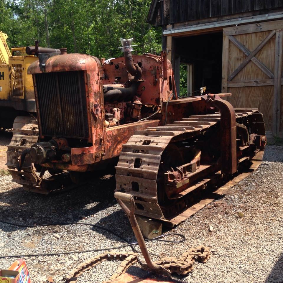

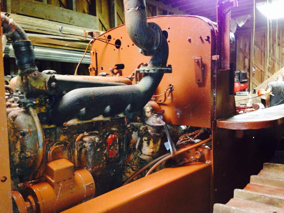

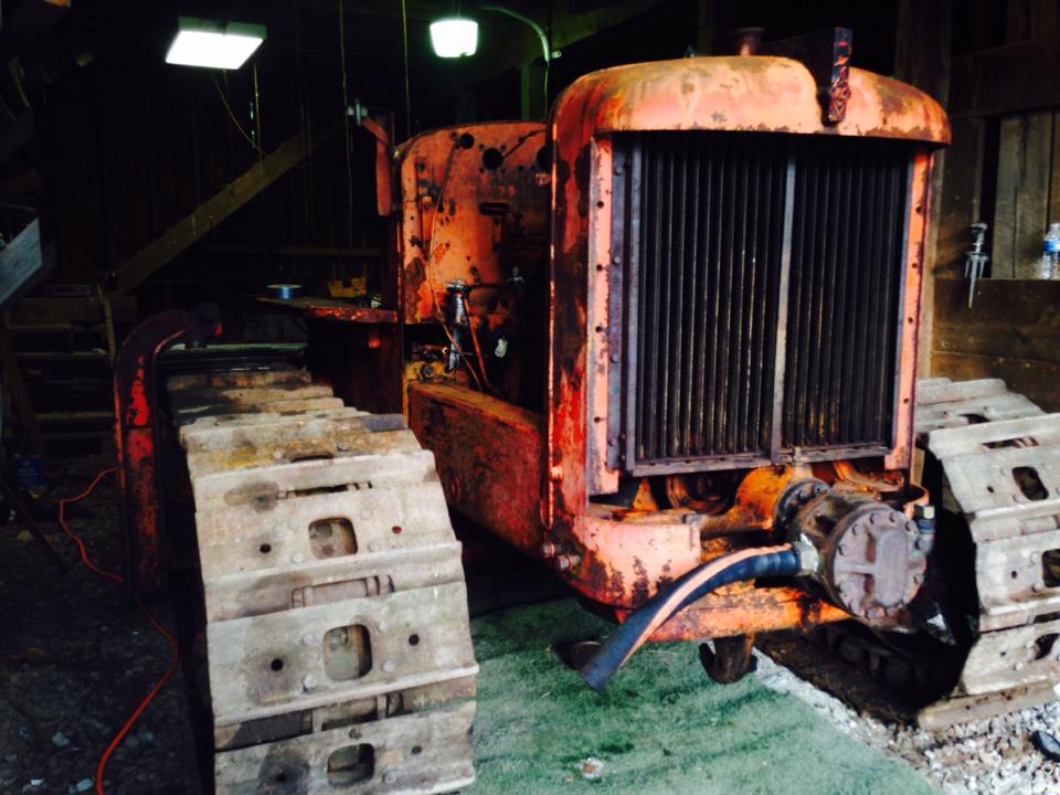

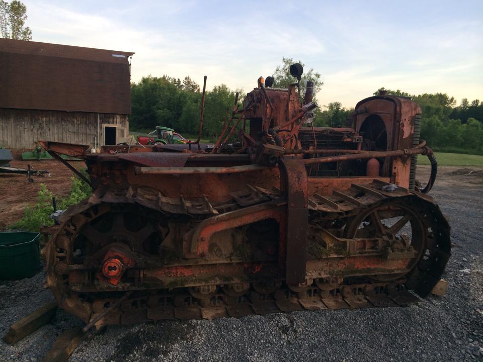

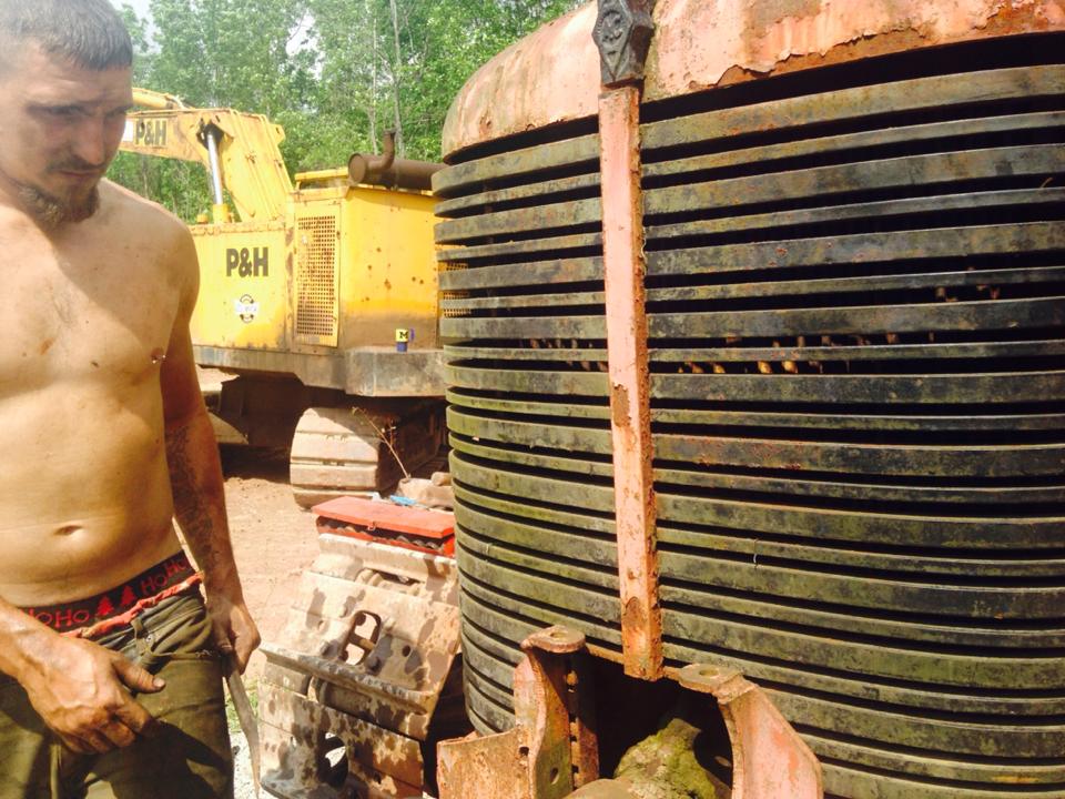

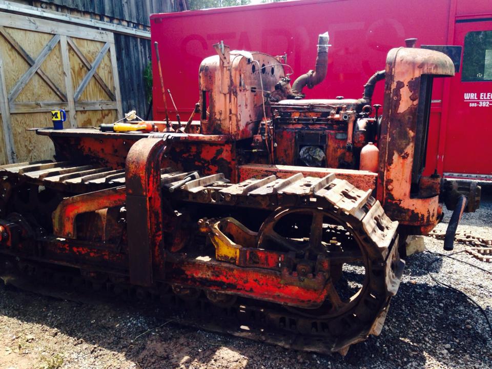

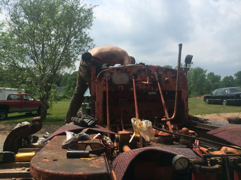

  Hey guys I'm new to the forum and I'm glad this is here for the help. I understand Most everything and how it is "suppose" to work but that's not the case here.  The Crawler was my dads and it ran when it was parked but that was 30 years ago. He wants to scrap it and I said no I'm gonna restore it so If I don't fix it he gets his way.  I pulled the dozer out 2 days ago and started to take stuff apart clean and look everything over.  The engine is seized from sitting, I hooked 2 brand new battery's and wires to it and I get the hard click from the starter and the cooling fan does a very short twitch. Lifters do not move whatsoever. so I believe the crank if free and the pistons are seized from sitting.  I took out all 4 injectors out and put a bit of diesel fuel in each cylinder to sit over night and I'm gonna try again tomorrow. I also drained all the oil and there was some water in there that had frozen and cracked my pan I'm going to weld that up tomorrow but at least there was still oil above the water. btw it has the Detroit 4-71 motor. My biggest problem that I need some help on would be that it has been out of gear for all that time and now none of them will engage. The Direct and Indirect lever works and also the rear clutch levers feel like they are working properly. The Gear selector and the master clutch will not engage in any position.  I cant tell how I would get in there to free them up but I'm thinking its gonna be a pita from what I can see.  I have the floor pan off now and the opening to the master clutch. I have also greased every fitting I could find, even the one by the master.  Any help would be greatly appreciated as I can find hardly any info on these old dozers. Thank you for any help in advance.

Real TL, I like the looks of the early HD series, and yours has a near purfect grill from what I see.
You may want to take the starter off, so as to pry on the teeth to back it up and forward...Go to http://kingofobsolete.ca./  and look for the thread there about making a starter replacement that you bolt in, in place of the electric and then you use a big bar on that to start wiggling a stuck engine loose.
 "Pouring some diesel in"...You know every enjector has to be reset for the engine to run right, right?  but... while injectors are out, did you stick a wire down to see if any water was in the cylinders?...
 Remember that the intake valves are the ports in the lower cylinder... maybe you should check out the blower to see if that is froze, rusted up or full of acorns or whatever... that has to spin freely.
 Did it still have antifrizz in the radiator, and up to full mark?
 Was the can on the exhaust without holes in it?
Take the airbox covers off and take a good look at the ports in the cylinders. You will get a better idea of what your in for maybe.
 There are some very knowledgeable fellows on the board here so be patient, somebody will come along and have better info. In the meantime, just gotta keep asking questions and putting up pictures. LOL

haha yea, had no clue about the injectors having to be reset but I figured they probably were not in working order anymore.  I looked in with a flash light and they were dry before i put some fuel in there. Then I could get a shine from the fluid sitting in there.  Now that you say the blower my dad decided to mention somthing about a cracked lobe but he said it was running so who knows I'm kinda blind on this haha. So I have to check that out tomorrow too. Will that being froze up cause it not to turn over also? And the exhaust was modified at some point but it has no holes and still had a good flipper on the top that was closed.  I'm not sure what you mean about the air box covers, that may have been modified also,  Thanks for the response

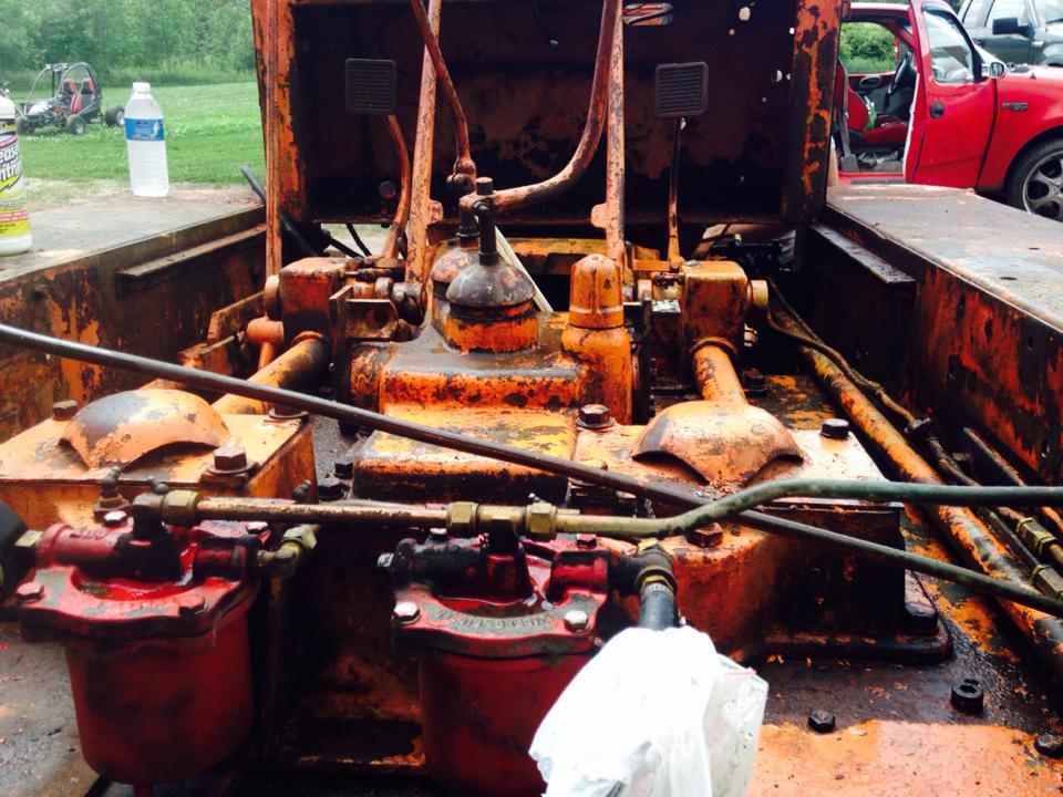

yea I don't know much about what is going on with blower but that's coming off today and I'm going to find out whats going on, I will replace it if I have too, I'm more concerned with the shifting problem right now because if I can't get it in any gear or fix that problem then this project is a wash.  The motor is easy to access and parts are available for that.  Thanks for the help guys, I'll post some pictures later.

just got the blower off and it turns over fine, so I found the motors culprit. :)

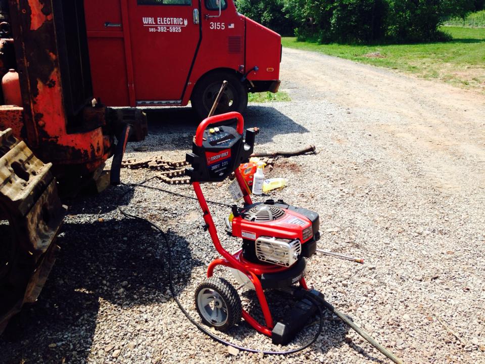

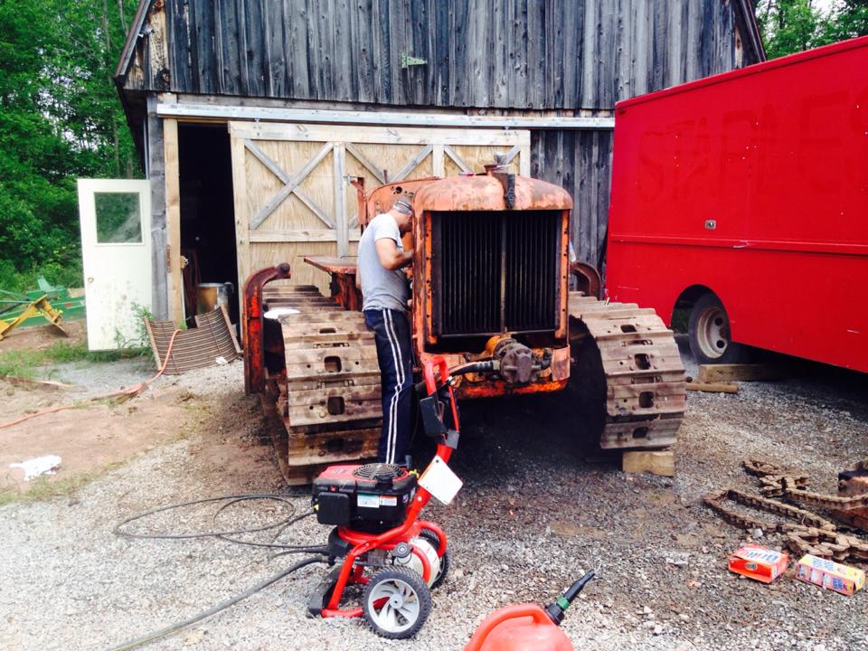

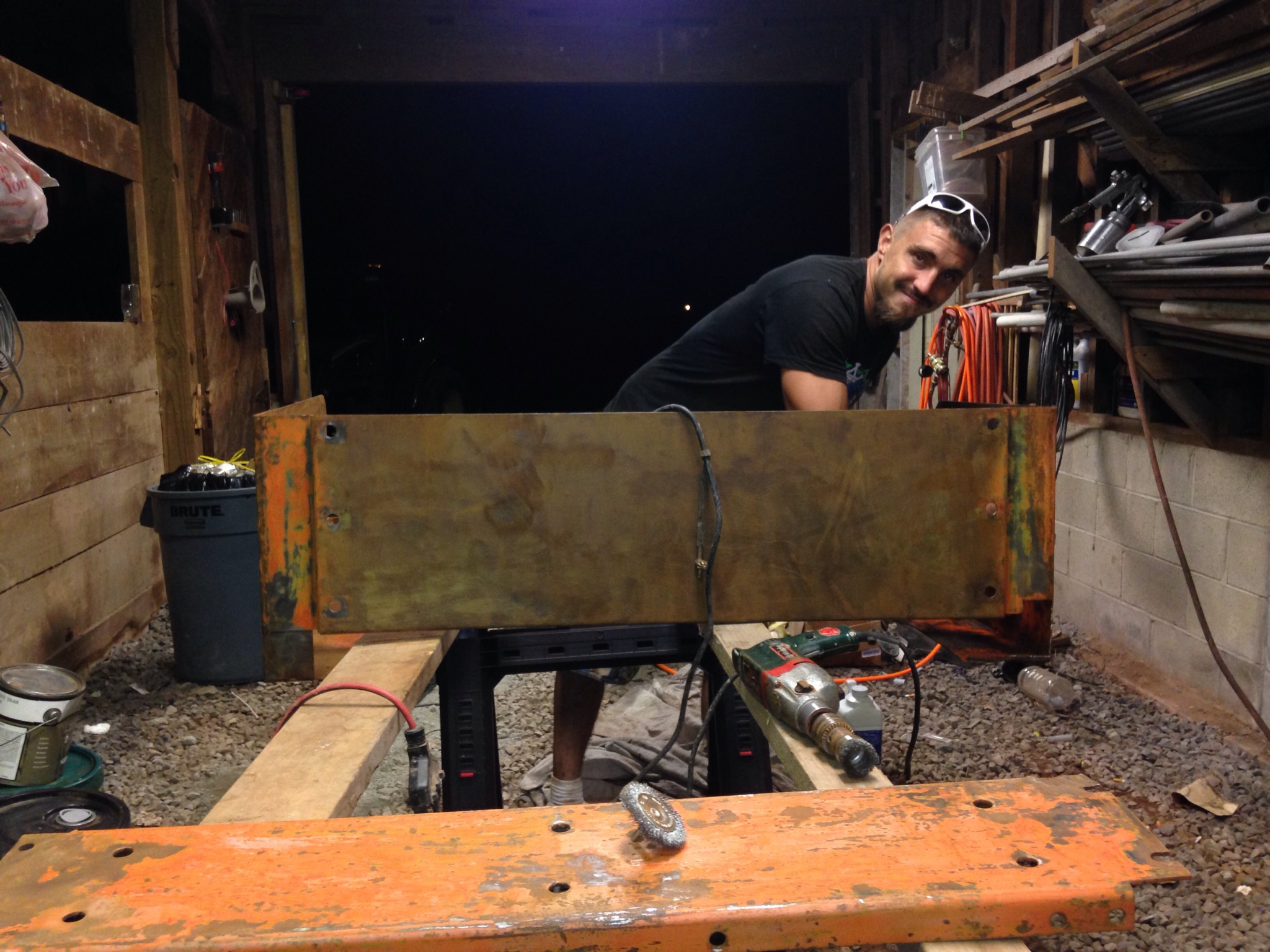

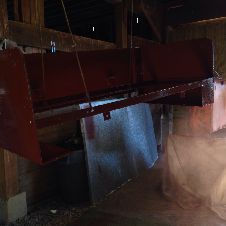

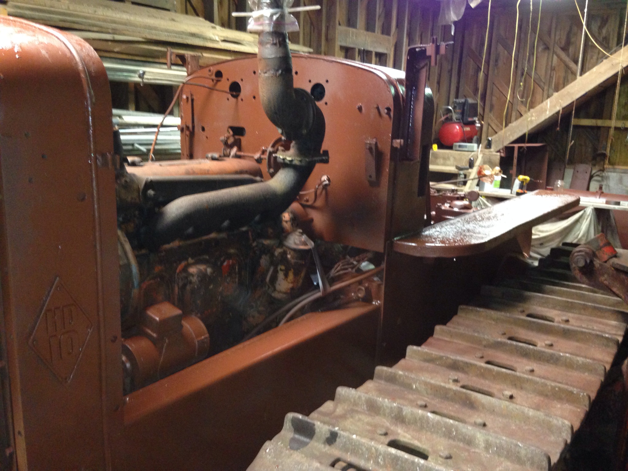

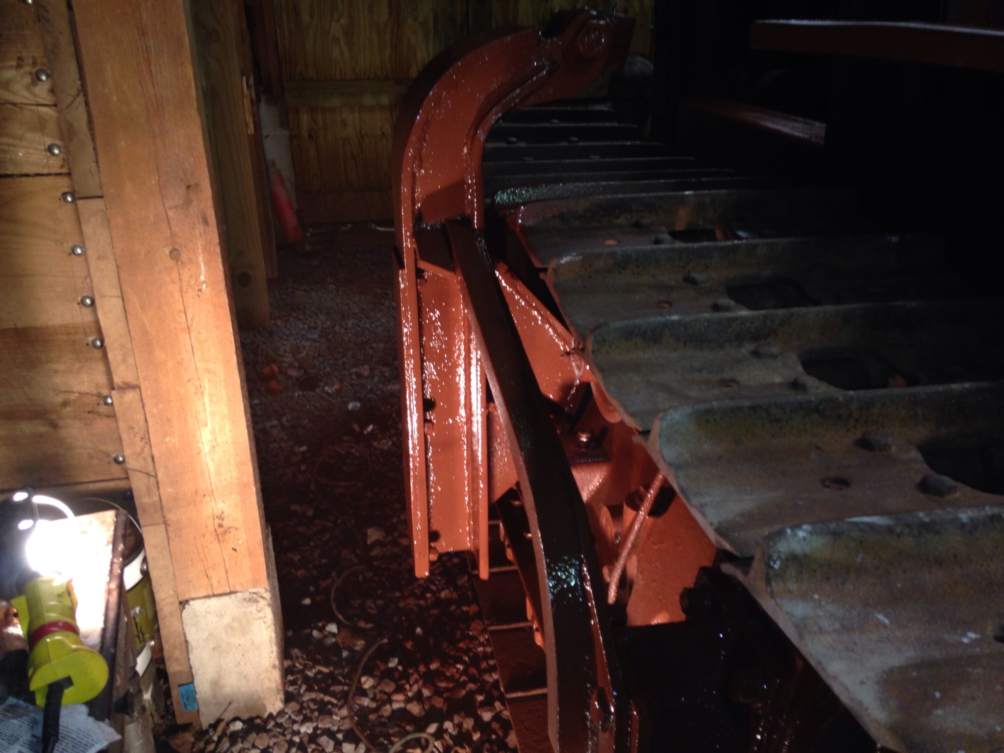

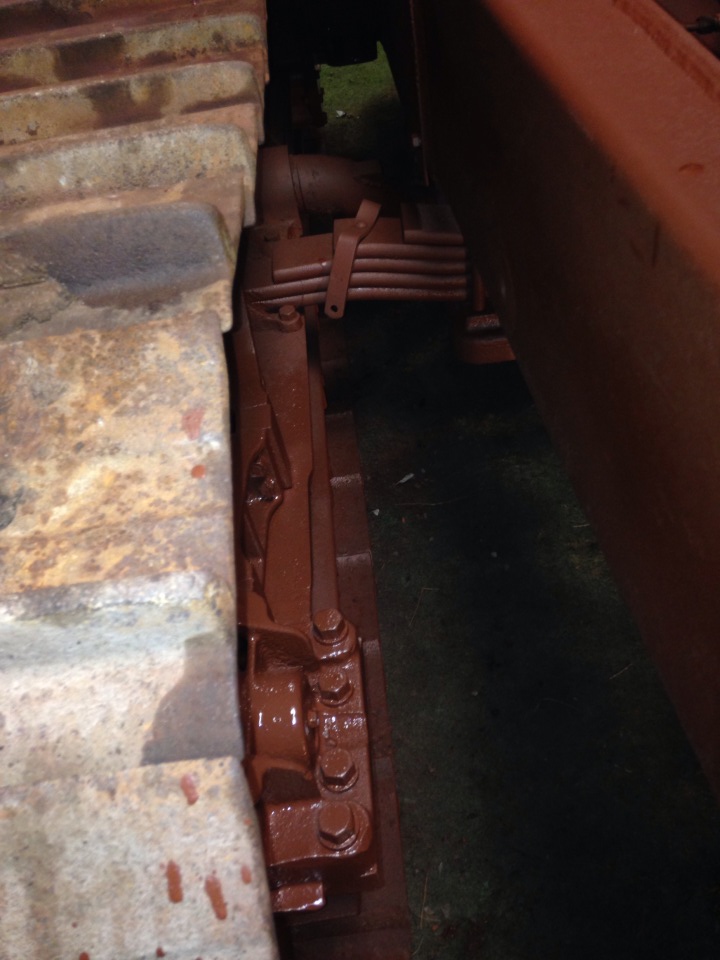

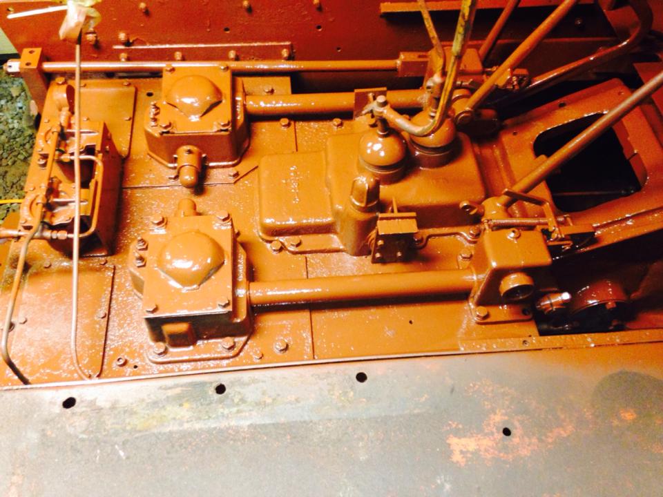

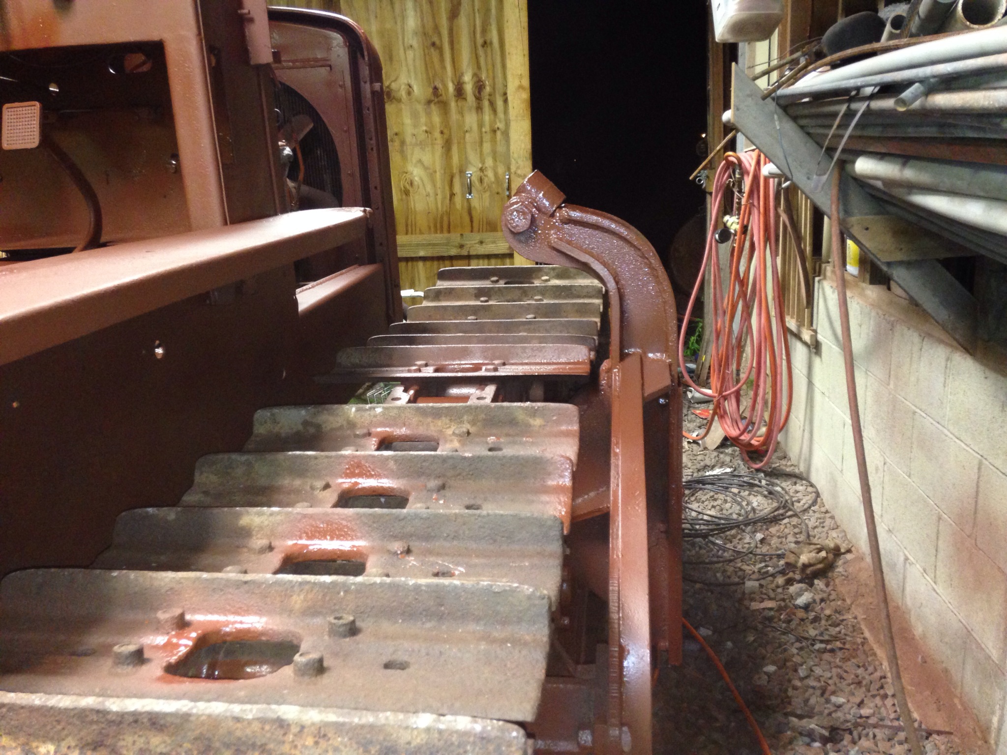

Some painting of the parts, Rebuilt blower is ordered and on the way also.

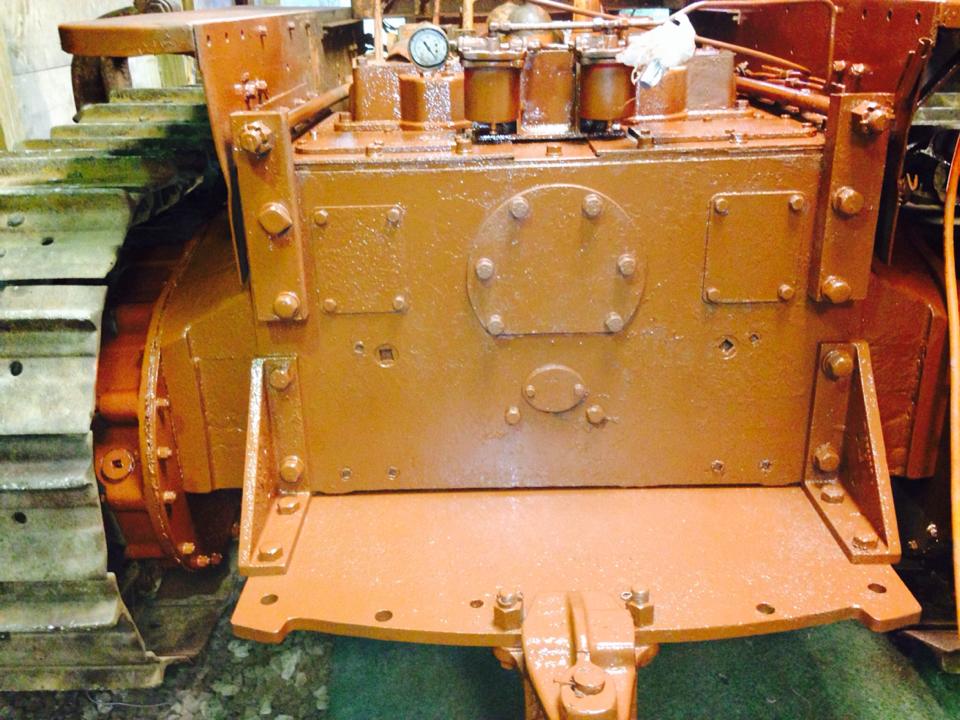

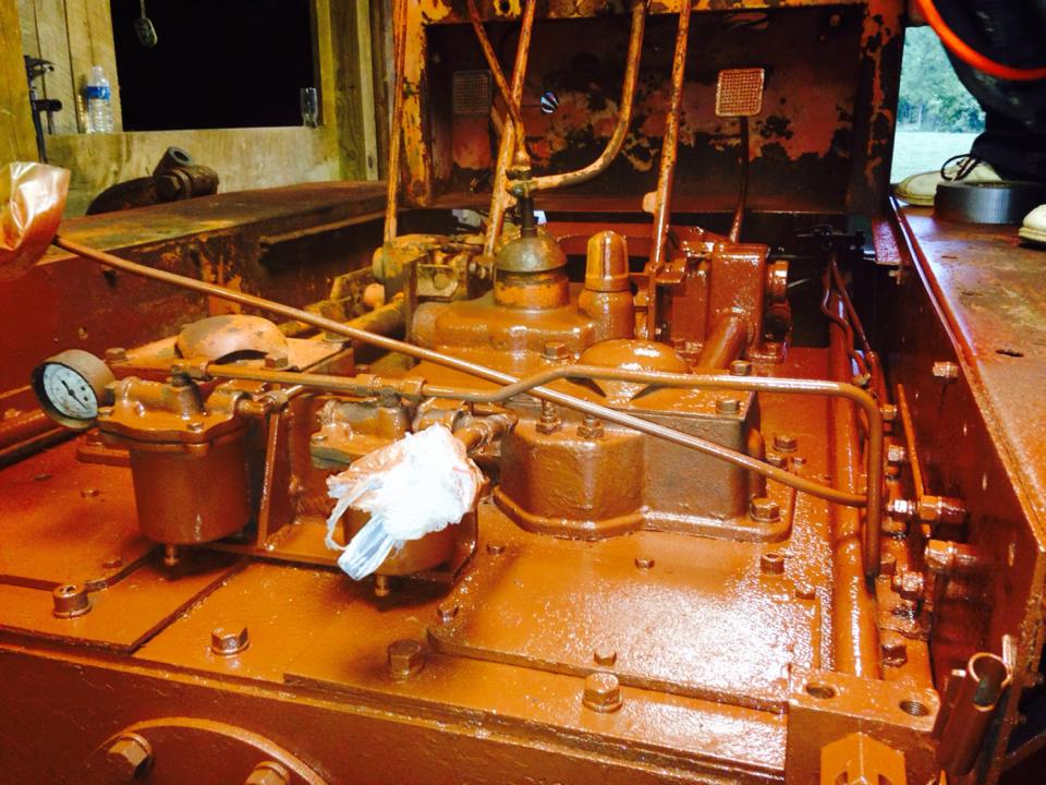

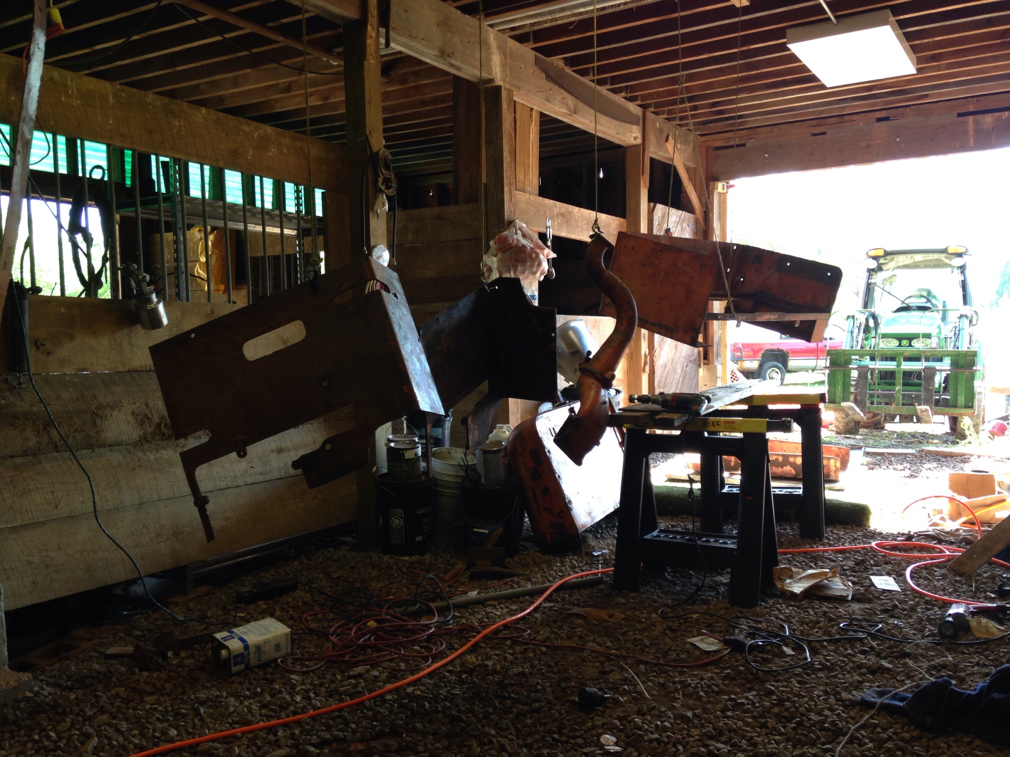

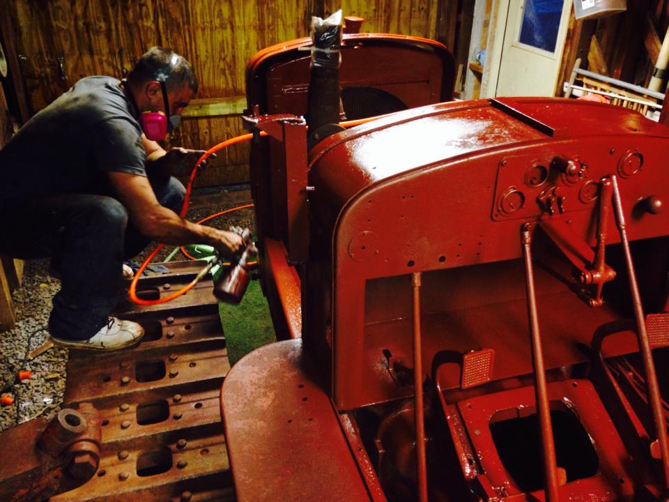

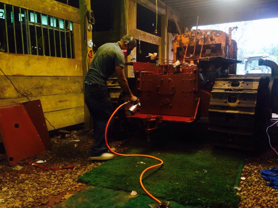

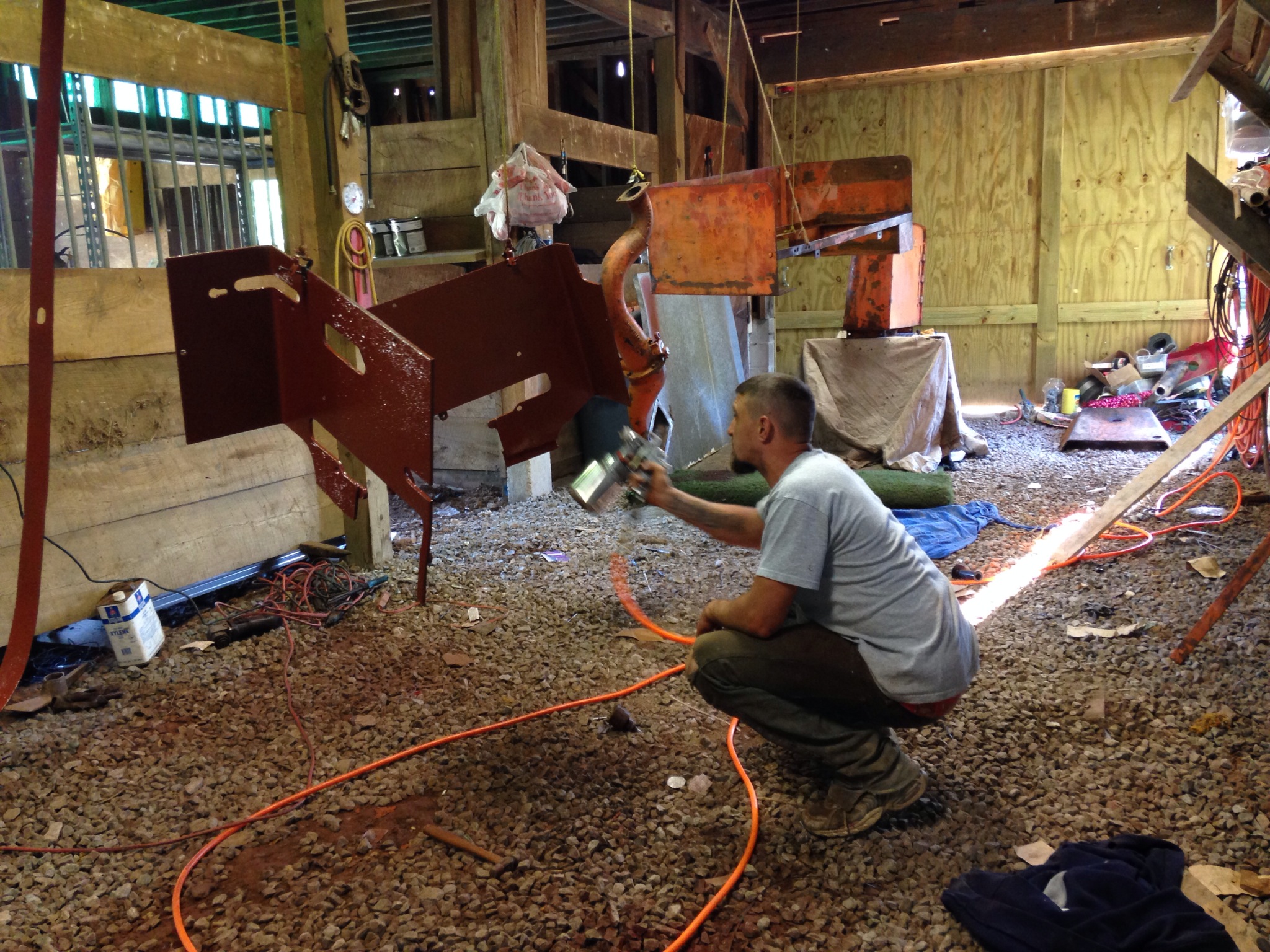

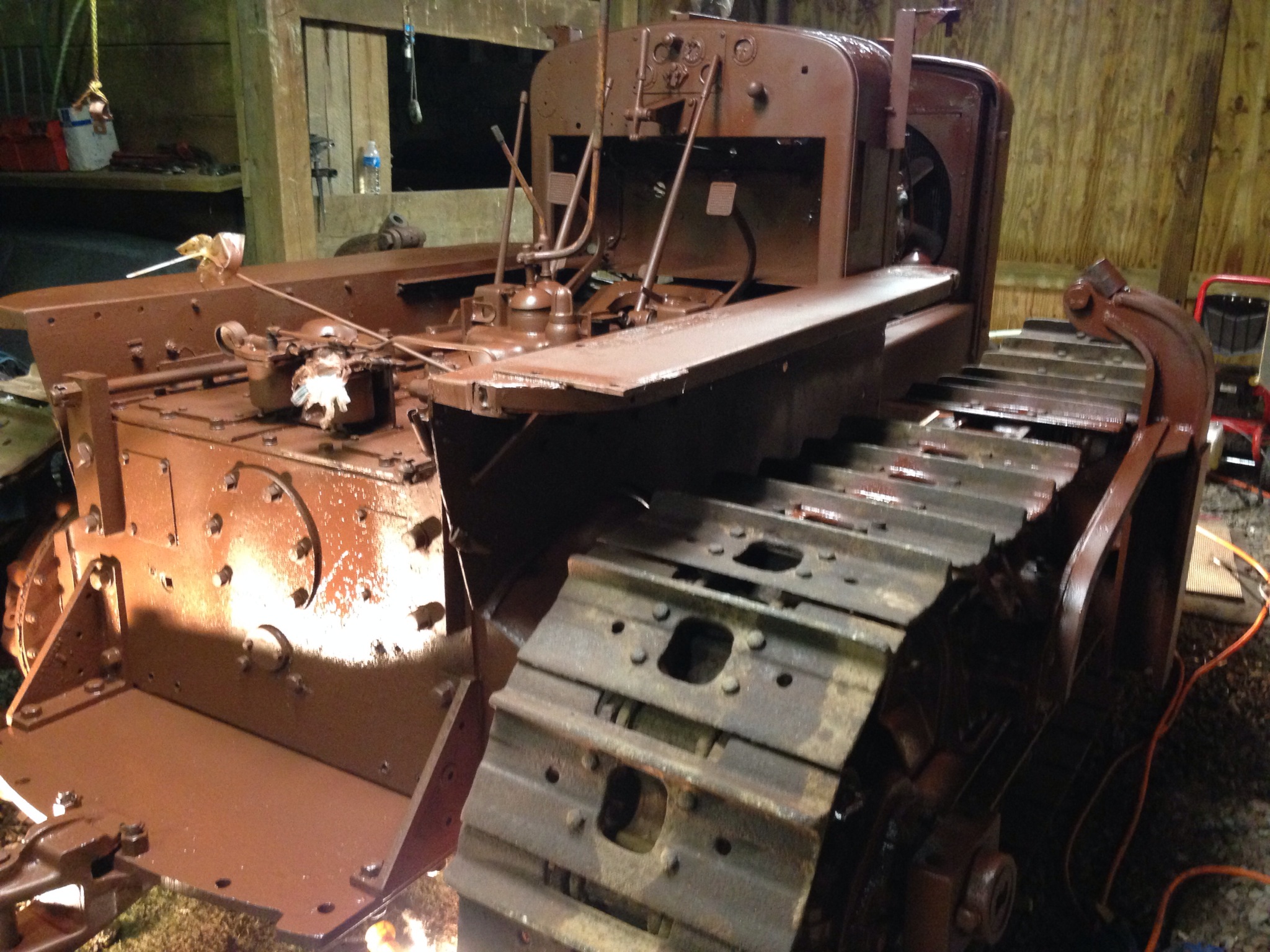

Primer Coat sprayed today, Tyna is down under getting paint in her hair LOL, actually tynas mom lives in perry ny so we go out there quite often. I am looking for a few things, I'm looking for an original hood and intake someone has rigged up one that I don't like too much and the hood is trashed with holes now, E mail me and we can get in touch sometime Hiltonghost@yahoo.com, Here are some pics from today.

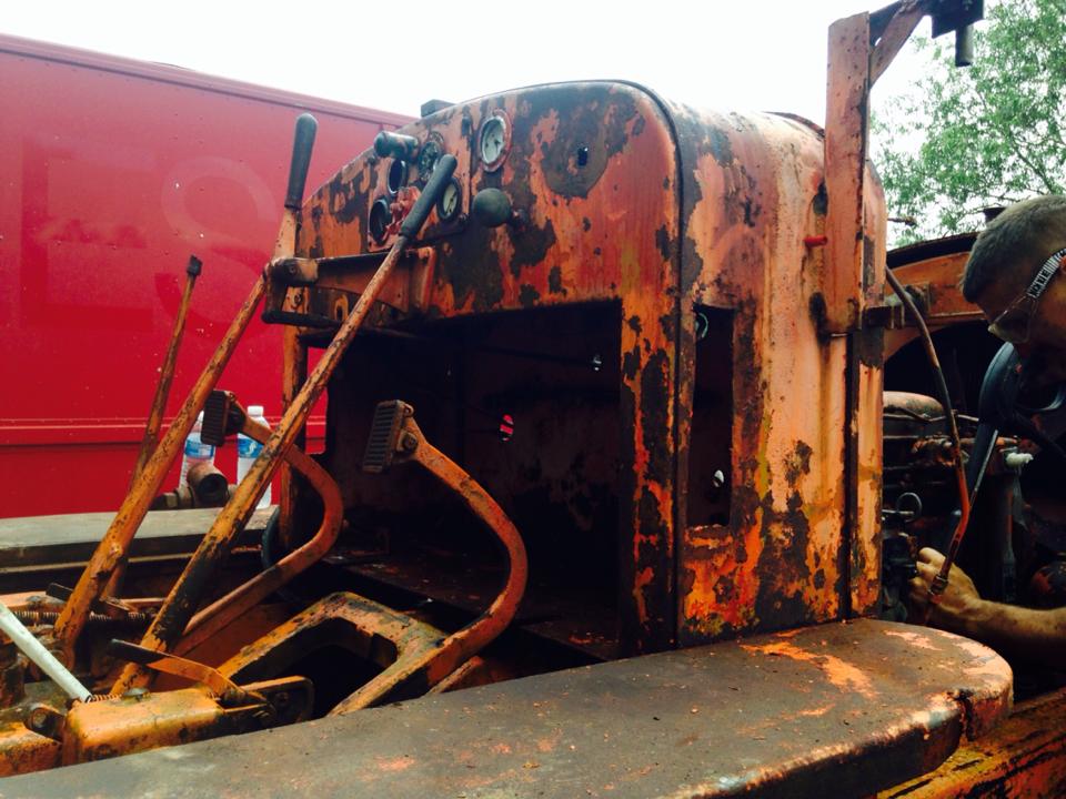

Didn't do much on it today, Mainly got the gauge cluster off to clean up and ordered all new gauges for it so hopefully I will be able to get her fired up this weekend to see if she will run. That's if the blower gets delivered by then. I think tomorrow were gonna pull it out and scrape the bad spots we see on the primer coat then re coat and hit the missed spots from the track position. I mainly wanted the bare metal spots primed so the rust didn't get worse. We still have to make a seat for it. I've saved some decent couch cushions I can use the foam out of and might go with boat seat fabric for that. I will probably end up doing that last tho.

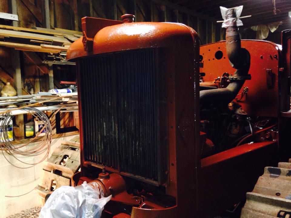

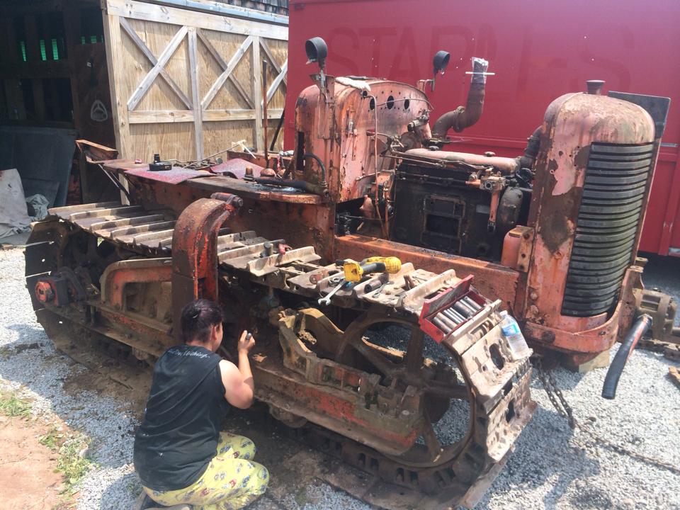

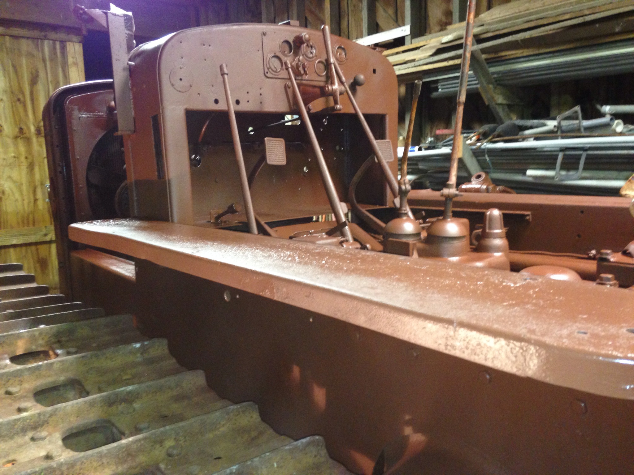

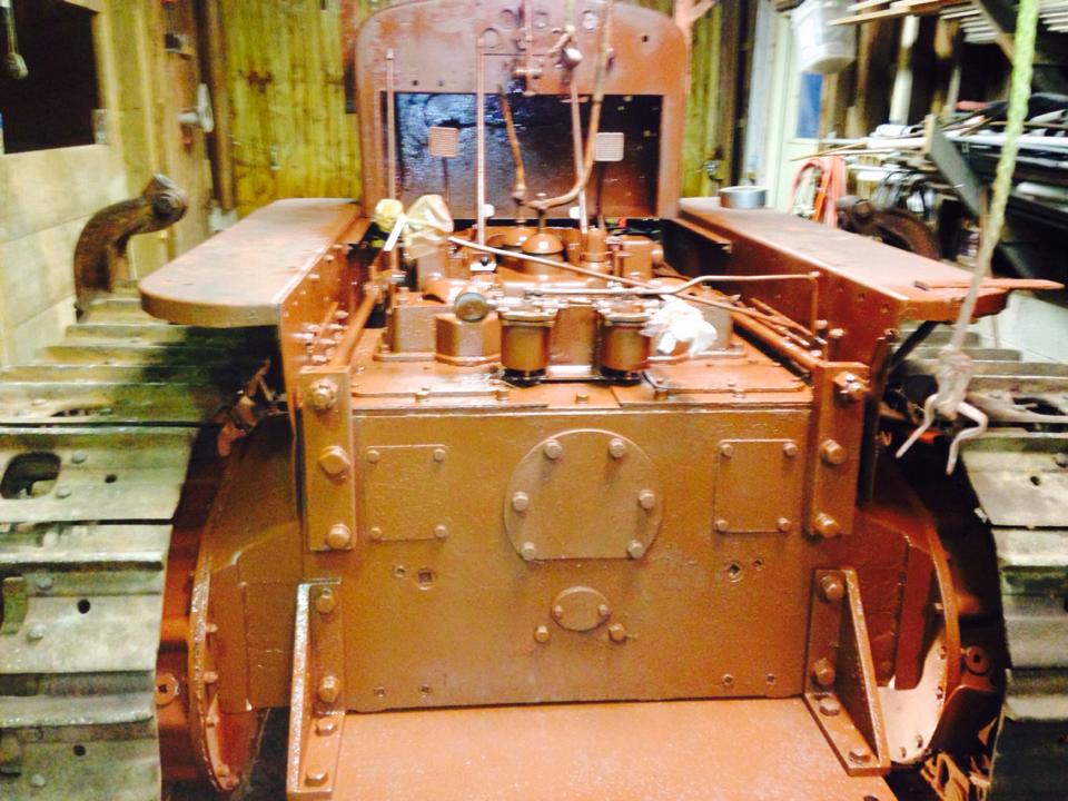

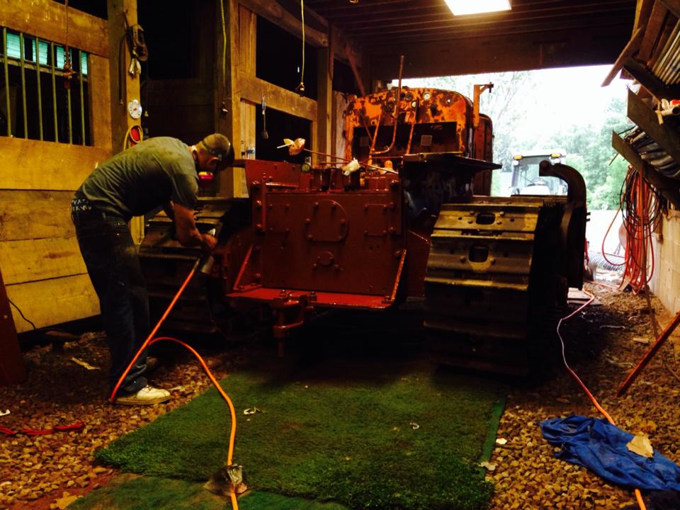

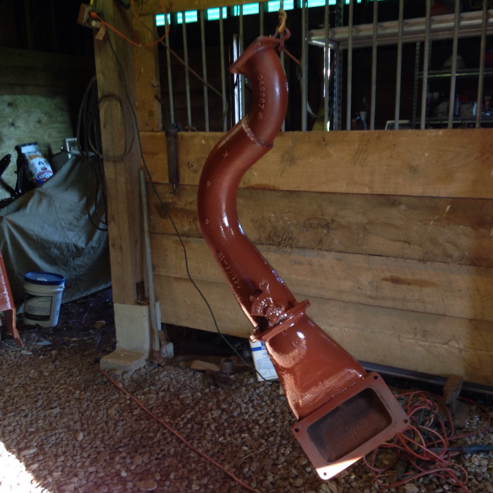

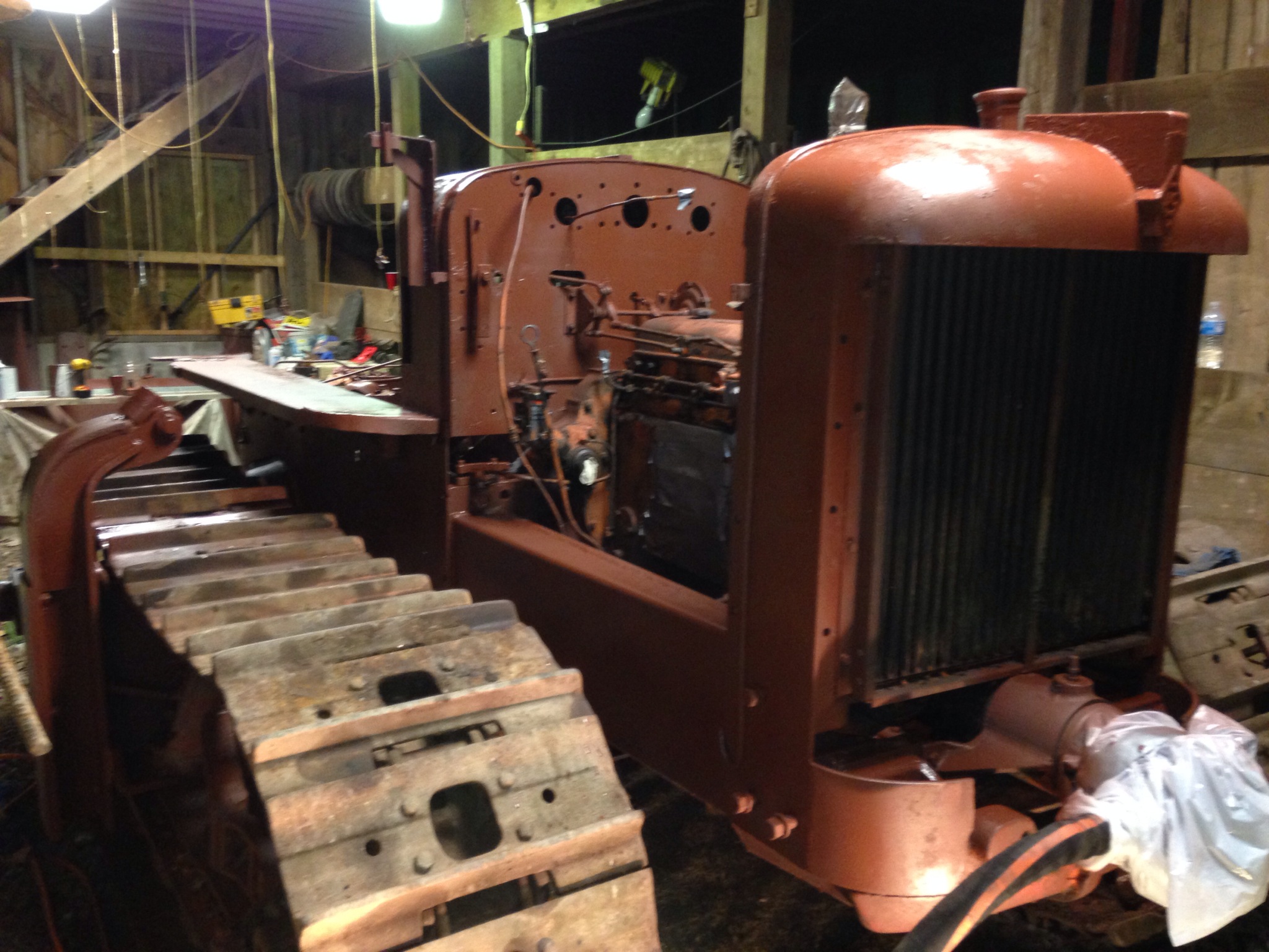

Well just an update, We got her back together, gauges installed, New blower on and she moves on the rear steering clutches but I still need to get that master clutch free, Been spraying the cams and parts with a lot of wd40 hoping it will eventually come loose, should I heat it up and spray it? It is stuck locked in the open position i believe. I will post some more pics and a vid tomorrow night if all goes well.
