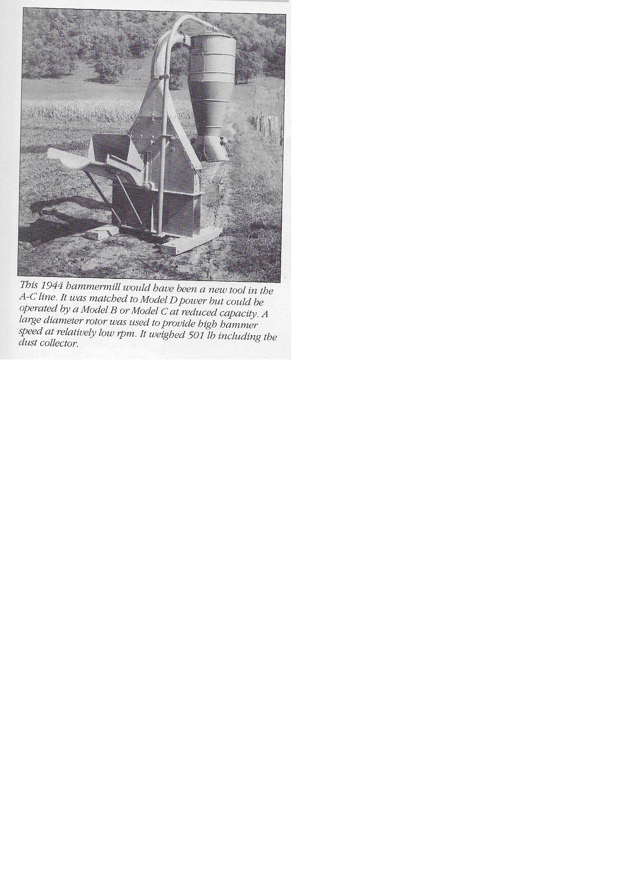

At the Cascade auction this past Saturday, I purchased what I think is an AC hammer mill for $30.00 (there was two of them) but I am not sure it is exactly that.  In the picture below (taken by IBWD Mike) it is the cone shape object above the C sickle mower.  Does anybody have any information on them?  It is PTO driven, wheeled frame with a tray that slopes down to something that looks like a silo blower, then goes up a short chute to the cone shaped object then I think cracked corn is bagged from there.

I don't think Allis made many hammermills. Only thing close to Allis I can think of are the rare GleaCo grinders, but I think they were belt driven, not PTO. (In Swinford's book) If that's what this is, it's pretty rare. I've never seen one, and I think they only made a few hundred. They were designed to be ran by a WC, but could be ran by a B or C at reduced capacity.
Yours might be a Case?
That cone thing is called a dust collector, by the way, or that's what we've always called it. The part that looks like a blower...well that's part right. There's a big "cylinder"-like object that grinds up the grain until it falls through a grate with certain size holes. Once it goes through the holes (at least on mine) it is augered into a fan, which blows it up the stack and into the dust collector. One of mine is rather short and has a bagging attachment on the bottom, the other is taller and designed to fill a truck. Yours is not designed for bagging, it's too tall and lacks the bagging attachment on the bottom. It's just 2 chutes with a lever to switch which shoot the ground feed goes into.
As far as the sloped tray, that's where the grain goes in. On mine, there's a slide door that you can set to regulate how much goes in.
I have two belt driven F&H hammermills, but I can't find any information on them.
If you could get some better pics, that would be great! Including one of the serial number tag, if it has one.

Does it have any markings on it?  AC probably made hammer mills.  I know JD and IH both did.  Back when I was a kid we had one made by Fairbanks Morse that ran off the belt pulley on the tractor.

It does have the older diamond shape AC sticker but that may have been added later.  The galvanized dust collector looks like it was painted orange a long time ago.  Thanks for all the research Creston...I'll take a few close up pictures real soon.

Looks to me like a Wetmore hammer mill

Looks like MichaelV from NM solved my hammer mill mystery.  It appears to be a Wetmore hammer mill from Tonkawa, OK which sold out to United Farm Tools in the 1960's which then was bought out by AGCO so I guess that makes it a distant cousin to Allis Chalmers.
Thanks for all the help.
This is one similar to mine.

That cone shaped object is a dust collector, for collecting the fine powder, and adding it back into the cracked corn...
