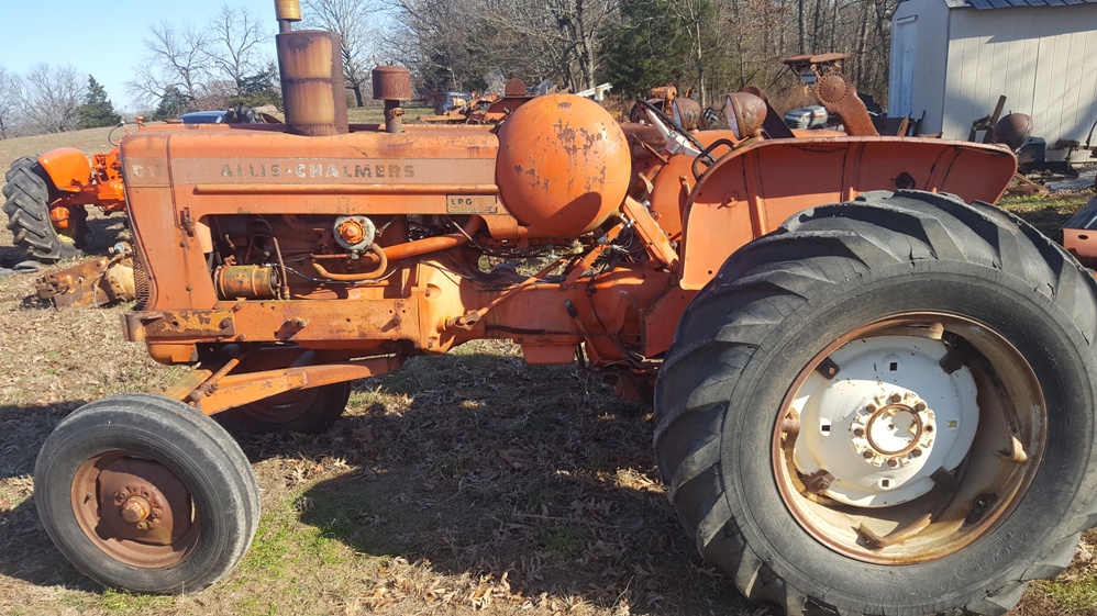

Guys,
Looking into converting the D17 to Propane...Mount a tank, put on the hardware.
Looking at this:
I see the carb there, but on the other two...one is a fuel regulator, what is the other piece?
the vacuum shut off?
Any thoughts?
Tom

Ok sort of found the answer,
One is the pressure regulator, the other a converter.  Convert the liquid to gas...
Where does the vacuum shut off come into play?  I understand there is the electric type and vacuum..
Tom

Ya I will be fine..
Doing more studying...so that converter...is a Century C-J...takes coolant to heat the liquid propane to turn it into gas....Now my understanding is a tank like a 20 pounder will be 20% gas, rest liquid.  When we use it for the grill for instance, we don't need to heat the liquid.  I take it that is because the liquid is becoming gas faster than it is being used. On the tractor, I'm thinking we could hit the liquid portion faster than it can turn to gas inside the tank-requiring the heating.
Am I getting this right?

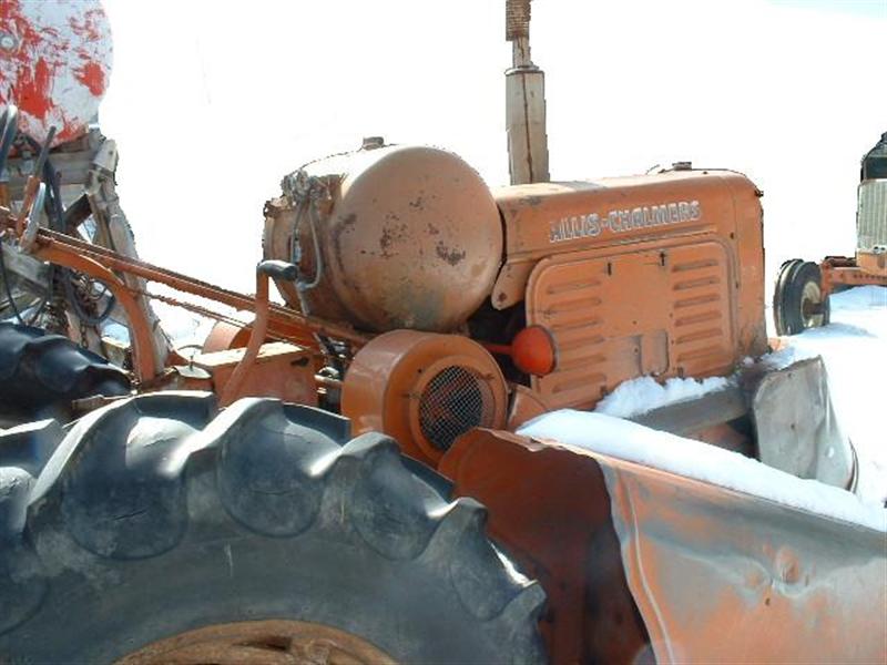

Gerald, the JD set their tank on end and mad for less vaporization unlike IH and oliver running long tanks horizontal. and over the engine made for more heat to vaporize too. The propane tank on this WD was on vapor since about 1961, even when plowing, You could turn the liquid on and shut the vapor off and made no difference. at least that was our experience... until you hit that 10% mark then it did. Many times we came home in the summer with the needle hanging straight down, that was different becuse it was hot out.
 There was a fellow in the community that had a 190XT LPgas... and in the winter he fought with it all the time trying to start it. Even with a torpedo heater under it. Tried to tell him to shut the valves off till it died and then turn the switch off and then when starting it, turn just the vapor on and hit the switch and let it warm up before turning the liquid on and shutting the vapor valve off... but he said he shouldn't have to do that.  Was the sweetist running XT I ever heard idling or working., but he decided it had to be turned into a diesel, and a few years later, it looked like it had been through a war, beat to death.

Interesting stuff fellas...
So I guess that Century CJ converter will ensure I was always running vapor....
Here is a guy that VERY crudely converted to vapor.....not sure I would have any open flame around that connection to the air cleaner.
