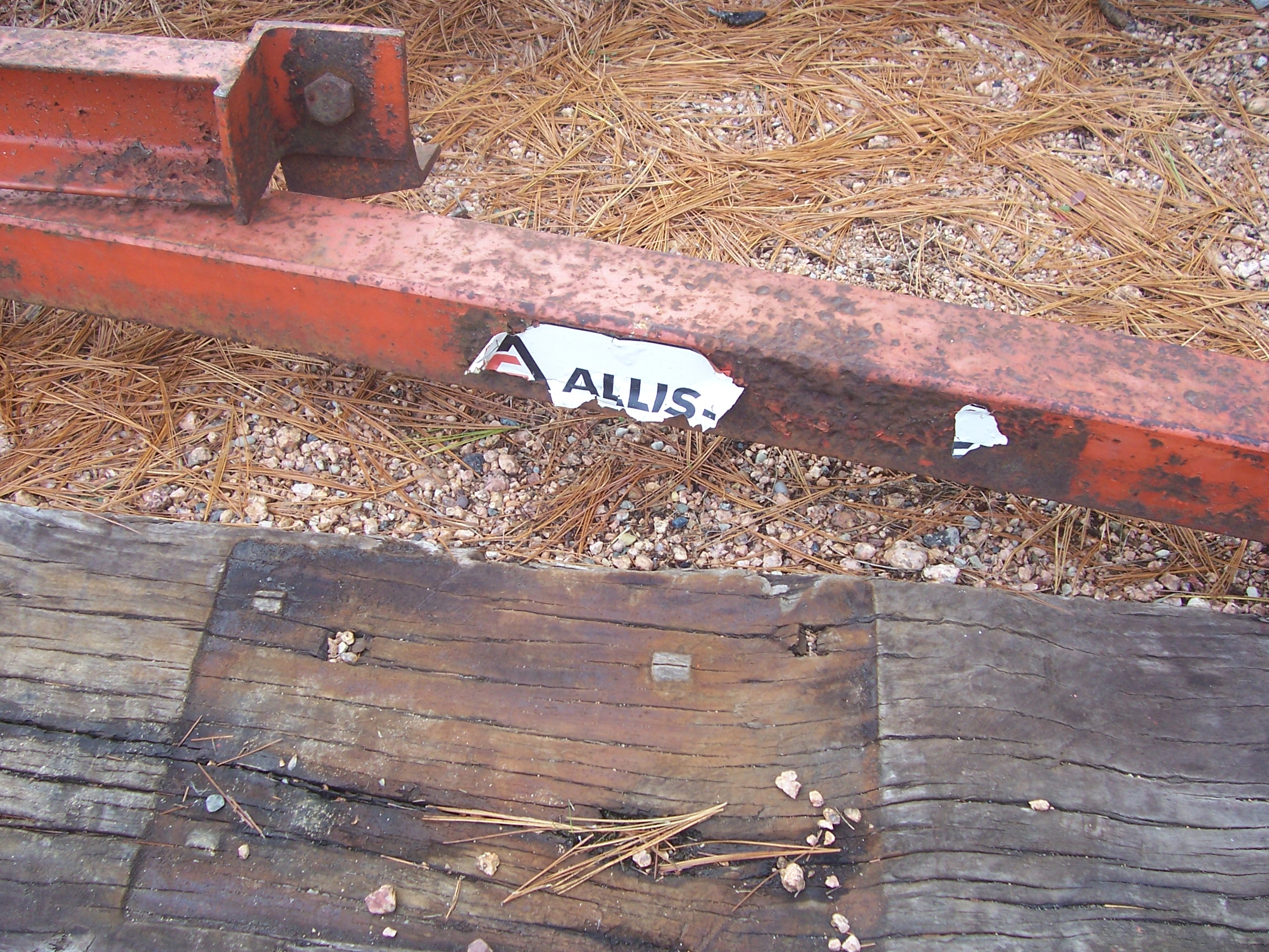

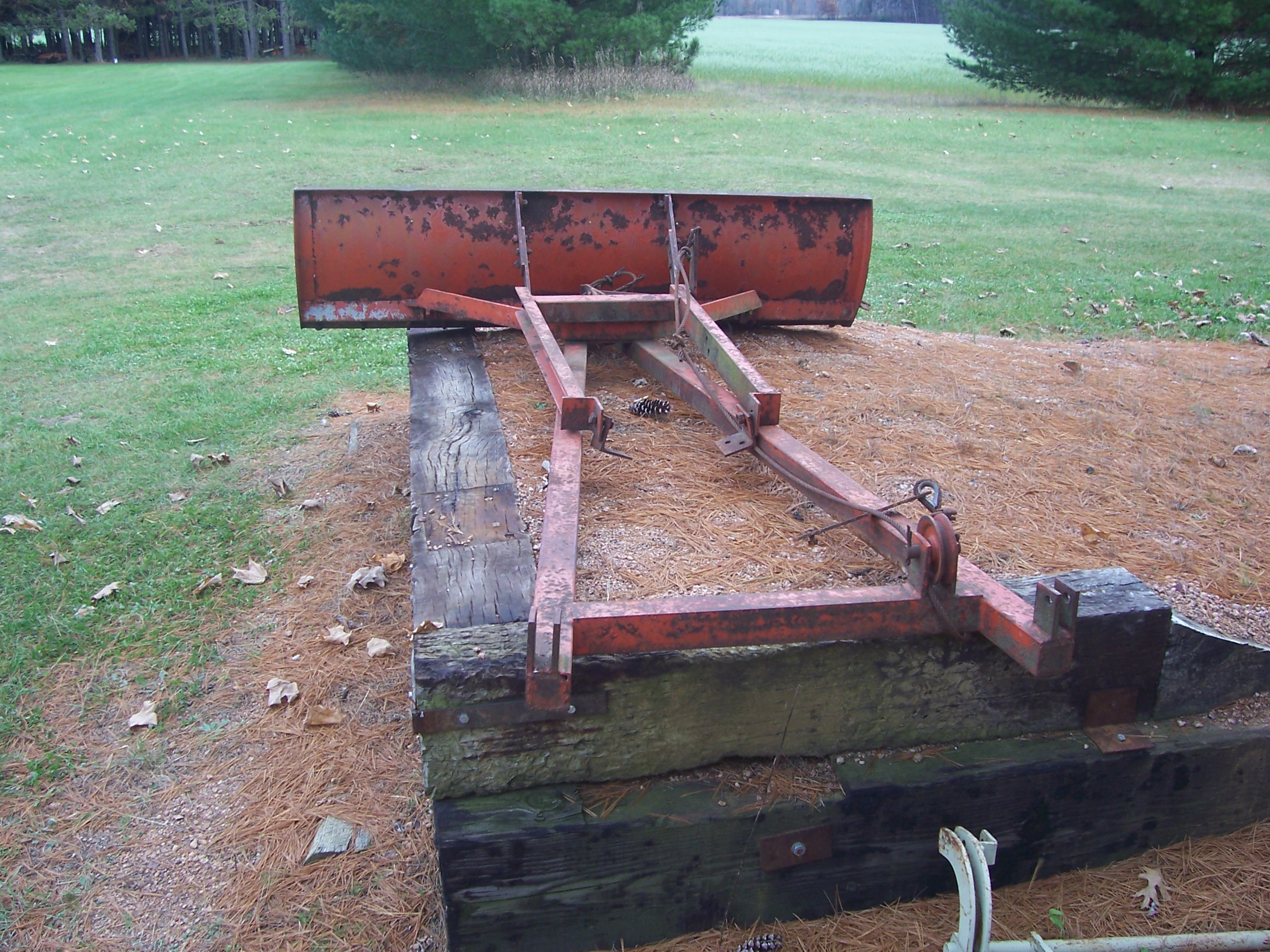

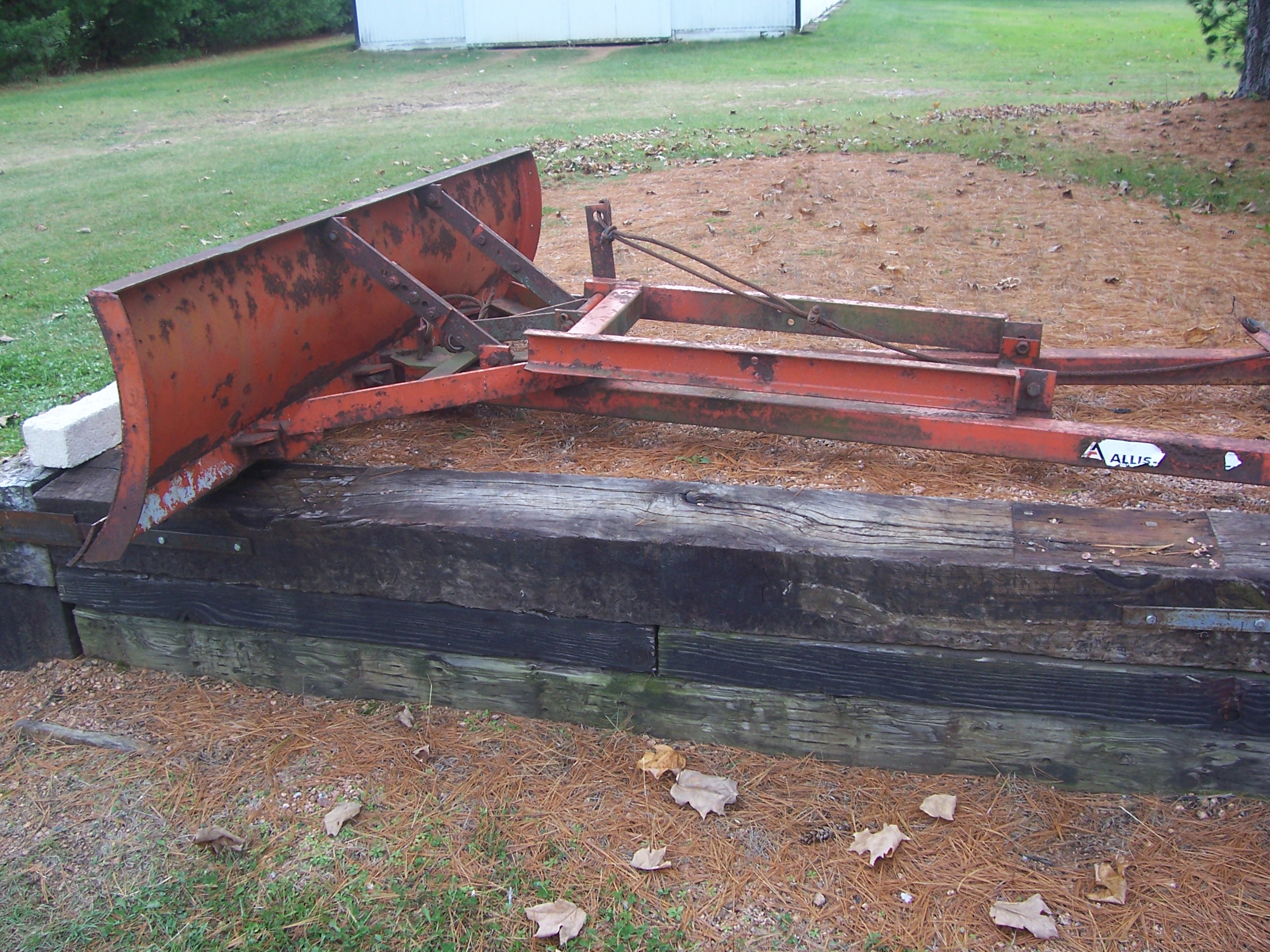

Does anyone know what tractor this AC blade fits Thank you

I would check the dimension between the very rear two pin mounts...how wide is the blade ?  looks like it could fit a B or C.

It's not an Allis Chalmers blade.  They never made front mounted blades (no mention or pictures in any books).  To me, it looks home made with a coat of orange paint and a new style sticker to match.  Someone did do a nice job on it though.

I would agree with D Series4. Looks like it was a Ford to start with.    MACK

I think it is for sure something Allis Chalmers. I hope somebody can tell what it is. Thanks.

To me, if you compare the structure of this blade to any piece of equipment made 'by' or 'for' Allis Chalmers, you soon realize this blade is a 'home made' fabrication.
Most of the blade is made from standard 'off the rack' steel ( angle, channel, square tube etc.)
I believe Allis only supplied 2 front mounted blades, both for 'front end loaders'
One style of blade fit all 'trip bucket' loaders.
The other style fit all 400 and 500 series Hydraulic Bucket Loaders.
These are illustrated in Allis Loader Parts Catalog.

I agree with the 'homemade' idea...
ANYONE whose used a snow blade KNOWS why there are heavy duty springs on the blade !!! Also there aren't any 'shoes' under the blade.
looks real heavy.. my back hurts just LOOKING at it....

It has its own mounting. I was told it had been purchased with a tractor new. Ac tractor from dealer but did not know the model. Thank you.

It is also designed to angle left to right.

the blade and the pivot part looks like the blade for my 101.   it  is al constructed from common steel shapes , so is the one for my 616 ,   maybe who  ever biult the implements for simplicity biult these ?     be neet to see some littiture.

Eit fits a C allischalmers. The two loose angle brackets bolt to the front cultivator mounts a b dosent have them. The back of the lift frame should bolt to the holes in the bel housing make sure you use bolts less than3/4" long or you lock up the flywheel. The back of the push arms should pin to the plow drop brackets. Or homemade brackets if that's what you have. That little arm with the cable attached goes on the rock shaft where the plow would normaly mount. I've made three of them each with minor differences. None of the ones I made had springs you don't even want springs on it as a tractor it dosent go fast enough for the blade to suck down before it pivots and dumps the load. I put a 5' length of rail road track on the frame just behind the cutting edge for extra wieght when moving snow. I removed it when pushing gravel. You would be amazed how much you can push with a C. Two of the ones I made couldn't angle after the first one I found it worked much better keeping the blade straight and moving it back close to the front tires.

I built them. One of angle iron with angle blade used a plow blade from a jeep. One of well pipe with a fixed blade. And the third was a combination. Of channel iron and pipe. Fixed blade with room for the narrow front where the pivot assembly was. I basicly copied the one I saw at a local allis dealer. He had built his also. The two last ones I built I used the plow drop mounts instead of building brackets. When you use the plow brackets you Need towels a spreader tube across at the front mount pins to keep from breaking the threads out of the housings when you hit that immovable object

Will the one pictured mount on a narrow C?  Or will it have to be fabbed up?

The one in the picture won't fit on a NF for one to work on a narrow front it needs to be as wide between the front as it is in the back. The front tires need to have room to turn with the push bars outside of them. By running the push bars back to the rear axle plow attachment points your putting the stress where the tractor was designed to pull from.

Blade needs wide front tractor. Hoping some one can find as Allis blade. Do not think home made as angle iron is all sheared and some even on 45 degree. Thanks Jim.

i bet it fits a 5015 or a 5020 .  maybe some one can look and and see if it is in the simplicity accesorys  kind of hard to find like the allis chalmers 46 three point cat. 0 scraper

Plowboy - you state:
Do not think home made as angle iron is all sheared and some even on 45 degree. .
Have you ever used a 14" Chop Saw, and a 4 1/2" grinder to clean up the cut ?
