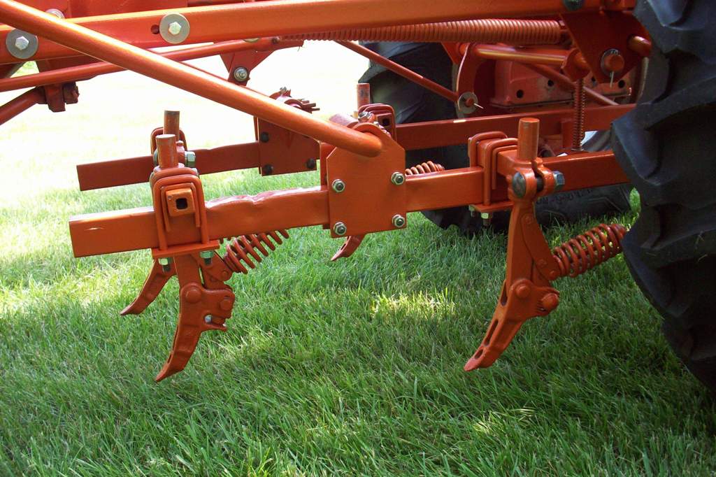

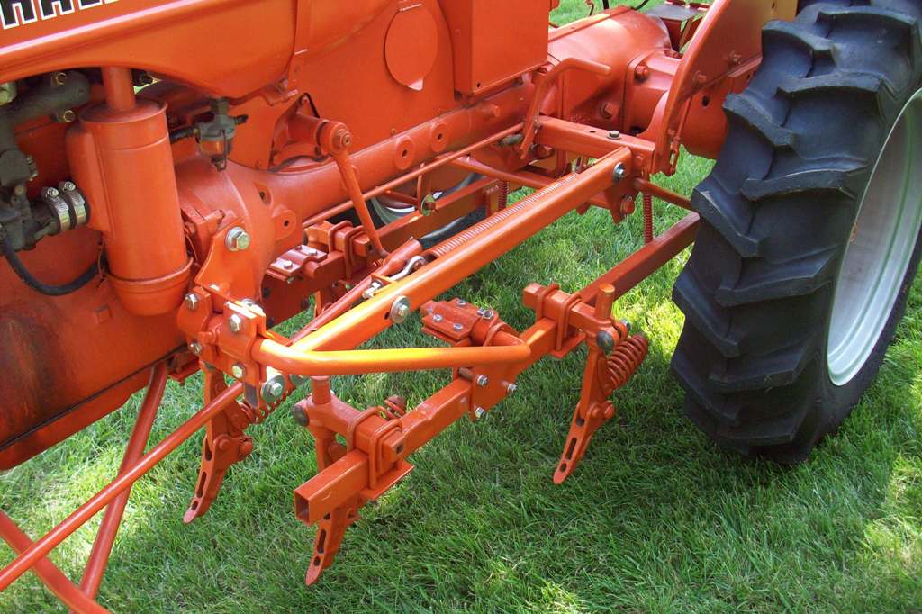

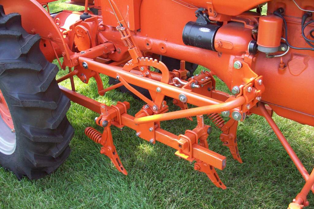

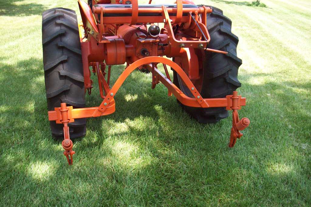

SOME OTHER ANGLES
Hard to see but the cultivator hangs from the rockshaft on those two long vertical rods with springs on top.

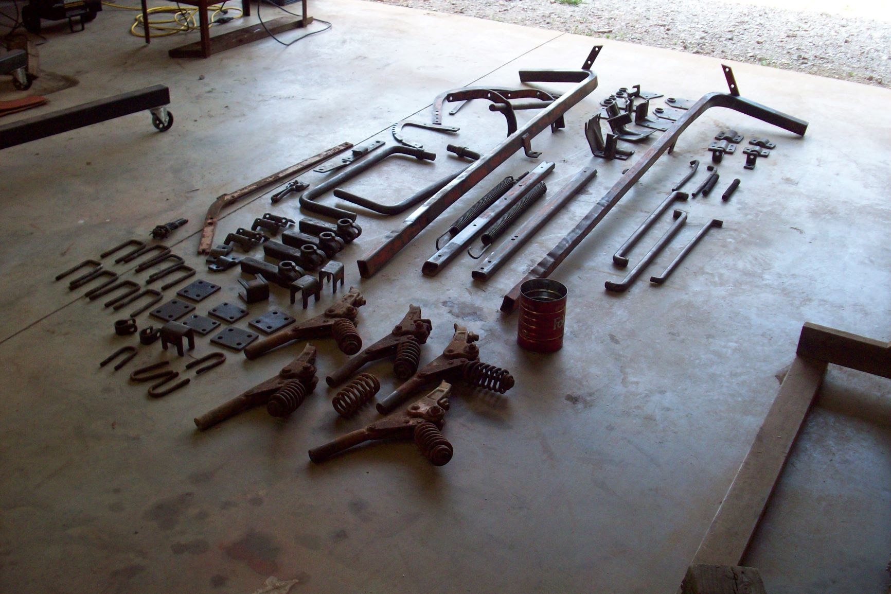

here is the parts breakdown, not sure how much these varied
