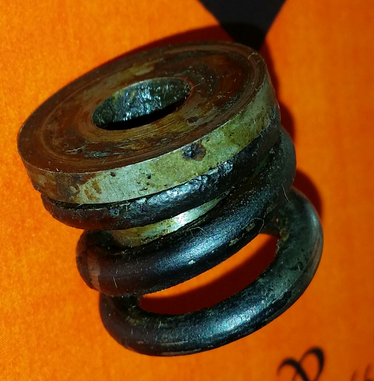

After starting the engine it had no oil pressure, so now  the engine is separated from torque tube to make some service on the pump. It gave a chance to take a good look at the rattling noise I think came from the clutch throwout bearing. It looked good though so I decided to clean and put new grease and hope it will work ok.

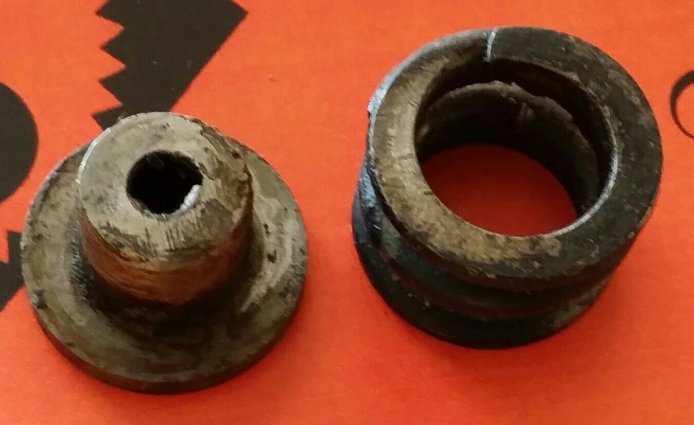

Now to the obstacle - when assembling the flywheel I found this part on photo lying on the floor right under the fastened flywheel. I´m certain it fell out when the flywheel or bearing was removed, but I have no idea where it fits.
Please give me no guess but the one place it fits.

Looks to me like it goes into the slip yoke of the draglink.

I fell of the drag link.

Of course... you make me remember I turned the drag link and it must have fell out then. Tanks for answering so swift!
