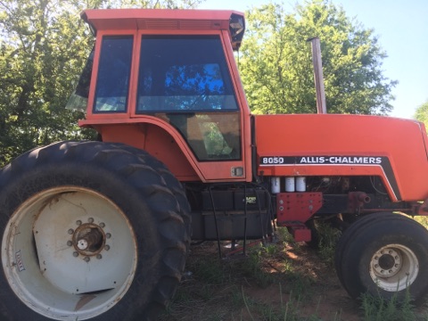

Post Options Post Options   Thanks (0) Thanks(0)   Quote TexasWD45 Quote  Post ReplyReply Direct Link To This Post Posted: 27 Aug 2017 at 6:47pm
Here she is:

Post Options Post Options   Thanks (0) Thanks(0)   Quote AC7060IL Quote  Post ReplyReply Direct Link To This Post Posted: 29 Aug 2017 at 8:00pm
From viewing photos, the 8050 looks to have a red loader frame bolted to the side frames of engine?? If that's correct, then some of it's clutch & transmission issues you mention, could coin with years of loader use. That being said, would I take a chance on buying or negoiating towards a $7000 AC 8050? You betcha!
It's side shield looks good & its got a set of duals. How about rear inside weights? Rear tire fluid? Front weights? Power shift rear rims?

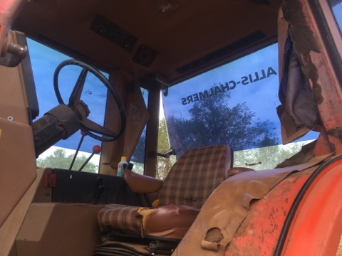

Post Options Post Options   Thanks (0) Thanks(0)   Quote VAfarmboy Quote  Post ReplyReply Direct Link To This Post Posted: 30 Aug 2017 at 1:39am
In my part of the country an 8050 2wd with a weak clutch, trashed cab, and that many hours wouldn't bring $4K at auction.
