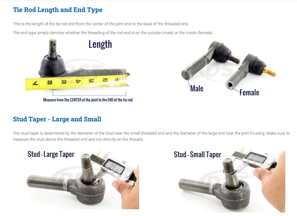

Dave - those are all rod end bearings , the ones used on this tie rod are automotive type and about 1" diameter threads . the stud is a tapered machined surface that wedges into spindle housing
Points: 89933
Post Options Post Options   Thanks (0) Thanks(0)   Quote steve(ill) Quote  Post ReplyReply Direct Link To This Post Posted: 12 Jan 2025 at 7:54am
Coke... if the get a couple dimensions, you might match up here..
Edited by steve(ill) - 12 Jan 2025 at 7:58am
