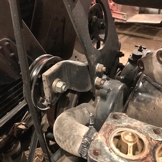

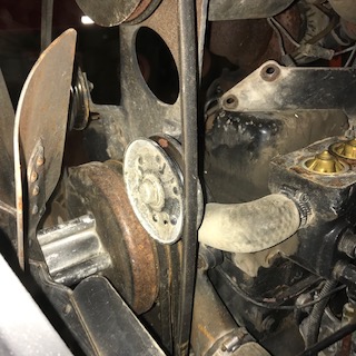

Farmboy, do you have a picture of the setup? It may come to that, but I think have an underlying problem bc before I never lost a belt like this.

I'll take a picture tonight for you

Sorry for taking so long

No worries, I appreciate the picture.  It looks like the 7020 has a little different accessory belt path than the 7000, but the A/C is the same.  My alternator is on the tractor's left side.  I will hang onto this photo in case it comes down to adding another pulley.  Oddly, the side that whips the most is the side with the tensioner on it.  The worst part is between the crank pulley and the tensioner.  I'm contemplating a new compressor since it feels like it is only compressing about 1/2 of the rotation, whereas an axial compressor, it should feel like a pretty consistent torque all the way around.

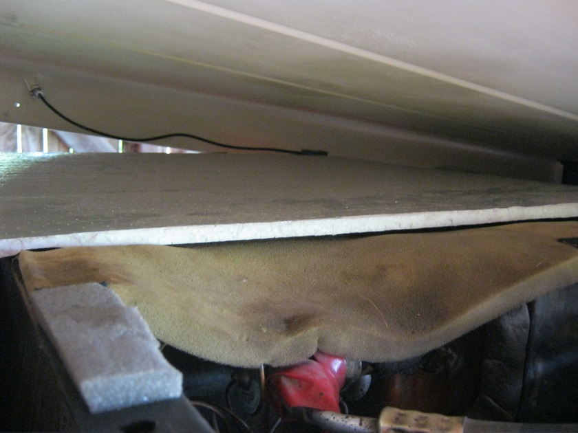

The small dial to the left of the red tape says R 134a. I used a 1 gallon pump sprayer w/ straight water to clean the heater and evaporator cores. I also used 3/4 Pex ball valves in the heater hoses. They fit tight in the hose.  I have that sun tint film come down about 12" from the top of each window. Tim

Thanks for posting the pictures of the cab roof removal- I need to replace the expansion valve on my maroon belly 7000 and I was thinking I'd need to take the cover off the ceiling of the cab to get to it...  Removing the cab roof to access the expansion valve looks so much simpler and I like the idea of adding insulation.
