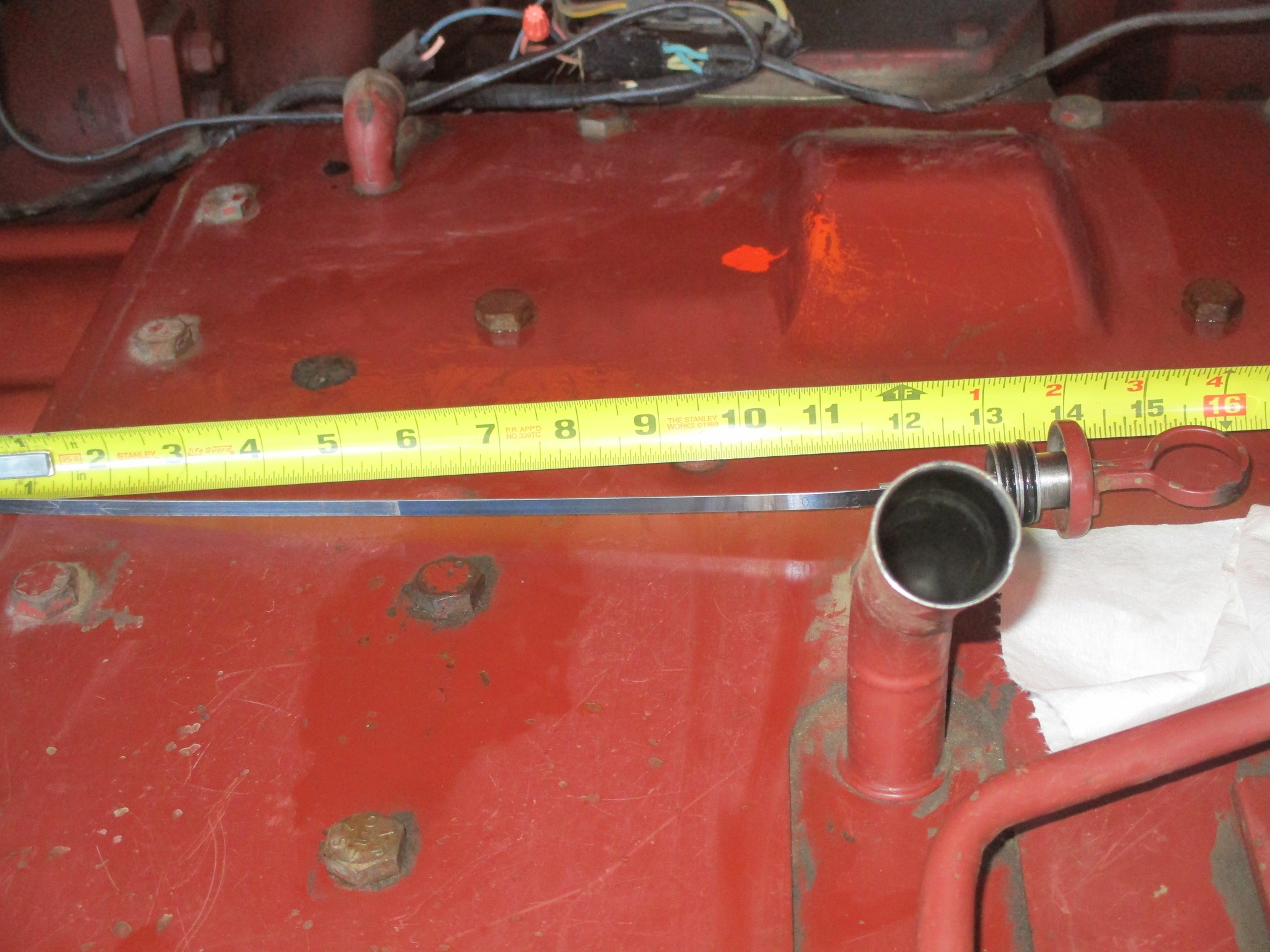

I am talking about the differential oil dipstick located at the back of the tractor above the 3 point
Tim NH View Drop Down
Joined: 16 Oct 2012
Location: Lancaster NH
Points: 1125
Post Options Post Options   Thanks (0) Thanks(0)   Quote Tim NH Quote  Post ReplyReply Direct Link To This Post Posted: 16 Jul 2020 at 10:21am
Finally had a chance to get your info. Overall length of dip stick sitting in tube is 13 7/8". Low mark is 1.5" from the end, and full is 2".
