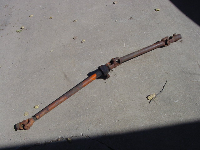

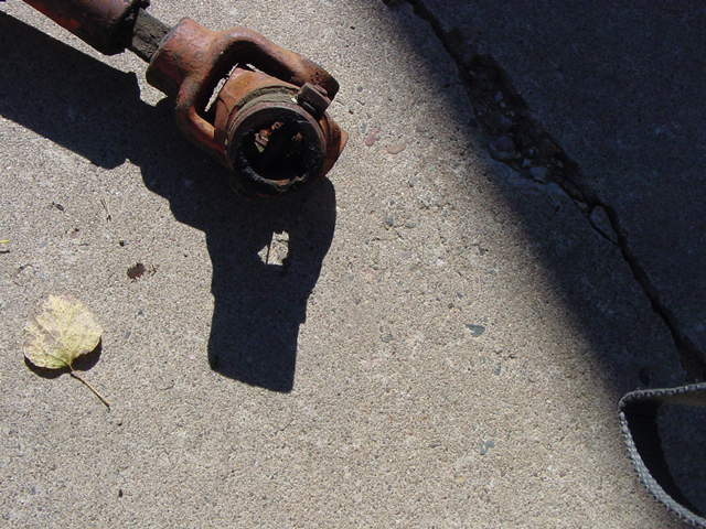

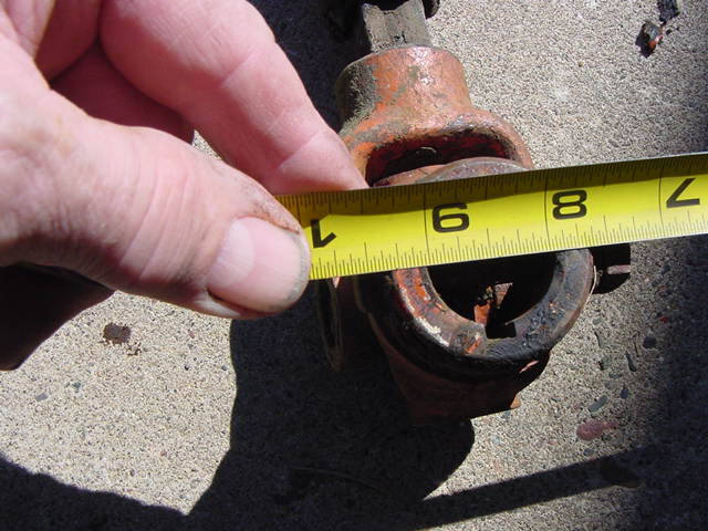

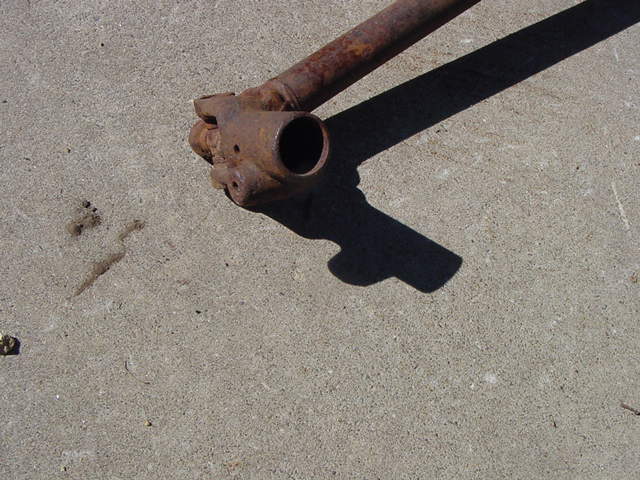

I think this is what you need, but the rake end connection is for a 1 inch keyed shaft on the gear box. Also if you purchased a one piece shaft, you may find that a problem also.
This came from an operational rake that sacrificed its future so that another may live.Clap
