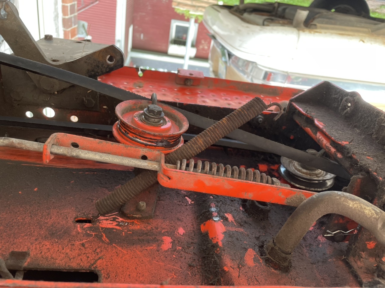

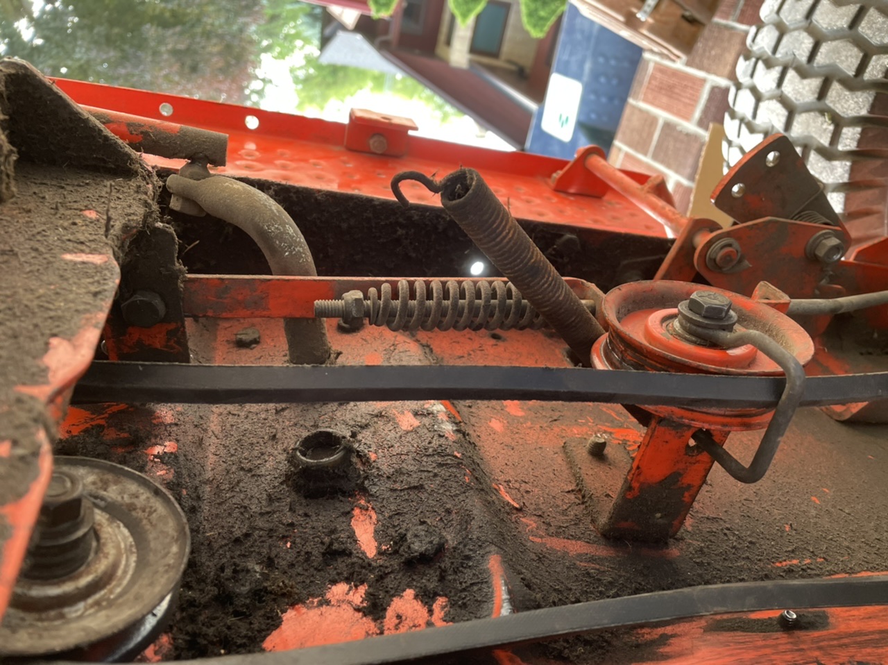

Anyone have a picture of the clutch tension spring installed on their garden tractor? Been through the manuals and that’s the one part they do not show.
Just replaced the drive belt and re-attached the clutch rod link to clutch rod assembly. Got where the back of the spring attaches to the frame but missed where the front attached to wherever.
Will try to get a picture soon.
Don

I don’t have one but going by your first picture it looks like it should be pulled forward and placed in the hole on what appears to be a plate that pivots that hangs down? Wait a minute, is the deck installed? If its not maybe it attaches there somewhere?
