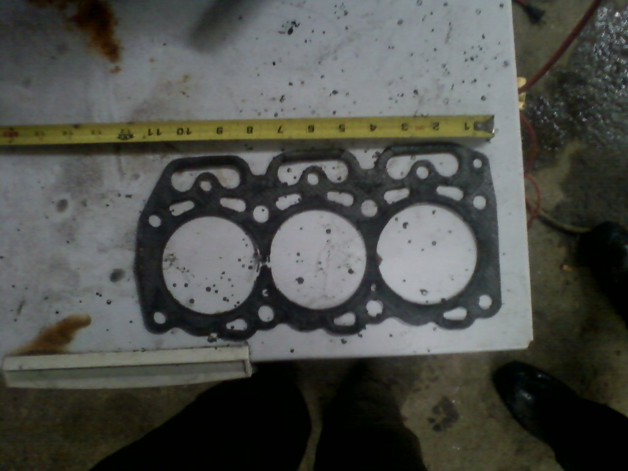

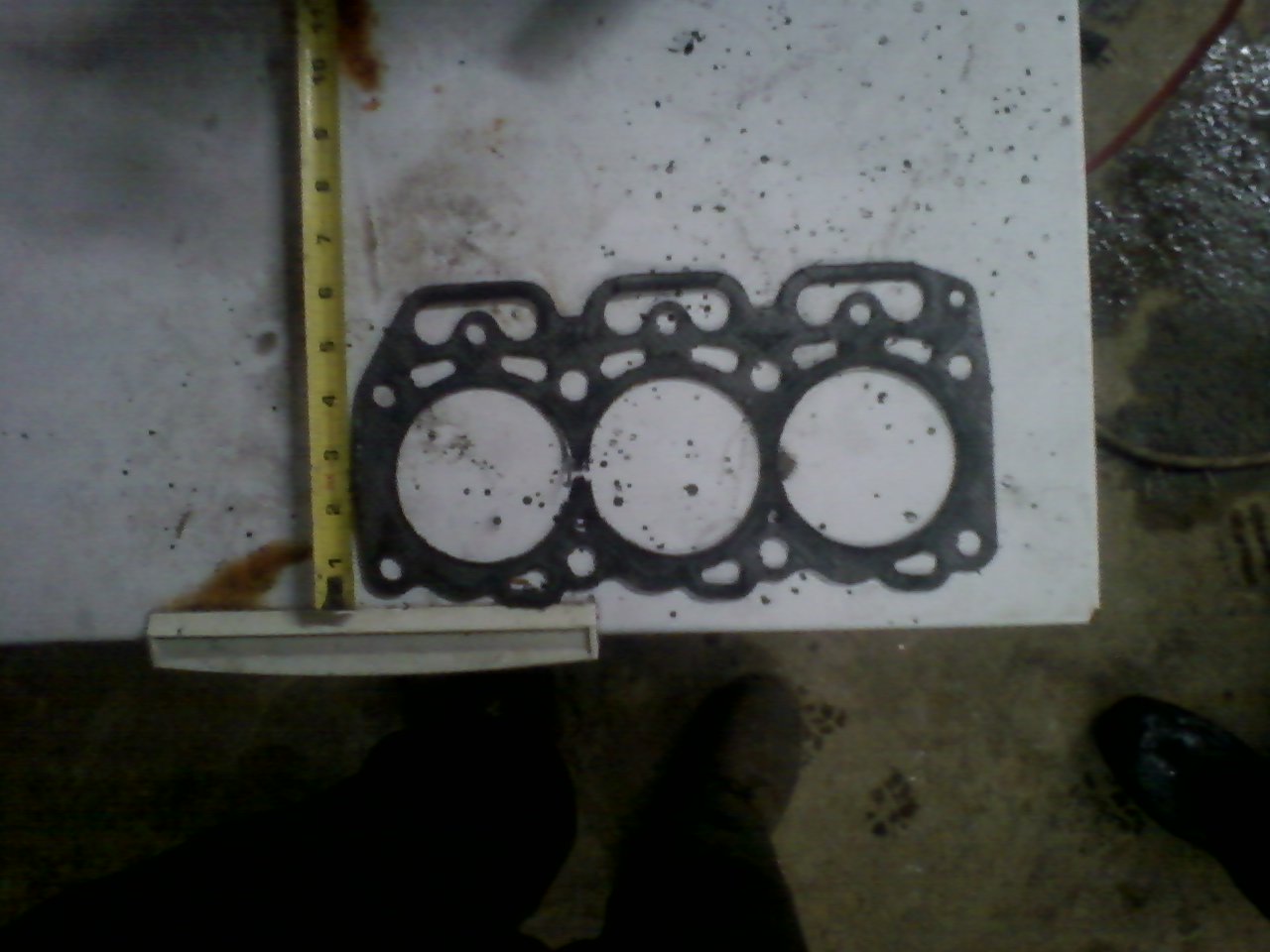

just to update you this is what i found
head and block look ok but what a shock
when i price the new gasket from agco
they only want $ 268.00 for a
3435666M1      87cid Toyosha engine
and three week to ship one in plus fright
dose anyone know of an after market
number or where i could get one
any help would appreciated
TIA       B:-)     Dnoym
