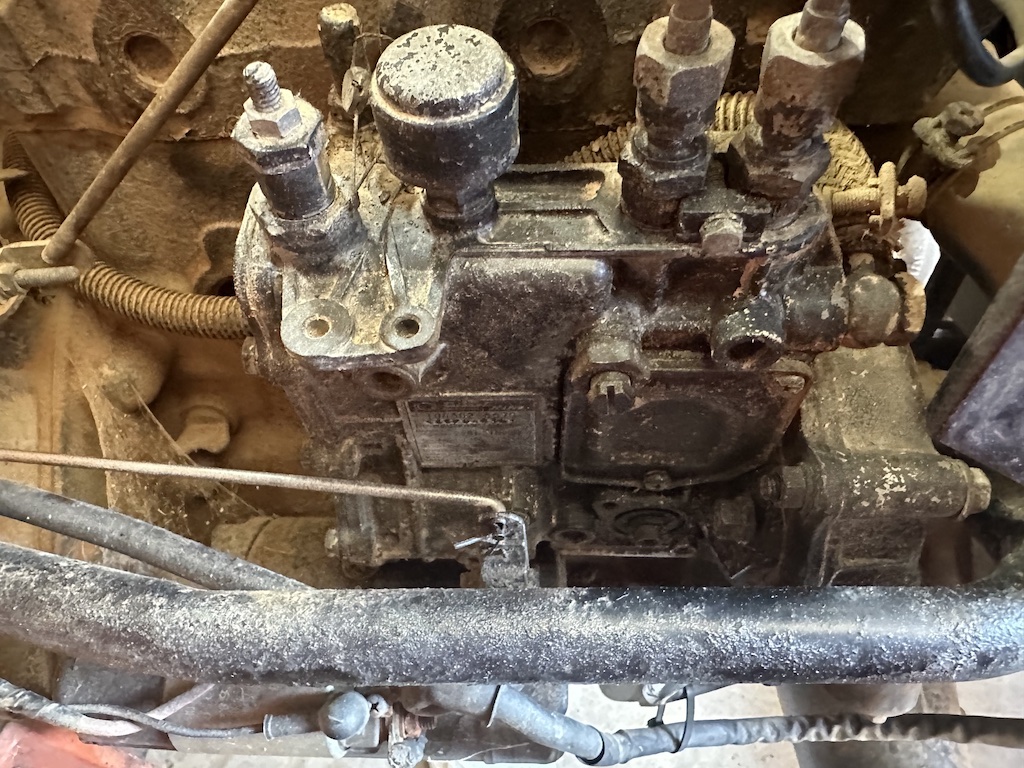

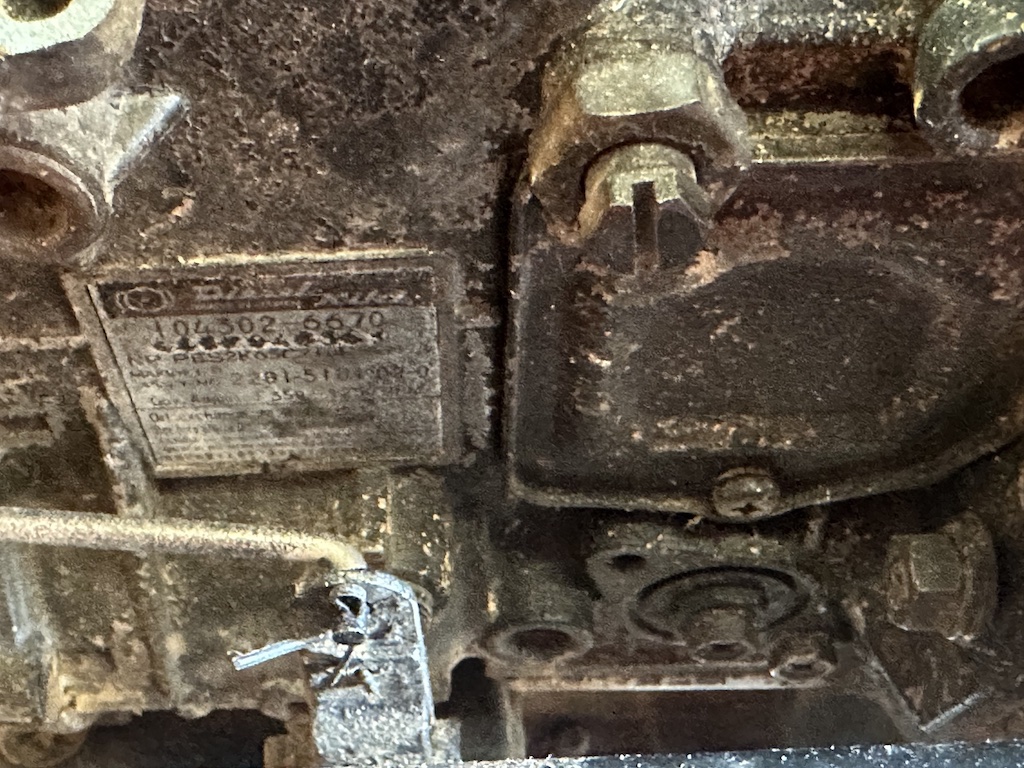

Trying to identify the Fill, Check, and Drain ports on the injector pump from an early 1980's AC 5020..  The injector pump doesn't look exactly like the one in the OM or SM.

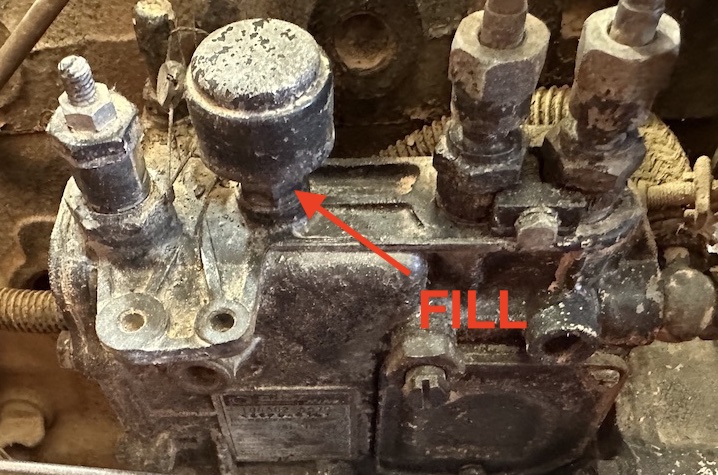

Very bottom of second pic u see to phillip head screws bittom is drain then top left corn next to drain is the fill level screw. Only takes alittle oil

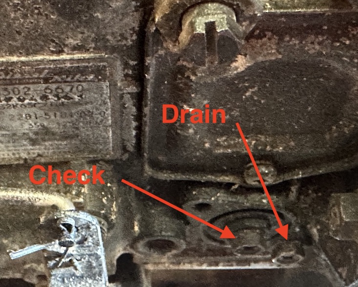

Just to clearify:

Post Options Post Options   Thanks (0) Thanks(0)   Quote jwalters16 Quote  Post ReplyReply Direct Link To This Post Posted: 24 Jul 2024 at 2:51pm
Yes that is correct
