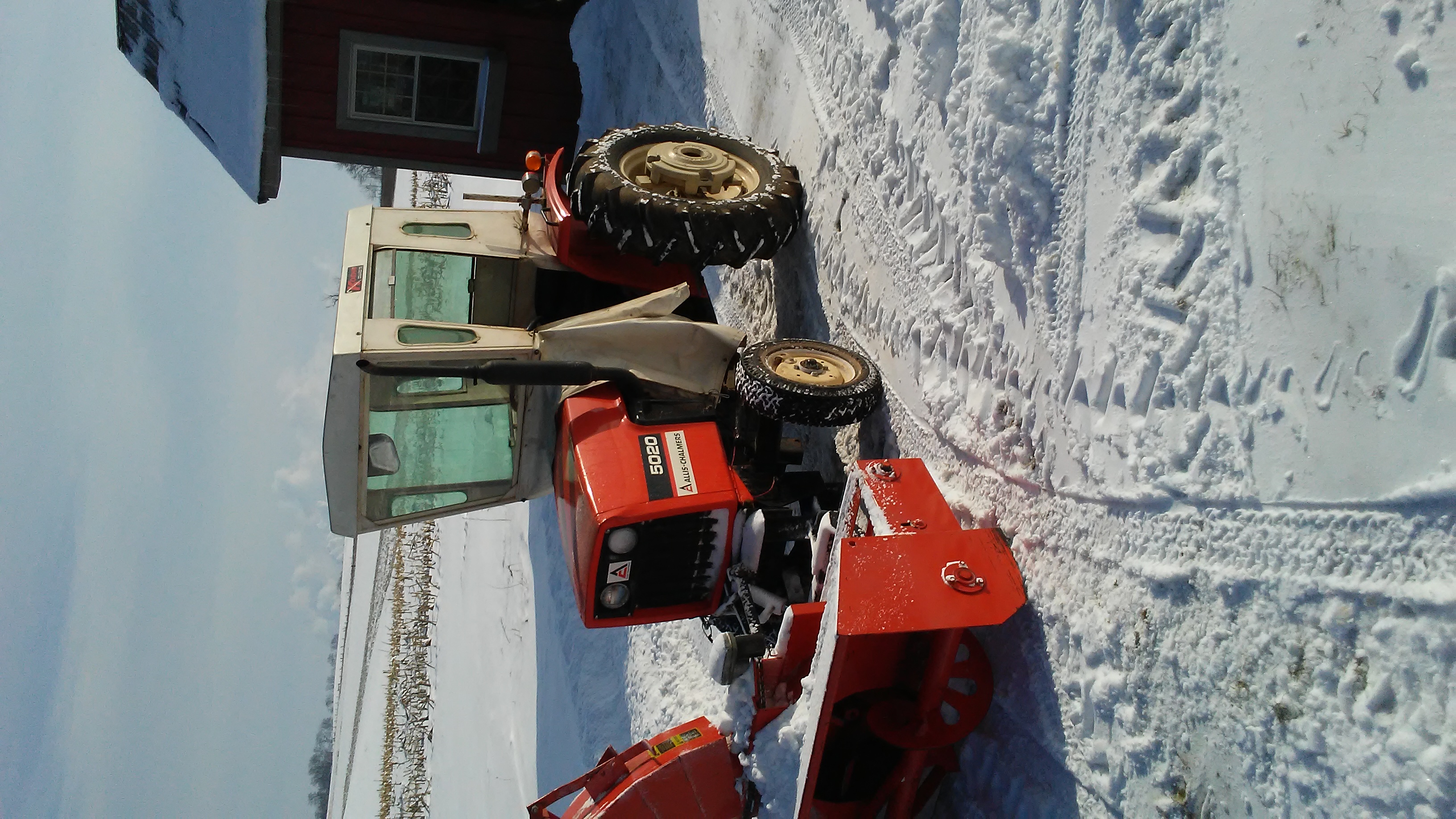

I've never used my diff. Lock just the brakes as suggested above.sure does help at times pushing this around.

nice lookin rig Eric
Edited by Gatz in NE - 20 Jan 2018 at 8:51pm

eric pa,that 5020 with the blower is one sweet setup.I like it!!!

Love those weights on the back of the snow blower! That thing looks too nice to use!

I was thinking about trying to hang some weights off the blade. I does look like it should work pretty well. That' may be my cheapest and easiest solution.  Back end really needs some weight. Thought about water in the tires too but don't know much about that process. Wheel weights would be a nice touch but probably hard to find and too expensive.
They're weights from my old D 15, had to have adapter brackets made to be able to hang them on these wheels however. Thanks for the comment.
Thanks, and for fixing the picture. for whatever reason whenever I post from my phone that happens
Thanks, but with all that weight hanging out there it really gives the Armstrong power steering a work out! Wink
