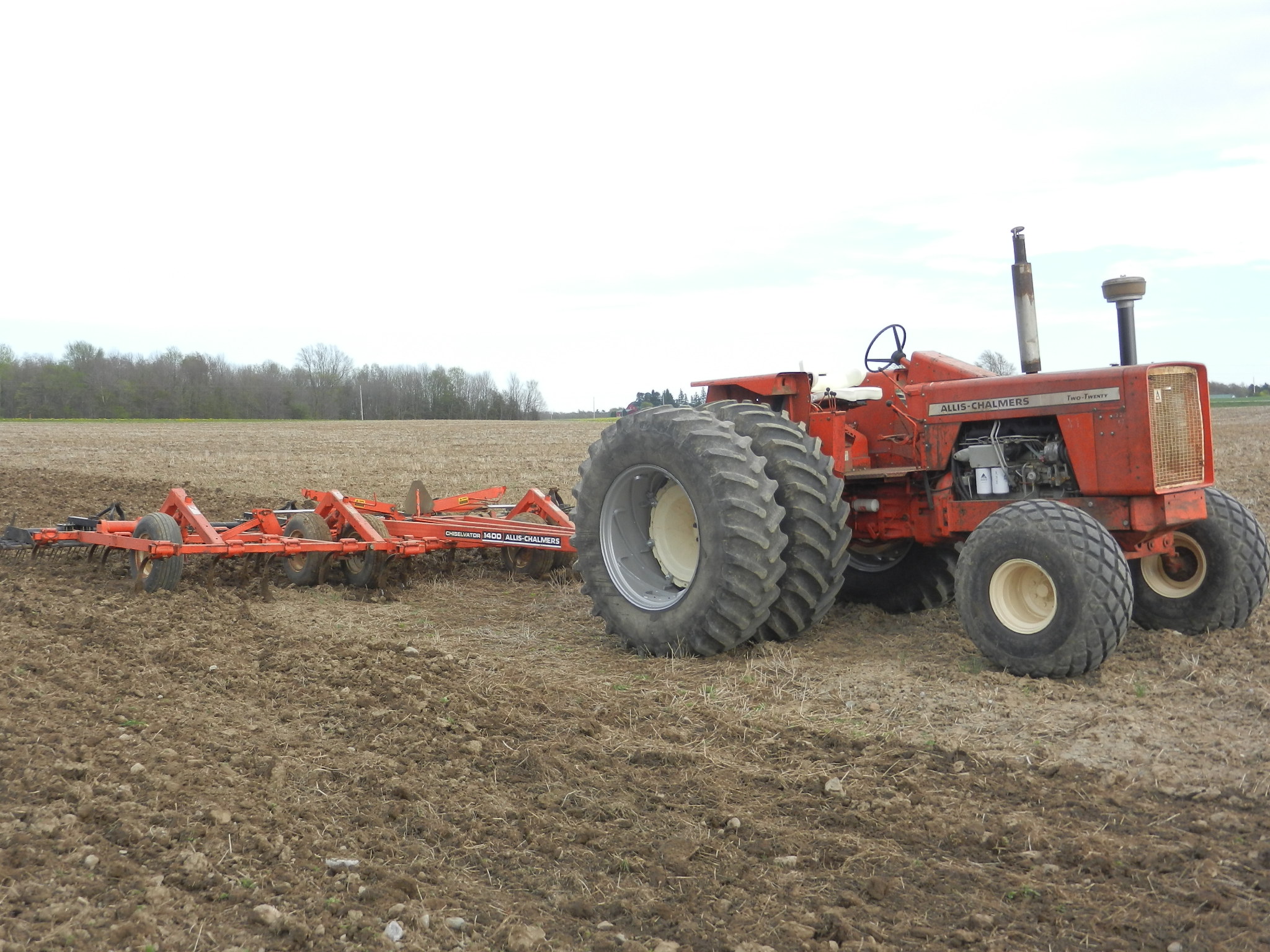

I bought a 24.5' 1300 new in 1977 and pulled it with my D-21 ll with duals back then. This spring it will go to the field for the 40th consecutive year. In the past there were years that it cultivated more than 1000 ac in a year. All original rubber mounts and shanks except for 3 that got bent on rocks. I use it now as a finishing cultivator with a double rolling crumbler and buster levelling bar mounted on the back. Trussed the frame a little to take the extra weight on the rear. MOST IMPORTANT thing to do is to lift it when your turn. Not a lot of clearance. Finally found a 1400 the same width for the first pass.
Will hook a D-21 to the 1300 and a 220 to the 1400 this spring.

My 220 handles the 1400 In 5th gear with no problem. I may have to qualify my answer a little. My 220 has 20.8 x 38 radial duals with 3000 lbs of inside weights and Mexican hat duals. It weighs 17,300 lbs. It also has an industrial intercooled engine that dynos 190 hp without touching the injector pump.

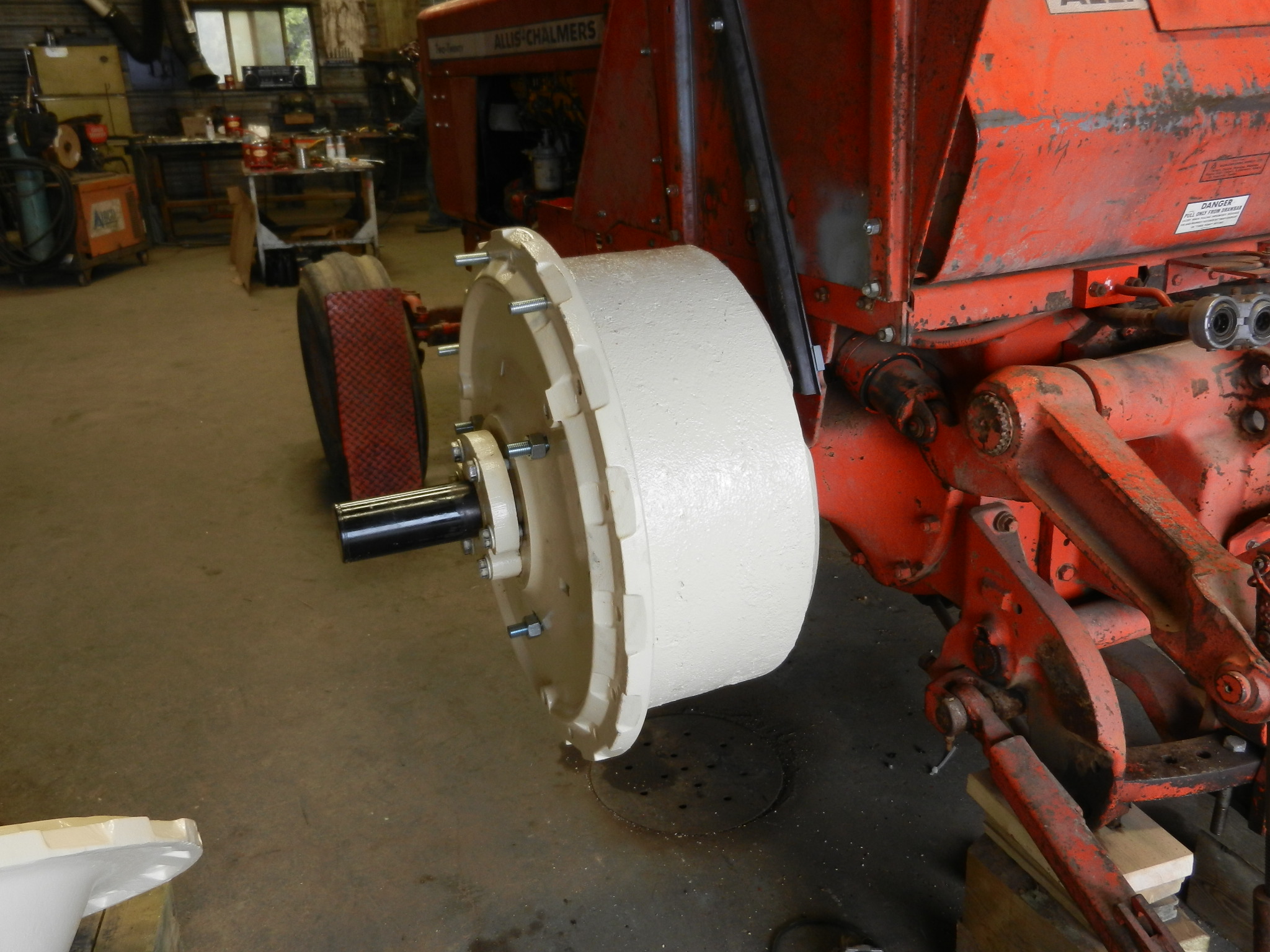

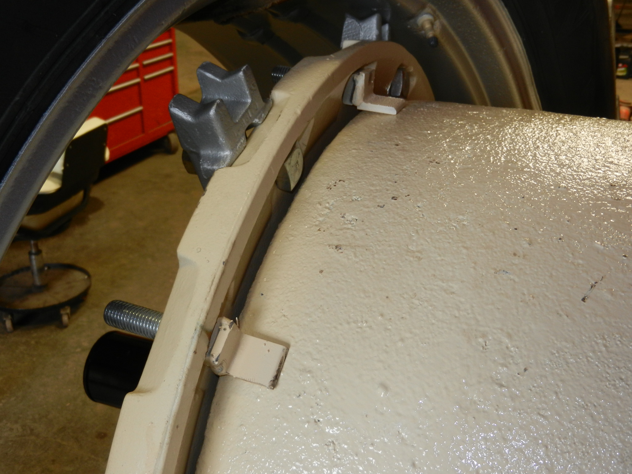

calvin Schmidt, 3000 pounds of inside weights? Wow, what did you use and where did you put all of it....must be some hellacious bolts and stuff. Pic?
Dans 7080 View Drop Down
Joined: 05 Feb 2010
Points: 1146
Post Options Post Options   Thanks (0) Thanks(0)   Quote Dans 7080 Quote  Post ReplyReply Direct Link To This Post Posted: 21 Apr 2017 at 6:49am
3 500lb per wheel. I know of a lot of 7000 series with 3 per side.

I bought a set of weights that had all been on a D-21 (hard to believe) 2- 1500 lbs inside weights and 2- 1100 lbs outside weights. The 220 has the 1500# inside weights. I was getting it ready to pull a deep ripper but then bought another tractor with MFD.
