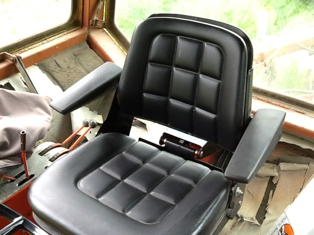

Post Options Post Options   Thanks (0) Thanks(0)   Quote Leadoff Quote  Post ReplyReply Direct Link To This Post Posted: 02 Aug 2022 at 9:37pm
Tracy

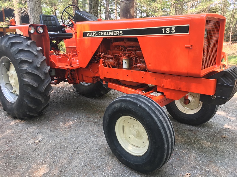

Here is the "Marathon Seat" on my 185
The tractor was delivered to our farm in May, 1975 with the original Milsco Marathon seat.  The exact replacement seat in the pic was supplied to Serco Loaders, Two Harbors, Minnesota, by Milsco, and is available thru their service/sales offices.

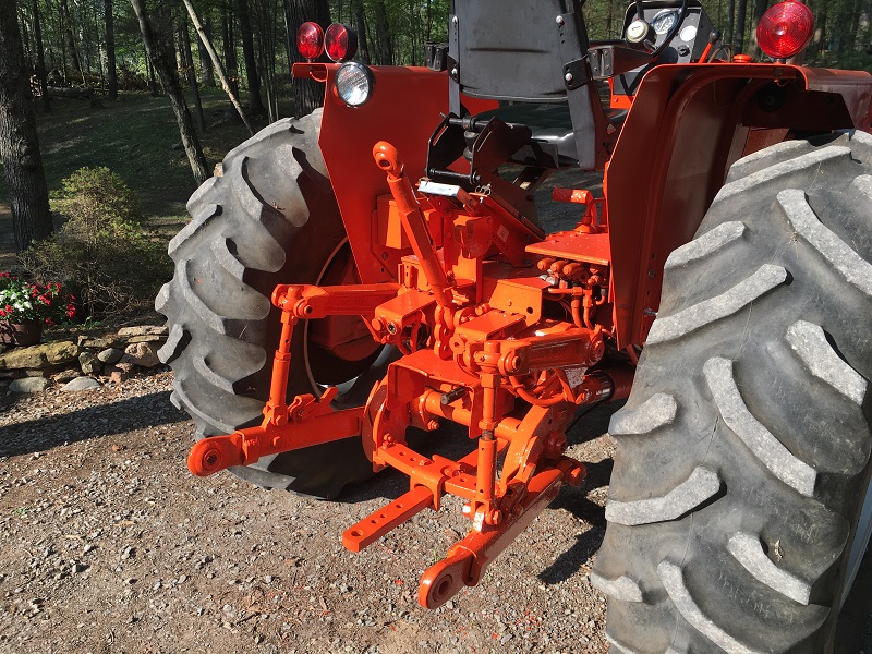

Better angle
Let me know if you want more info.

Leadoff, Seat looks good. Could you post some close up of the back of it and sides of it. That seat frame is different than the 170-175 seat frame and base. Thanks, Tracy
Leadoff View Drop Down
Joined: 14 Oct 2016
Location: Calgary
Points: 317
Post Options Post Options   Thanks (0) Thanks(0)   Quote Leadoff Quote  Post ReplyReply Direct Link To This Post Posted: 03 Aug 2022 at 8:51pm
Allis Dave
Thanks for the feedback.  Nothing like a fresh coat of paint

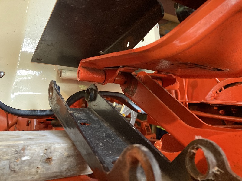

Tracy Martin Tn

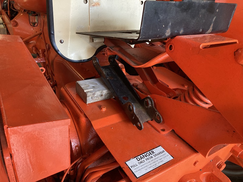

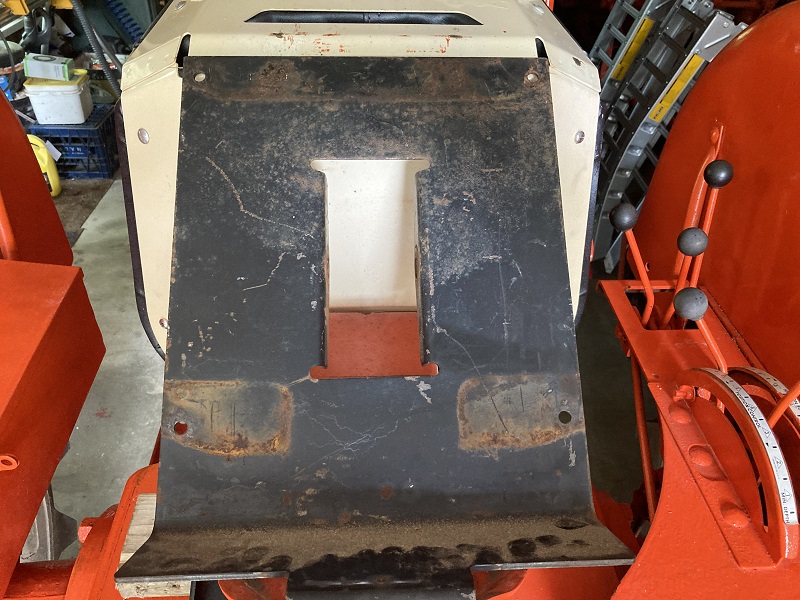

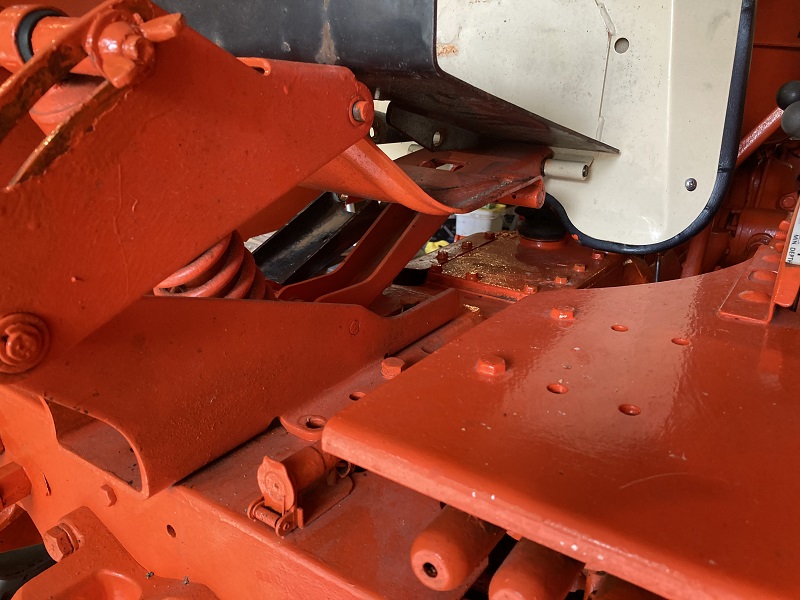

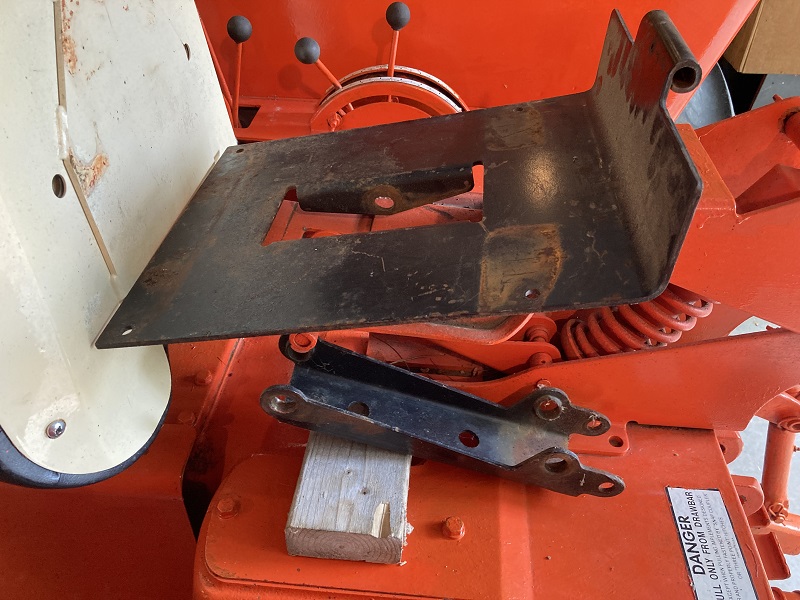

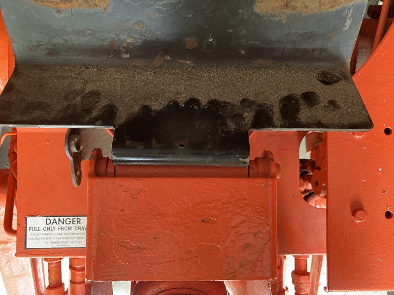

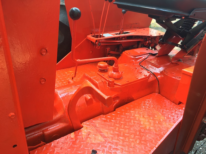

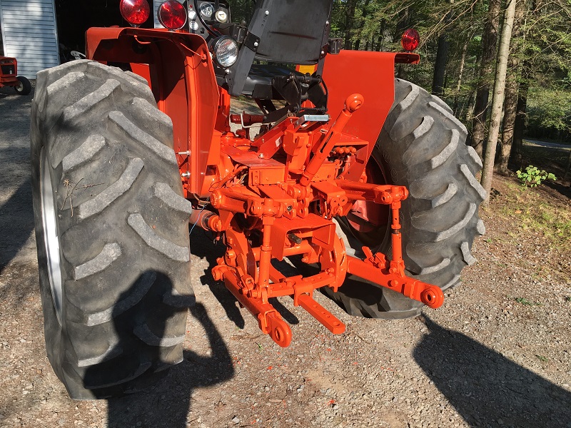

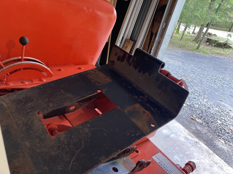

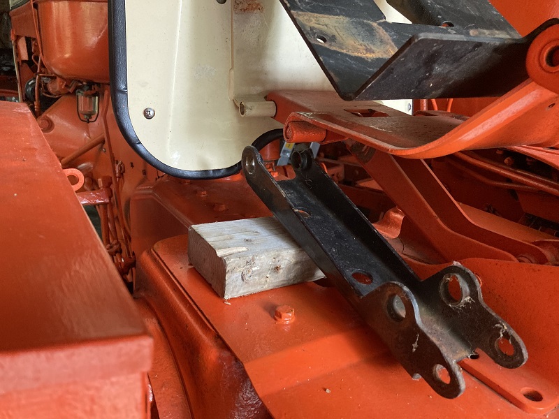

Here are some ideas/options to utilize the Marathon Seat for your consideration.......
BTW..I do not receive any benefit from the utilization of the Marathon Seat other than helping out a fellow Allis Chalmers owner
Allis Chalmers seemed to carry common seat design and parts from the D Series thru the 100 Series, and other later models.  I grabbed a couple of old seat frame parts from a 185 to check layout/dimensions, comparing to my D17 IV (should be same as your 170/175)
The upper pan type piece is what the Marathon Seat rests on, and is part no 70269208.  The other piece sitting on the 2x4 is Lower Arm part no 70268170.  Both parts seem to line up perfectly with the D17 parts, dimensions, holes, etc
The 185 Lever Arm is wider than the D17 Lever Arm, but should still fit the shock absorber, spring, and spring retainer at the bottom end of the assembly where it mates up with the main seat support base.  The spring retainer part 70225764 is common to the D17 and the 185.  The upper end of the Lever Arm connects to the upper pan piece.
Side view showing distances.  Note the rust stains on the pan showing where the Marathon Seat was attached - four Cap Bolts connection
Other side view from behind
Top view
Tilted to see D17 match
Top rear view.
You would lose the flip up/higher position with this arrangement.  As you know, the 185 has the capability to push the seat up/back on the rails.  The other consideration would be the space to the steering wheel might get tight as the Marathon Seat extends in from of the support pan.
Also, the 185 Lever Arm is a good upgrade from the D17 Arm (wider/more stable) for the minor additional cost from your used parts supplier
Hope this helps you find a solution for your project
