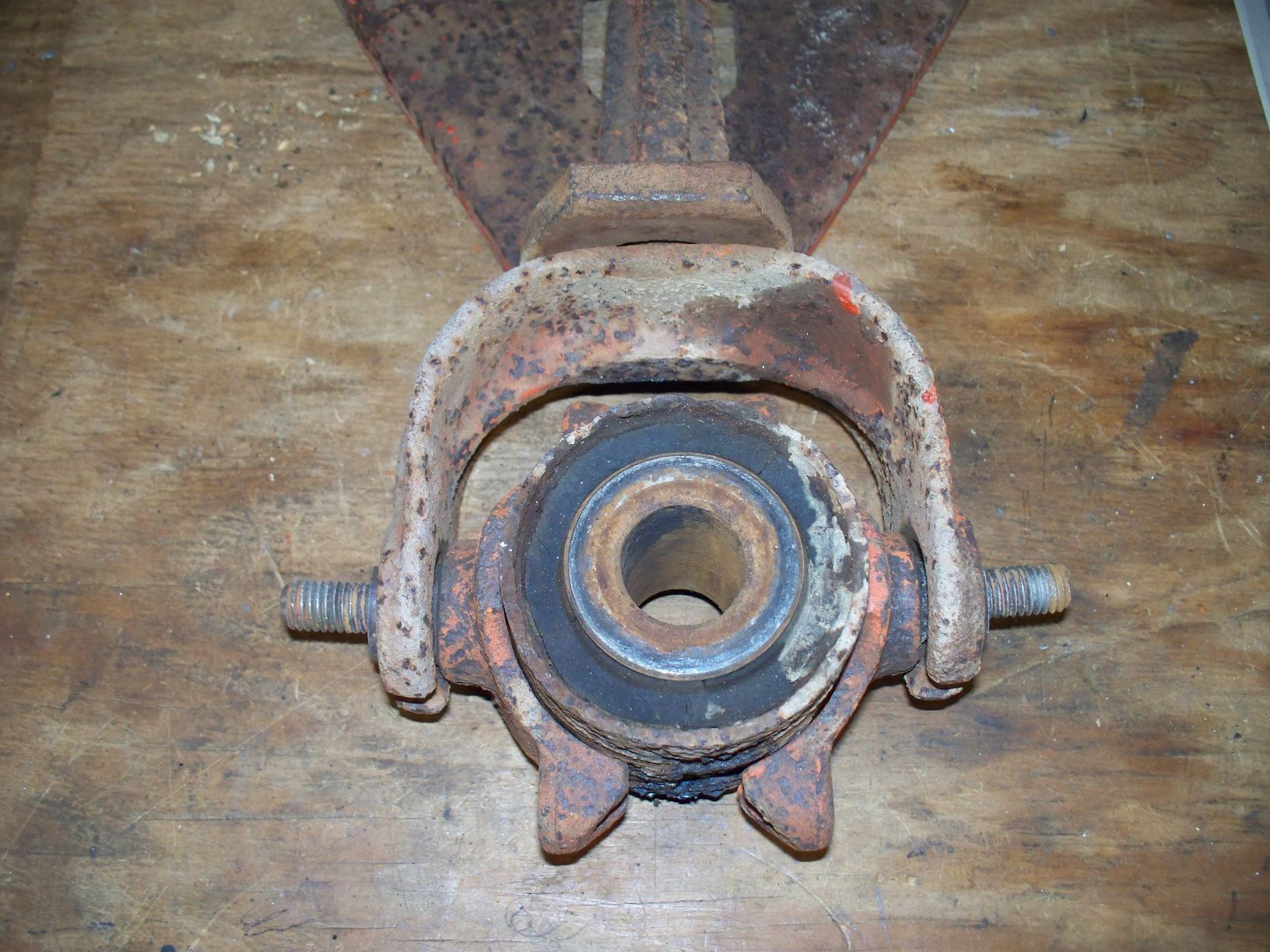

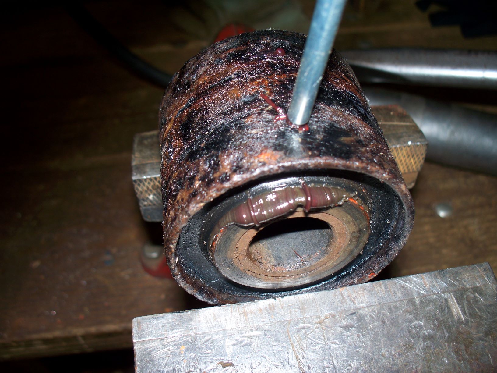

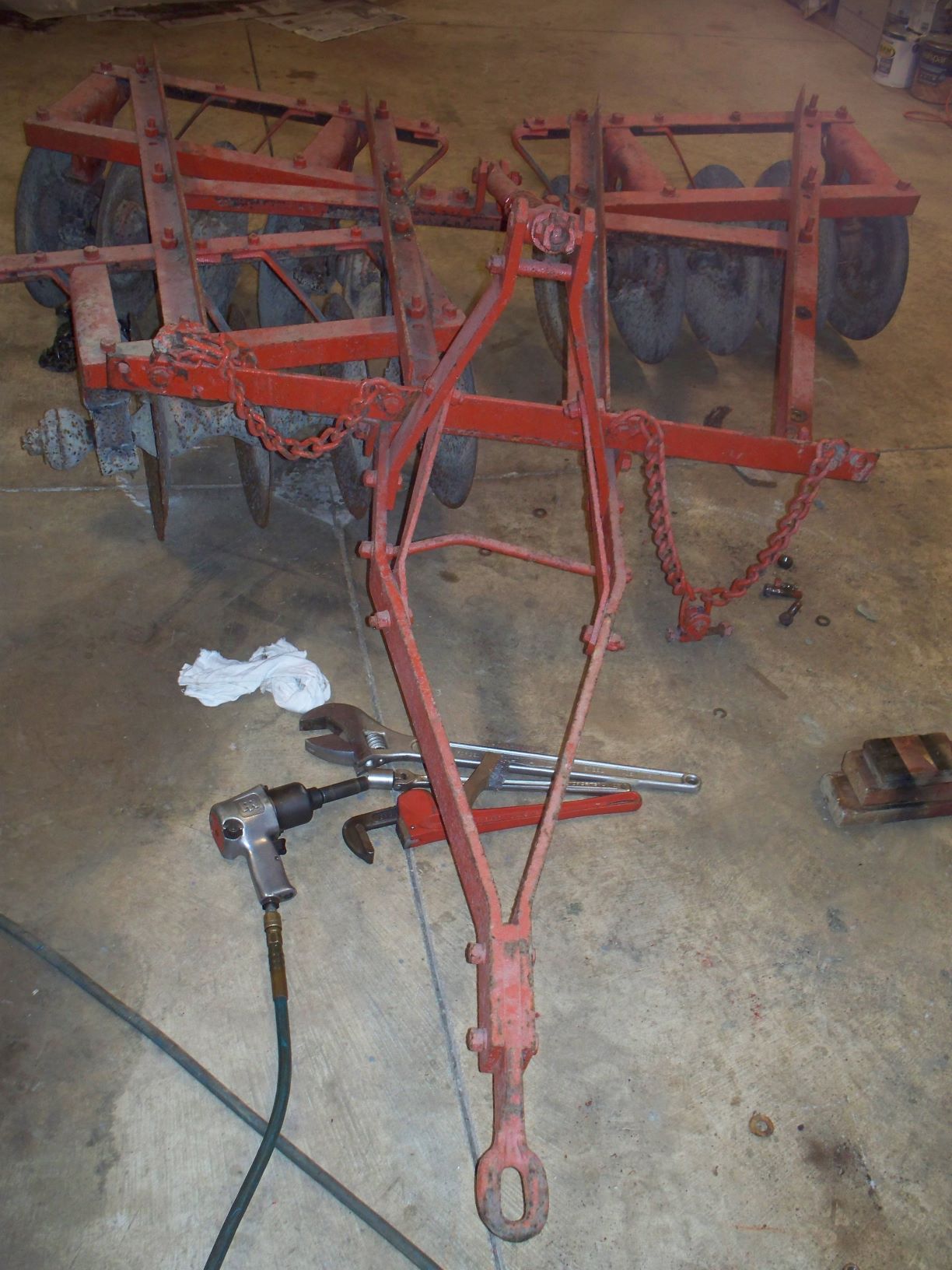

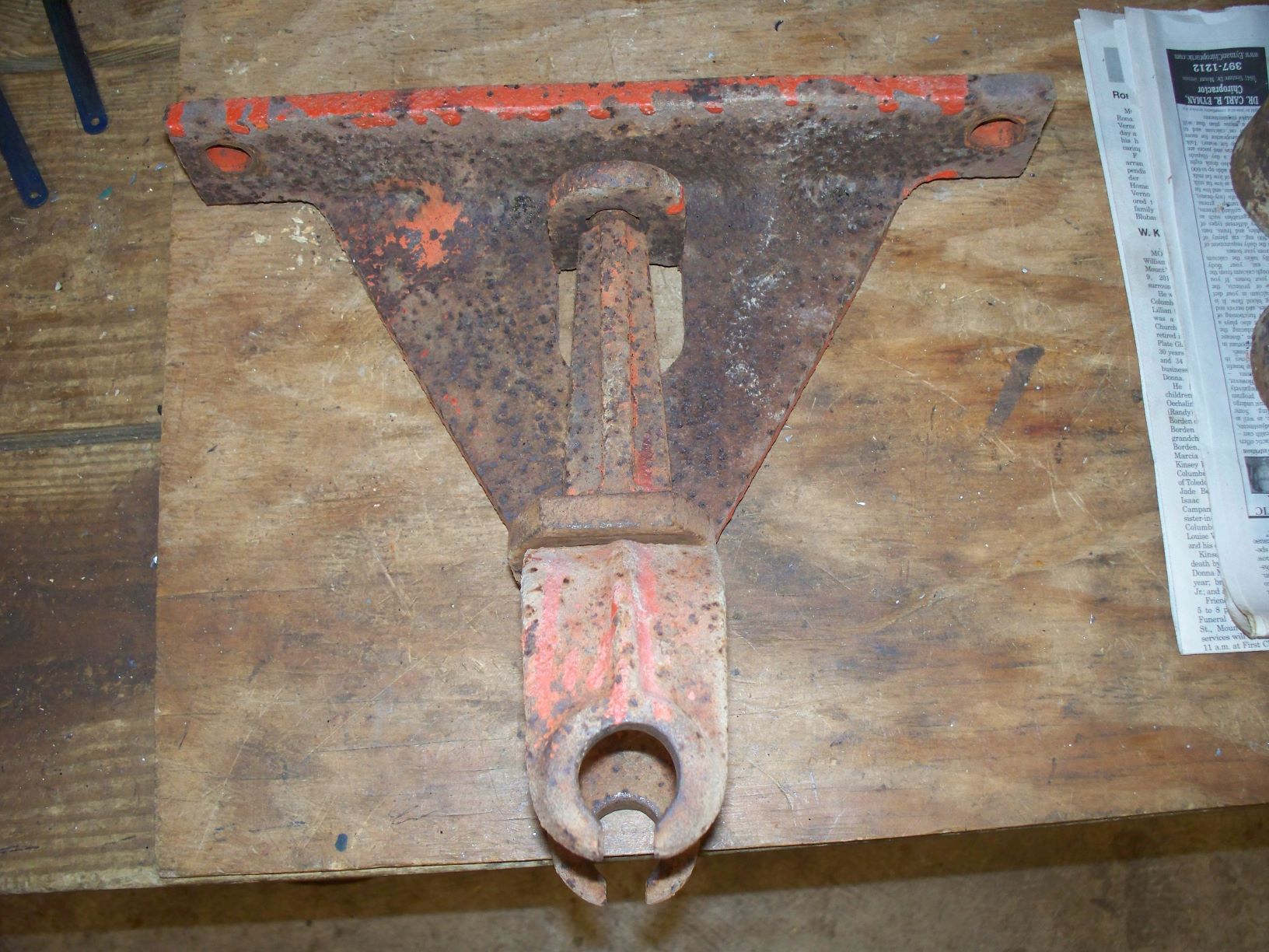

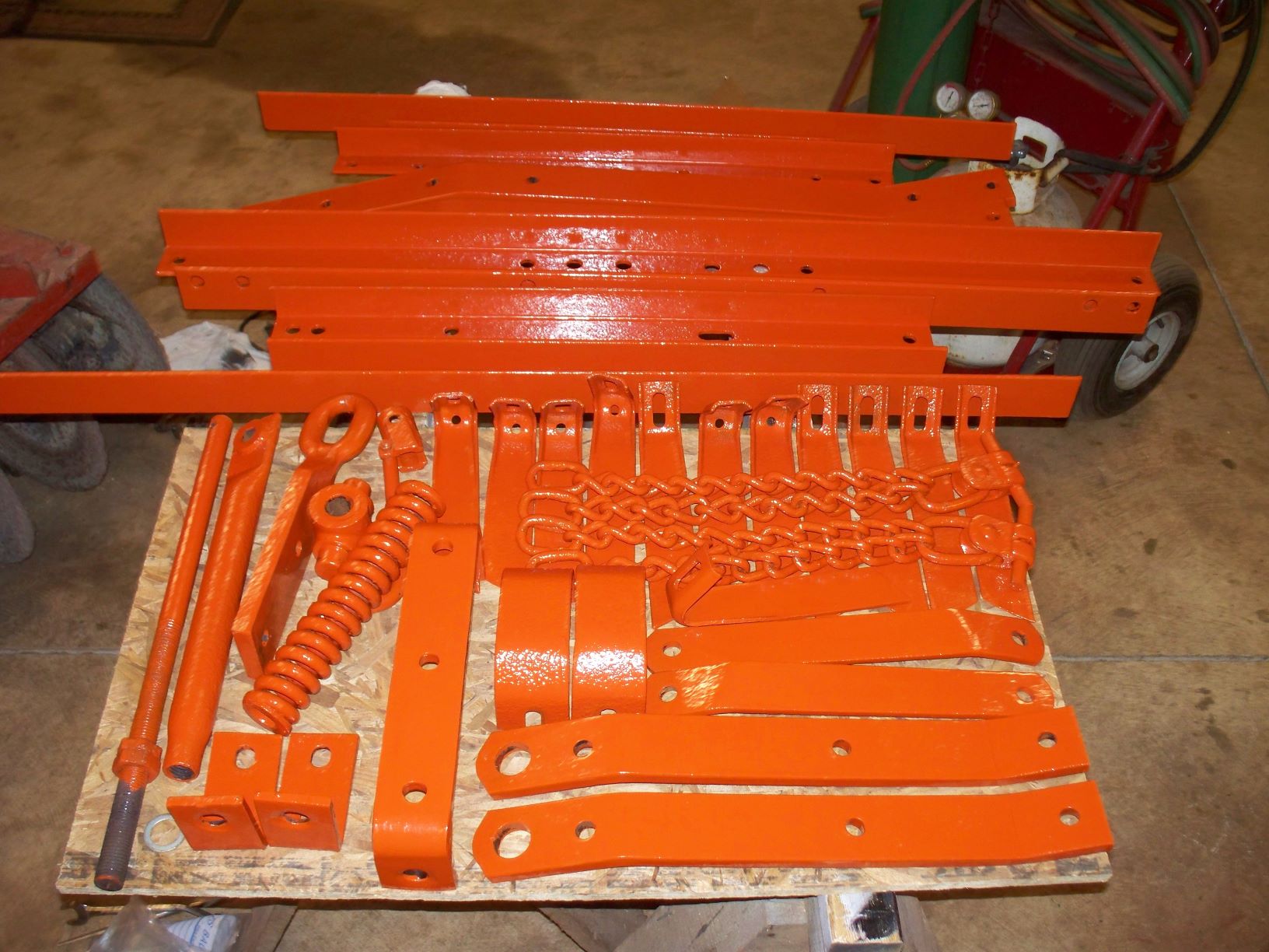

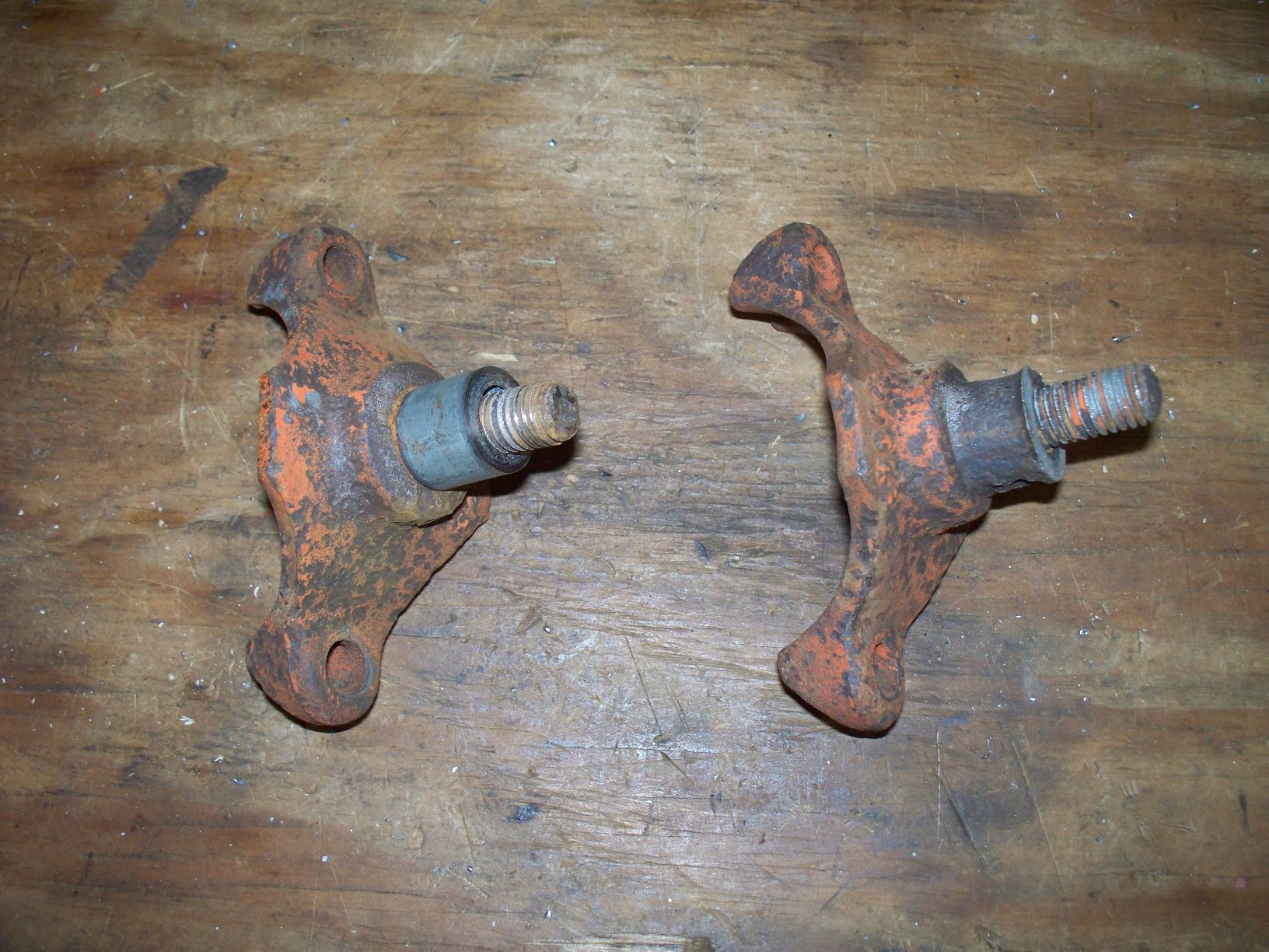

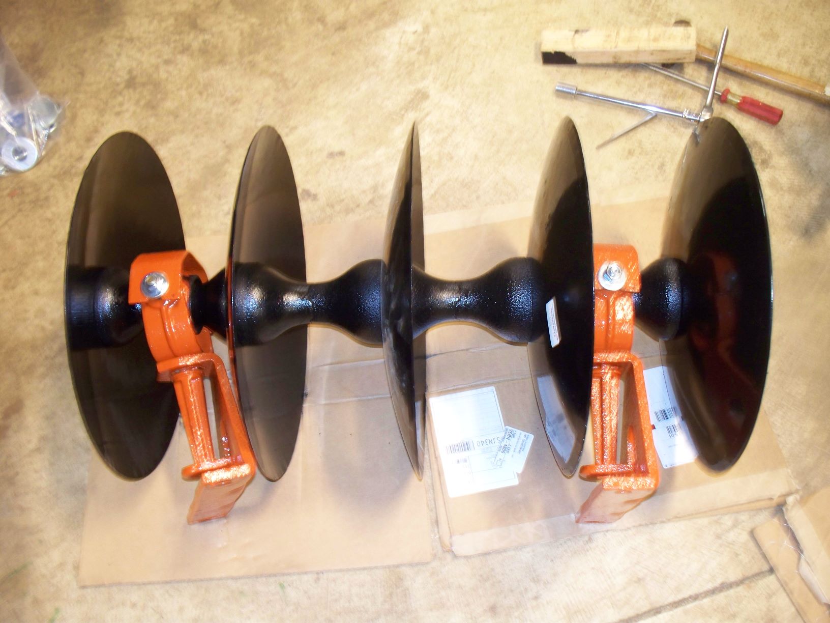

My Latest project is this 6 1/2 ft. disk I bought quite a few years ago as one of my retirement projects. Several of the blades were broken but all the rest of the parts are there except for a couple of the scrapers. Mikez had those, thanks. Drilled small holes in the bearing cases and added some grease to those then some silicone around the edges and in the holes. Made new pipe spacers for the bolts in the bearing holders. Will use all new bolts when reassembling the disk. Got one of the gangs back together and found some USA made blades at TSC. I was surprised at that.  Have about 2/3 of the parts cleaned up and painted so far. Now that grass mowing and gardening has begun progress may be somewhat slower.

Looks awesome!!! So encouraging! I have a #40 set of disc and I want to restore, don't have the time right now and also need bearings!

Man that is looking GREAT! way to go. I have not seen the 6 foot version before.
