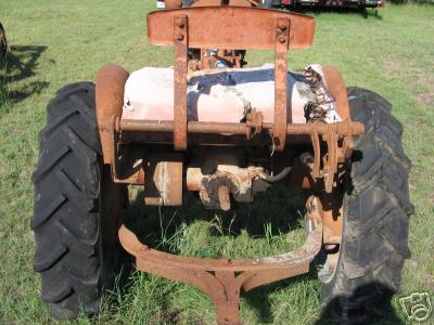

Could you post pic's of these drawbar set-ups for those of us who are still trying to learn about these great old tractors?

Here is the ASAE drawbar and Turn buckle supports

Thanks for the pic. Now, I have other questions.
Were both the ASAE drawbar and the swinging drawbar available throughout the production run of the B model. If not, what years were each offered?
Also, were the flat bar ASAE drawbar braces supposed to be used when the swinging drawbar was used?

I would NOT use that ASAE drawbar.  I am assuming the ASAE drawbar is that extension shown in the picture of the adjustable seat links.  It puts your hitch point too far behind the rear axle for good weight transfer to the rear wheels.  Depending on drawbar height and tow chain length, you could really have a wheelie queen.  I'd hook a clevis right to the center hole on the semi-circular drawbar for pulling.  JMO

Maybe it is the picture, but my ASAE drawbar for the B does lot look that long and skinny. It is fatter and somewhat shorter. Maybe it is just the camera angle.

Here is what has resulted in my experiences pulling my B:
1: With ASAE hitch front stays planted but I sometimes spin out
2: Hooked direct to drawbar, front rises easily, powers out
3: Clevis to drawbar, a mix of 1 and 2.
Chain length plays a good part in this.
