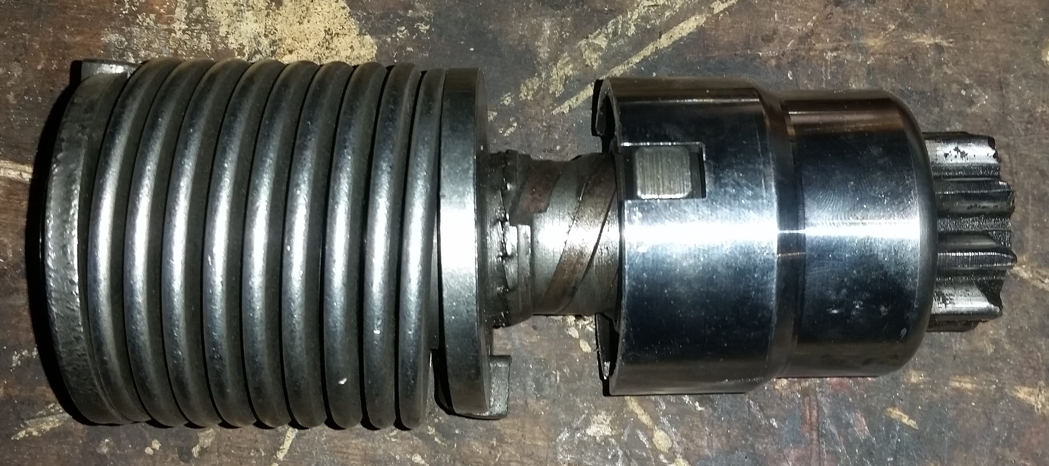

So i took my starter apart, and i have the bendix off the shaft. It seems the bendix is stuck half extended. And there is a problem on the shaft where it's keeping the bendix from returning to its resting state. I found a replacement bendix for $45 so i'm gonna give it a shot.

There is a mechanism inside the Bendix head the is damaged not allowing to retract, easier to get a replacement at this point.

The old bendix you removed is called a follow through bendix, it will not retract till the engine starts and spins it fast enough to centrifugally throw the pin out so the gear can retract. As far as starter keeps spinning, the solenoid contacts must be stuck/welded closed.
