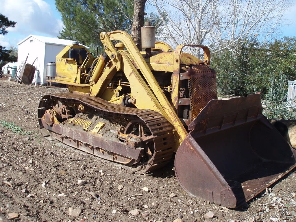

 You guys and all this modern stuff (insert smiley face here) I happen to own a Cat D4 7U Trackson Hydraulic made in Guatamala, now that is going back a ways and it is a horrid damned thing, I swear, it must be the spawn of the antichrist. Now, one thing to remember, no matter how old, how hard to operate, frontwards or backwards controls and how miserable you are while doing it, any piece of equipment out there in, my opinion, beats the beejeebers out of using a shovel and a wheelbarrow. (put another smiley face here)   Tad

i do feel for you tad The cat HT4 No6 955 and 933 to a lesser extent where some of the most evil machines to work upon that mankind ever created. I still think the wheelbarrow and shovel {or RB 1 as it is called downunder} would still be more healthy and less stressful to drive.

Merv, I just don't know what Cat was thinking when it came to the track loaders, I guess just like all Cat equipment, from an operators standpoint, probably the best out there, (in my opinion) from a parts replace standpoint, probably the best out there, from a mechanics standpoint, all I can say is   "THEY SUCK"   especially the 977 type loaders, which I have had the displeasure to encounter more than once. I can't imagine a piece of equipment that supports itself by the engine pan and then having to raise it up, remove the spring/bar to get to the bottom end of the engine, much less access anything else, anywhere else on the machine. I did a top end, injector pump, front main seal, water pump on one, but I don't think that was as bad as pulling the pony on the D4 Trackson, the D4 pony is a gold plated #$^%%$## to do on a regular tractor, there are a few nuts under there that should have been forcibly inserted into some engineer's anatomy  (insert smiley face here) now, add all the lift arms and goodies and you have a recipe to conjure up your own vocabulary and voice those words as loud as you can. I won't even bring up the bucket geometry, or lack thereof, on the early Trackson and it's inability to curl back and dump sufficiently. Butt it is still better than a  RB1 (put another smiley face here) ( what does RB1 stand for anyway, inquiring topsiders need to know)   :-)
