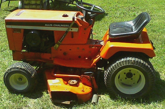

I have a 916 Hydro that I've owned for...34 years..
For the life of me...I can't remember if the "PTO Drive Belt"
is the belt that connects the PTO to the Mower.Wacko
It's been so long ago that I've replaced it..my memory
eludes me..!
Under the hood the Decal reads:
Transmission Belts
   Hydro 1650502 - -( 46.1"  X  0.5" )
48" Mower
PTO Drive Belt - 2087732 - - (Tractor to Mower..?)
Arbor Drive Belt - 1657044 - - (Mower Belt..?)
Mower Blade - 1656143
2087732 - ( Universal 248078 - Replaces:Allis Chalmers:2087732 )
                                    (78" x 0.5"
1657044 - ( 93.1" x 0.5")
I have all the belt numbers written down in my dilapidated
OEM Manual...and searched the OEM numbers & size.
I just didn't want to spend $24.75 and it be the wrong
one.
Thank You and this Forum that keeps my Baby Alive !

Yea from up under the seat down around and to the deck is the pto drive belt.
Do you have a source of a new one. We could send you one
