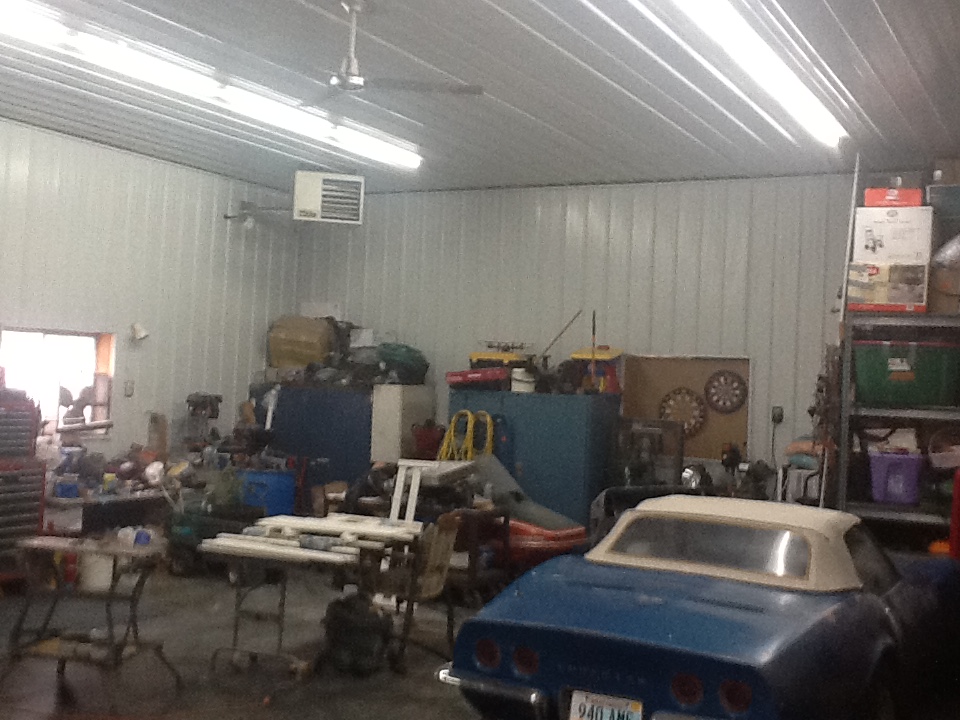

I'm wiring mine pole barn with single sockets.  Our local IGA store has Maxlite LED 4 pack 100w for $0.98.  For 25¢ each bulb, and a couple bucks for the sockets etc. I'm ready for years.  They'll last longer than me.
Dakota Dave View Drop Down
Location: ND
Points: 3974
Post Options Post Options   Thanks (0) Thanks(0)   Quote Dakota Dave Quote  Post ReplyReply Direct Link To This Post Posted: 17 Jan 2021 at 11:18am
two rows of 6 4 ft leds the light were $40 box of 6 from Amazon. In the barn I put petal lights in the sockets really brightened it up.
