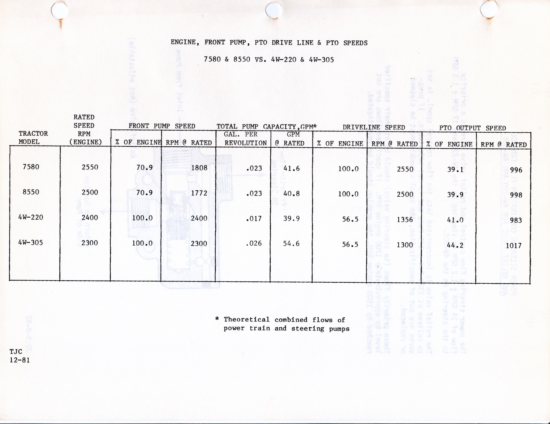

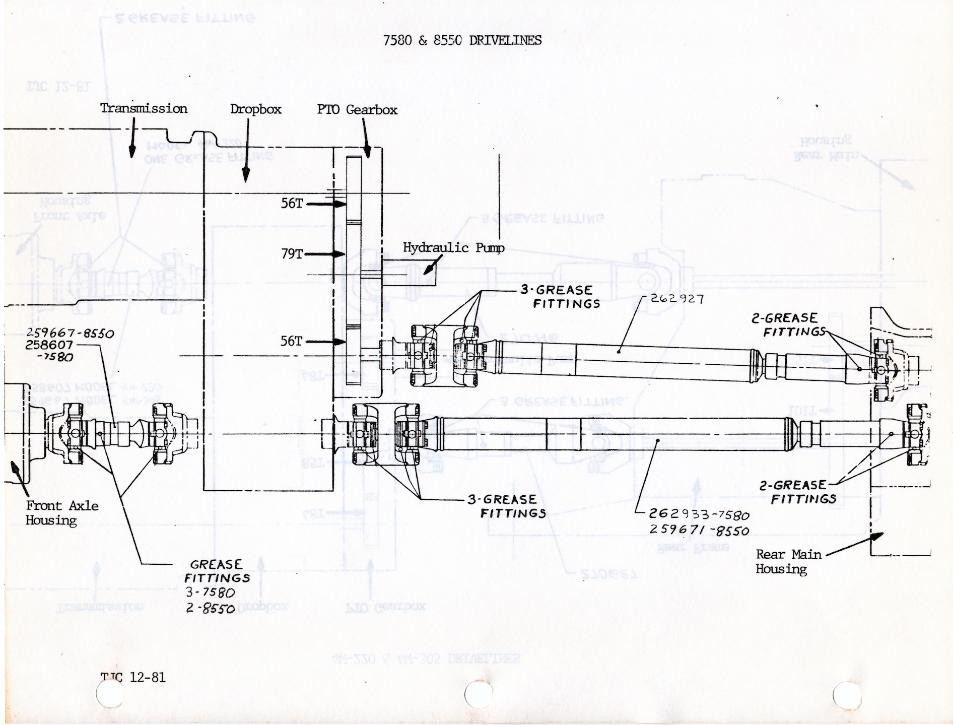

This is some paperwork I found in my books a while ago.  I doesn't really answer the original question but it is interesting info on the differences of 7580/8550 to 4W-220/305.

Post Options Post Options   Thanks (0) Thanks(0)   Quote ajl Quote  Post ReplyReply Direct Link To This Post Posted: 01 Jan 2021 at 2:06pm
Just wonder what the source is of those notes LB?   I have been trying to find output specs for a 305.  It would seem that according to those notes it would have a hydraulic pump output of around 38-40 gpm compared to the 23 gpm rating of my 8070.   The main job we do with these tractors is running an air drill with a hydraulic driven fan which taxes the capacity of the hydraulic system on these older tractors.  Sometimes a 305 comes up around here and it would be nice to know for certain that they have more hydraulic capacity than my current tractor.

Main hydraulic pump is driven off of the rear axle/PTO drive and was never larger than 23 GPM. Had Allis continued, a 40 GPM pump was certainly in order for the times.

Post Options Post Options   Thanks (0) Thanks(0)   Quote LB0442 Quote  Post ReplyReply Direct Link To This Post Posted: 01 Jan 2021 at 4:02pm

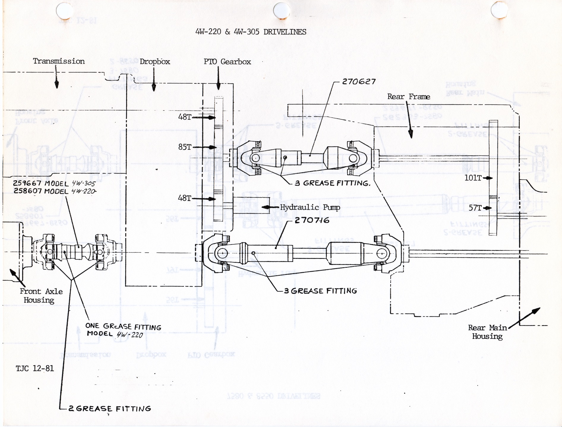

This is out of a factory book for the updated 8000 series.  It is called "qualified service training 1982-83 tractor".  You can see the date of 12-81 in the corner of the pages.  Here are the next 4 pages.

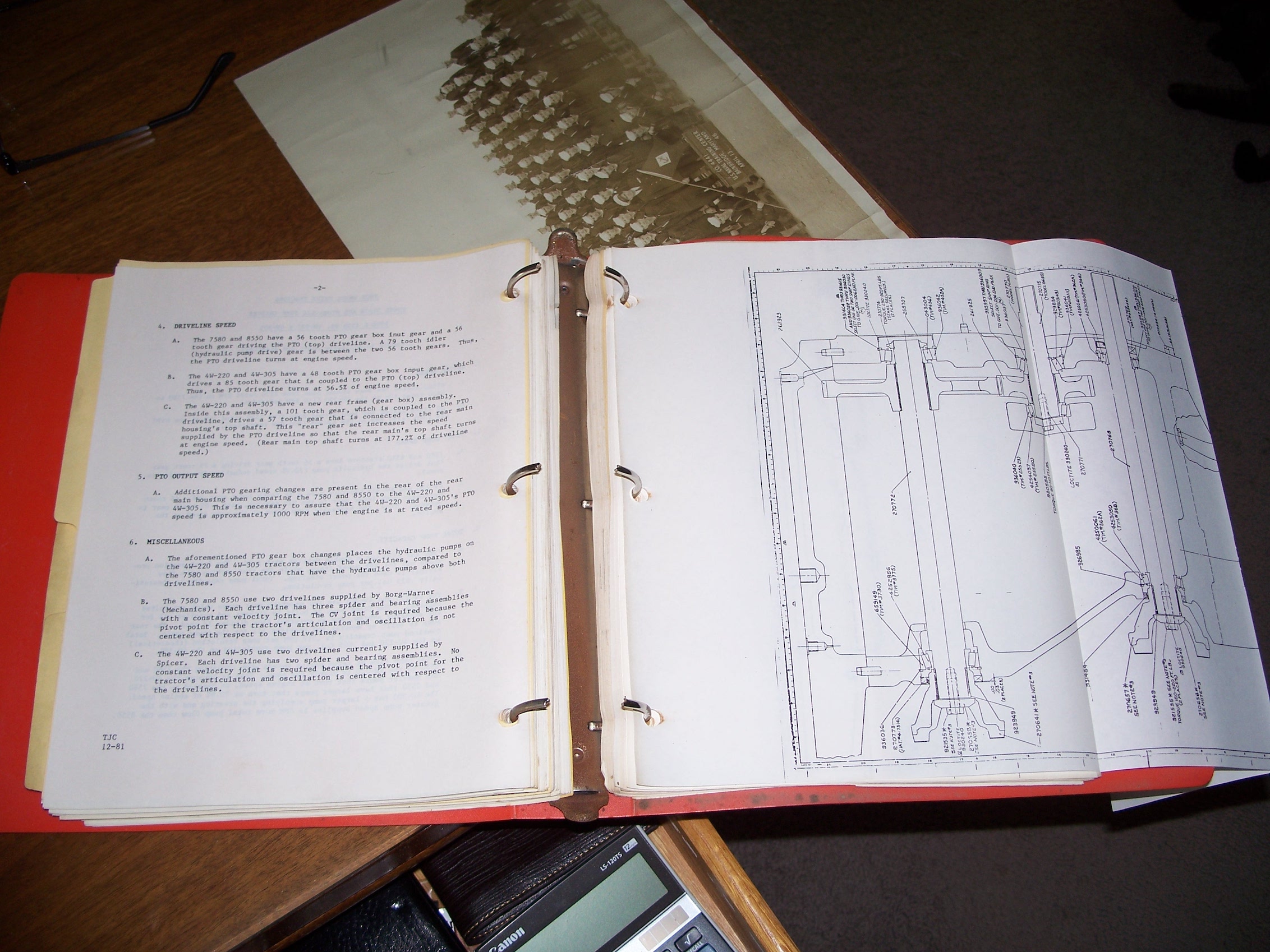

This is the book.

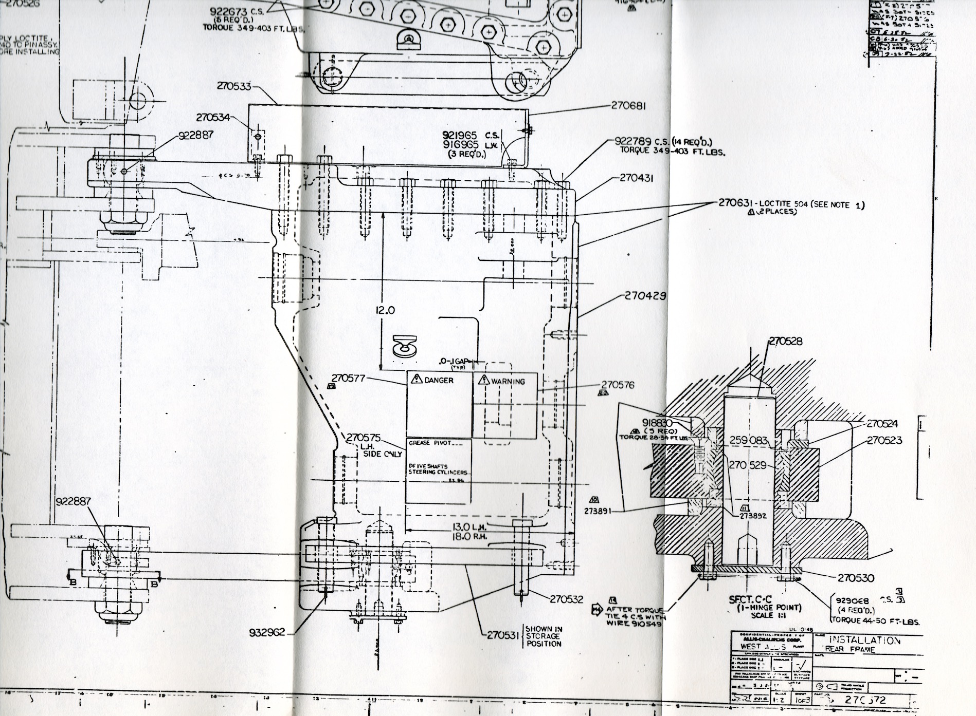

It is full of these over detailed blueprints of all of the driveline and the controls, this is a picture of the articulated frame.  They are too large to go on my scanner, this is just a partial page.

Post Options Post Options   Thanks (0) Thanks(0)   Quote LB0442 Quote  Post ReplyReply Direct Link To This Post Posted: 01 Jan 2021 at 4:36pm
Obviously they are listing combined flows of all the pumps on that page.  So if you have 23 to remotes, 17 to steering, that would leave 14 for lube??  That would be for the 4W-305, 54gpm.
