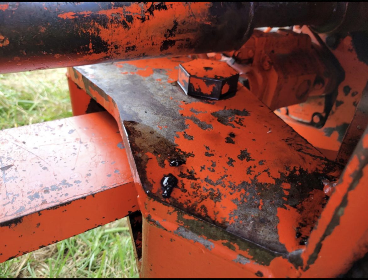

Post Options Post Options   Thanks (0) Thanks(0)   Quote 55allis Quote  Post ReplyReply Direct Link To This Post Posted: 28 Jan 2025 at 10:30pm
I’ve been thinking for a bit and came up with a few more questions again.
So I’m thinking about strength and trying to do the calculations to get it right.
Is the thick arm in the picture above hardened or higher strength than plain steel?
What is the thickness, width, and length of those two arms?
What size is the pins?
Hope I’m not asking too many questions for a’ll….
Points: 22578
Post Options Post Options   Thanks (1) Thanks(1)   Quote DrAllis Quote  Post ReplyReply Direct Link To This Post Posted: 29 Jan 2025 at 7:53am
The ONE (not two) dog-bone lower link (pretty sure) is simply mild steel. It has no need of anything special.  Size?? about 2 inches thick and about 5 inches wide. Length?? I have no idea and it doesn't really make any difference right now.   How big of bolt at the spherical joint?? Probably an 1 1/2", but again this isn't important at this point. Park your two Case tractors nose to rear and space them to proper scale of 126 inches of wheelbase and start designing the project. The diameter of the rear tires on each may not be to scale either, or make them the point of scale and build around their diameter. And as far as the dog-bones pivot bolt size???  for what you're doing a 1/2" grade 8 bolt would be plenty !!!
