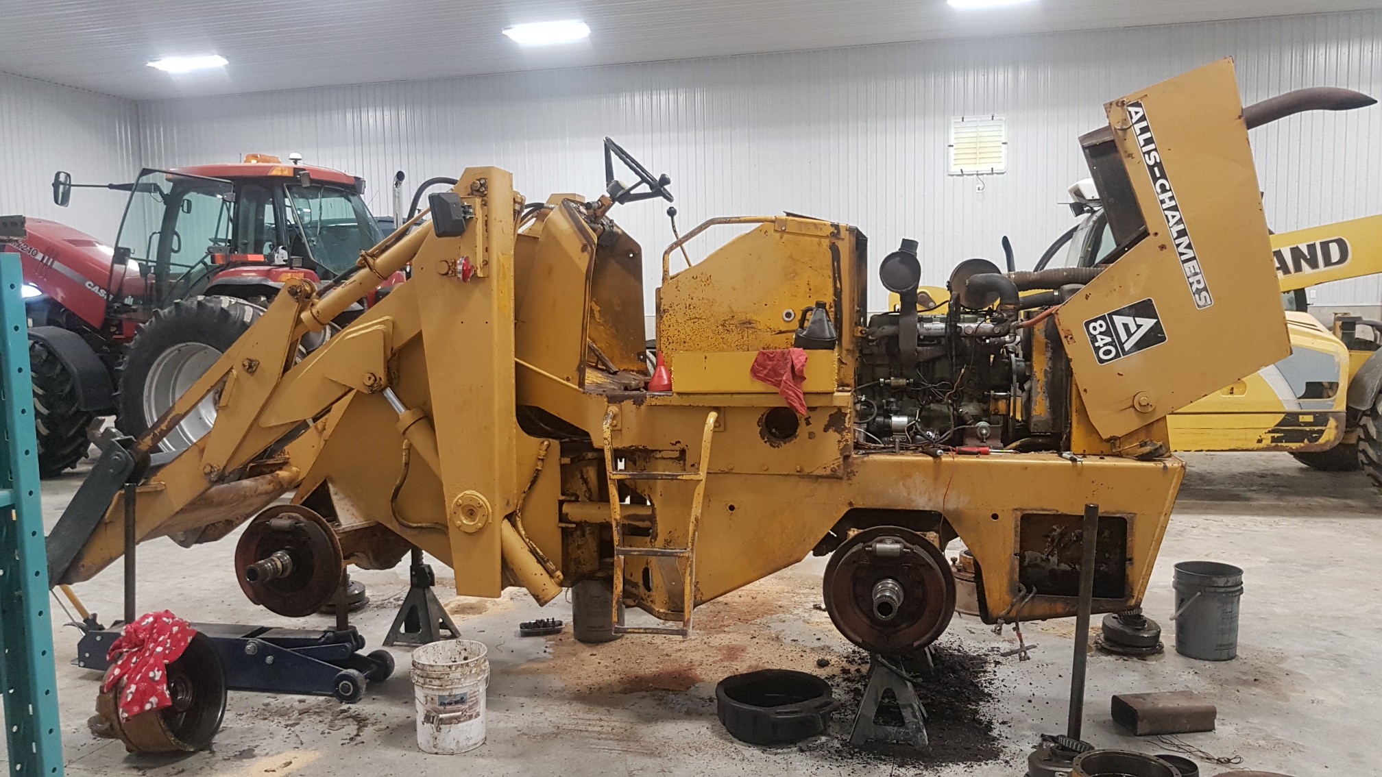

Pulled everything apart, everything is in working order, puzzled, shoes are ok for being original, brake cylinder and booster both work

Post Options Post Options   Thanks (0) Thanks(0)   Quote giffenfarms Quote  Post ReplyReply Direct Link To This Post Posted: 21 Dec 2017 at 6:36pm
giffenfarms View Drop Down
Joined: 31 Dec 2015
Location: Minesing
Points: 19
Post Options Post Options   Thanks (0) Thanks(0)   Quote giffenfarms Quote  Post ReplyReply Direct Link To This Post Posted: 21 Dec 2017 at 6:45pm
She's getting a complete check over, next on the list once we figure out the brake problem is to replace the center pivot pins, lots of movement

What a beautiful shop you have!  Sorry about that red tractor with the hood up...lol

Can only see the floor and the lighting but that looks like a great shop.

I am impressed too! Can you give me some insight into what has to happen to pull the drums on that machine? I have an 840 that has leaking cylinders on the wheels. Does the drum come off simply after removing the wheel or do you have to take the big "hub" off too? Thanks in advance!
