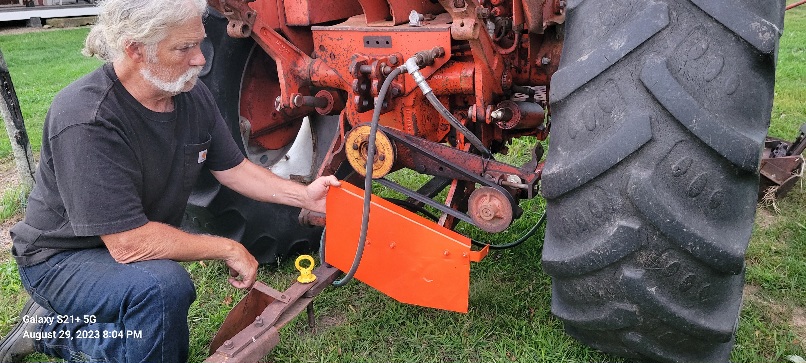

I have a rear belt and PTO cover if you are interested ?
I can bring to Boonville.

Post Options Post Options   Thanks (0) Thanks(0)   Quote AC720Man Quote  Post ReplyReply Direct Link To This Post Posted: 27 Feb 2024 at 7:24pm
Macon, I hope that's a spare as those are difficult to come by. Best mower AC made IMO. Took me 3 years to find one.
