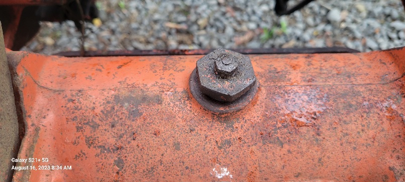

I've been working on an 80 R3 (or an 82, 83 not real sure on which model) but it is the twin wheel drive.  Does anyone know what oil is supposed to go into the gearbox and how much of it?  I would any 80X90 or 75W140 would be fine, I also do not see a plug on the gearbox that oil will flow out once filled to the proper amount.

There is only the plug which is on top of the housing.
This is taken directly from my manual for the 80T trail mower.....same gear box.
                      _____________________________________
"Drive housing, capacity one Qt. SAE 20 or 30. Do not let oil level get below or do not fill above the drive shaft."

This one actually has a drain plug on the drive housing towards the front down low and it has the fill plug on top.

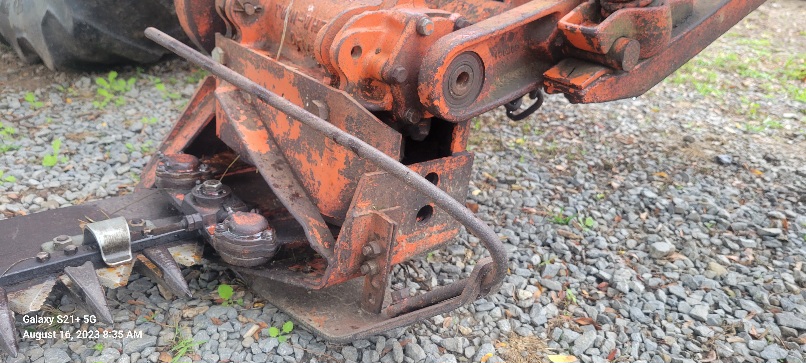

Post Options Post Options   Thanks (0) Thanks(0)   Quote Macon Rounds Quote  Post ReplyReply Direct Link To This Post Posted: 16 Aug 2023 at 7:47am
Edited by Macon Rounds - 16 Aug 2023 at 7:48am

Are seals a available for the gear box?

if it's leaking out the horizontal shaft you probably have to much oil in it.
I never had one leak out the bottom shafts.
Make sure you grease BOTH grease fittings on front and BOTH fittings on the back of the gear box output shafts.
