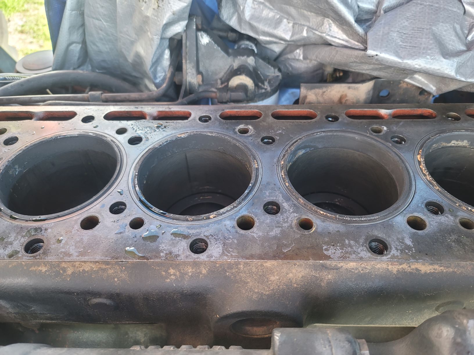

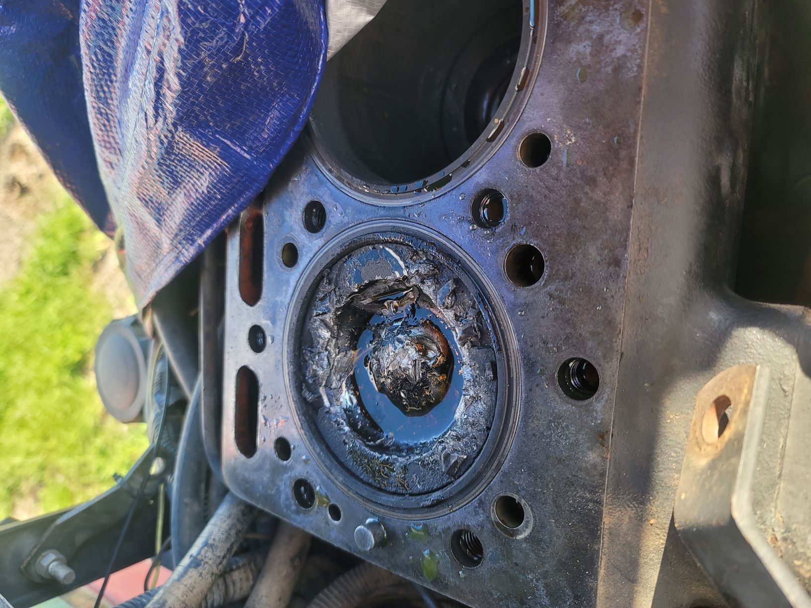

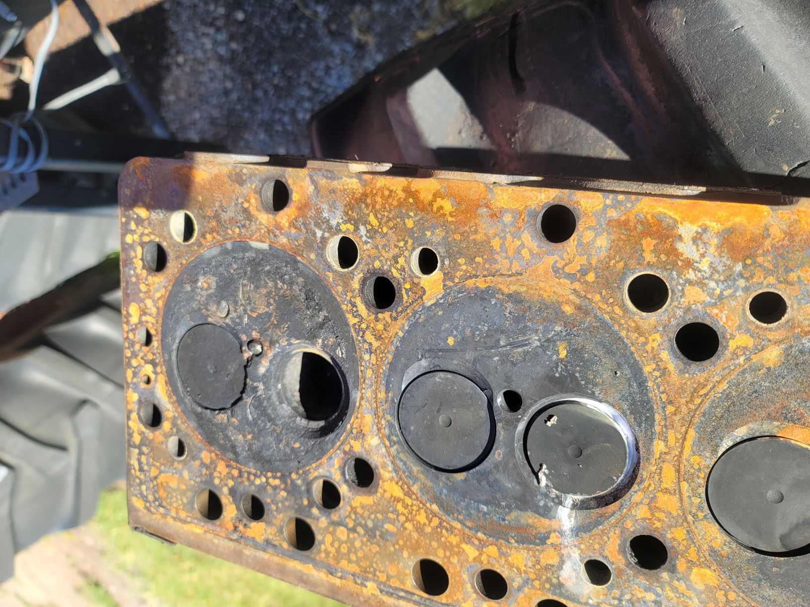

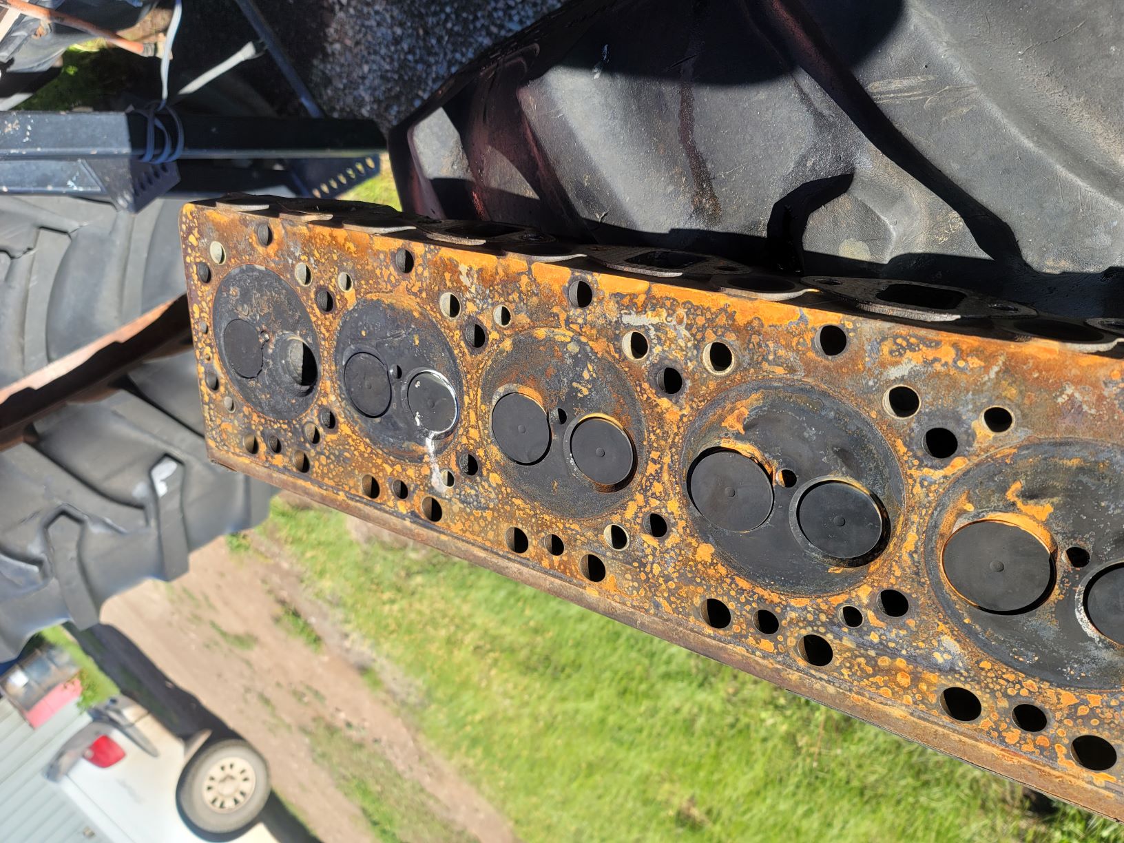

First off, I apologize if this is posted in the wrong place.
I need help.  I have an 8070 that I have had for about 20 years. I live in Colorado and elevation is about 8000 ft above sea level.  I have rebuilt the motor twice with in frame kits but I am not having much success.  I have melted pistons, and now have one again and a bent rod.  One injector will have to be taken out at machine shop.  I cannot keep the motor cool.  I have a new radiator in it, water pump, and new turbo.  Tractor is solid everywhere else - just the motor - has about 8500 hours on it now..
THought about doing a conversion kit to an 8.3 cummins but those are expensive.  THoughts?
Also thought about rebuilding the 426 but have no idea if I will have the same problems down the road?  thought?   Suggestions on a rebuild kit and where to get it?  Send the motor to someone or exchange for a rebuilt/reman one?
Or Part out the tractor and move separate ways? LOL

Injectors in backwards. Timing advance stuck in retarded on the injection pump. Probably cannot be over-powered at high altitudes for lack of air. 170 PTO HP max.  Those engines weren't that bad, so something hasn't been corrected and your getting the same results.

One thing stands out to me, you are overheating the combustion chamber as melting pistons and blowing head gaskets are not common on normal operating conditions for these engines in my experience.  I have had one engine I built come back to me and it had two wrist pins seized in their pistons and four pistons had oil carmalized on the underside of them.  Now when they told me it had a tick in it I went to look at it and i added a gallon and a half of oil to it and two gallons of antifreeze, this is after 1500 hours on a outframe rebuild.  Obviously it was overheated and I know exactly how it happened as I could here it a concession away...
I think Dr's post above is likely where you will find the cause of your issue.  I wish you the best of luck, and I would definitely not be afraid to run one of Bob's engines in my tractors, I have heard excellent things about them and he has updated this series to where the technology of today allows, keeping them simple with available reliable parts too!
