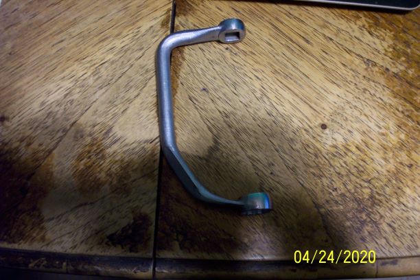

Okay, I have a crow foot 3/8 drive three-quarter inch line wrench, or 1/2 drive open end crow foot. Is that applicable? Or will that distort the actual torque applied? My retired Ace AC mechanic is under the weather right now and I don't know if I can get his input on this.

Post Options Post Options   Thanks (0) Thanks(0)   Quote DrAllis Quote  Post ReplyReply Direct Link To This Post Posted: 24 Apr 2020 at 6:47pm
Line wrench will not stand 165 ft lbs of torque.

Post Options Post Options   Thanks (0) Thanks(0)   Quote SteveMaskey(MO) Quote  Post ReplyReply Direct Link To This Post Posted: 24 Apr 2020 at 6:48pm
    This is probably what the Dr is talking about. ½’ drive on top and 3/4 “ bottom 5 ½” clearance. Snap-on S9513C. You can use it if it will work
