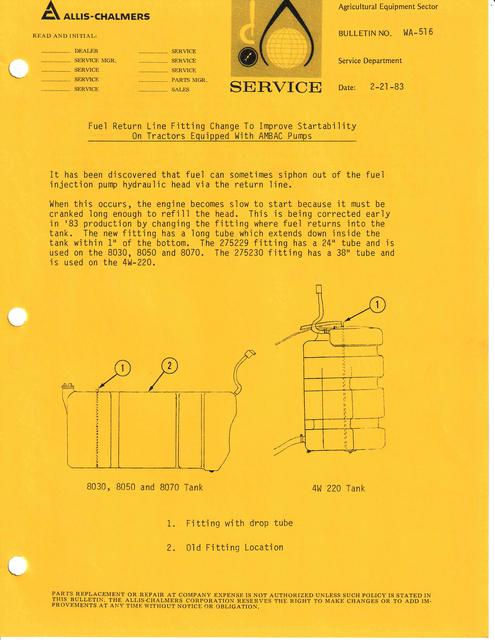

Hi Guys, my 8070 looses prime after sitting for a day.  Probably closer to losing prime after sitting about 5 hrs and seems like it is getting worse.  Use to be about 3 days of sitting before you had to crank it alot.  There is no smoke coming out of the pipe for probably 7-8 secs and then runs like it is short on diesel for the 20-30 secs.  It has been this way for about 10 years.  Last summer, I overhauled the motor, injector pump rebuild at Beemer Diesel (very reputable), checked injectors and good.  All seals on the lines have been replaced during the overhaul. No leaks. Filters changed yearly which is about 50 hrs max. New batteries and cranks fast or like it should.  All this had zero difference on it and maybe even got worse.  It doesn't matter is the tank is 3/4 full or nearly empty. Once started, runs great and power as advertised. With cooler weather coming, it will crank longer to start. I have a holley electric fuel pump on a parted out N5 that I was going to install on the hose from the bottom of the tank. Maybe that will show a leak on the suction side??  Will I hurt anything installing that pump on it pemanently.  I think it is a 5 gpm.   What am I missing? Tractor has about 5500 hrs on it and I've had this tractor since nearly new.  Thanks Greg

The first 8000 series just had the return into the top of the tank, the later ones and updated tractors have it go into the top of the tank with a tube that goes to the bottom of the tank. That way it doesn't drain the return line along with the head of the pump. Yes all should have the update done. Ill get you guys a scan of the factory update sheet.

Figured it was the return draining away somehow.  Priming pump is new with the injector pump overhaul as it is on the injector pump. Breather vent is good also. Curious too on the return line fix.

Post Options Post Options   Thanks (0) Thanks(0)   Quote Peterson Quote  Post ReplyReply Direct Link To This Post Posted: 08 Aug 2019 at 11:21am
Here ya guys go.

A lot of times that plastic tube falls off and is laying in the bottom of the tank.
