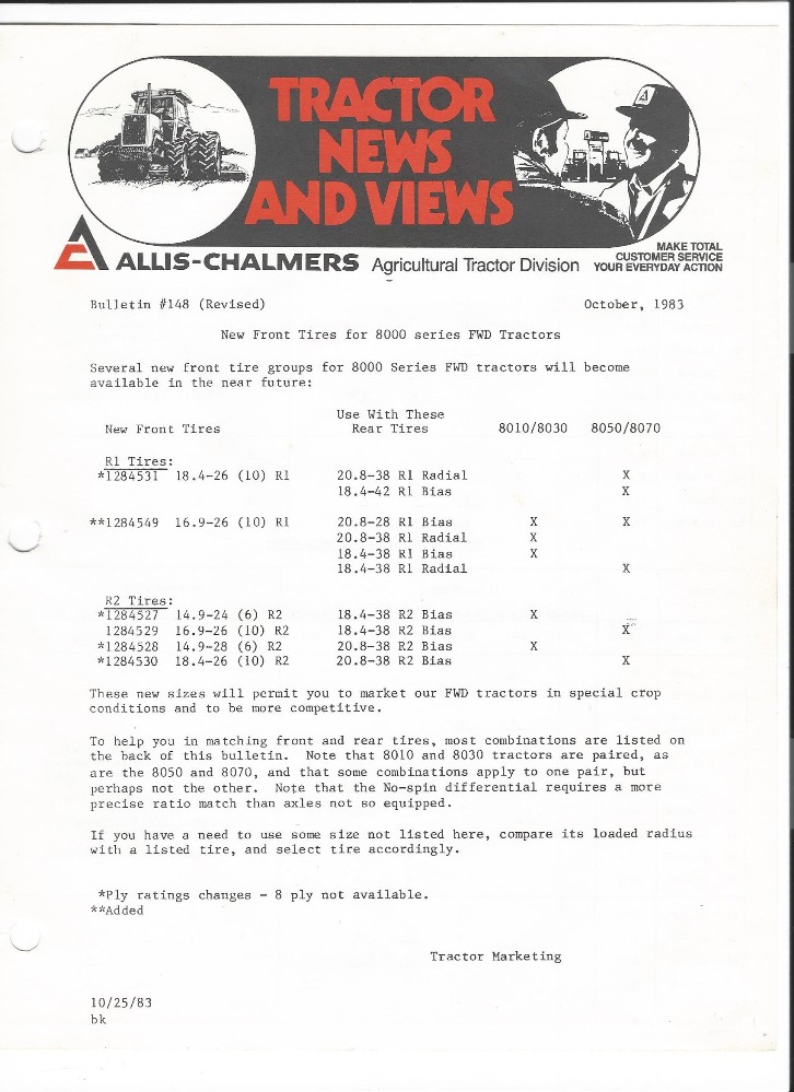

Fred Dunlop wanted to share these with you all.

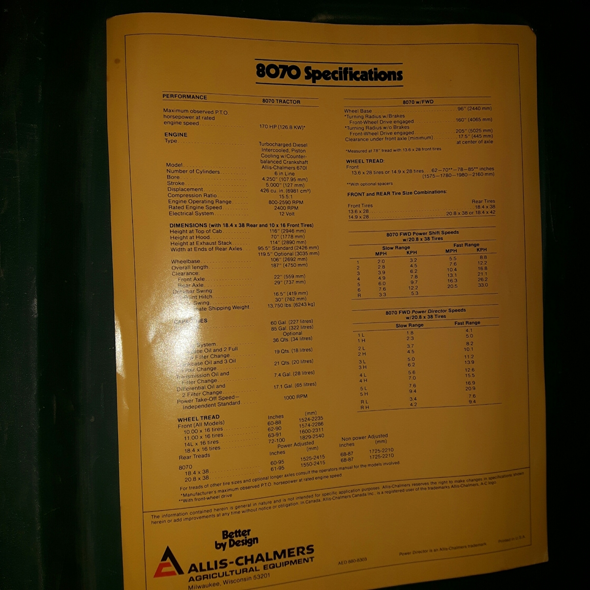

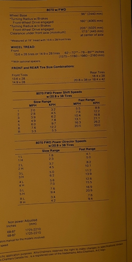

Would you please post the specification page so we can please see the right hand side of the page??  Thanks

Neb try this.
Have it in the window of your computer. Then hold down the control key and hit the - (minus) key it should make your screen smaller so you can see it.

At bottom of page of 8070 specifications as shown above   number is AED 880-8303
Thanks Fred Dunlop!

So I dont think anyone answered this... was allis actually putting on these 26" rims on the tractors??  My tractor is a late 1984.  Seems like guys with 85's are who have 26's... maybe Allis was getting rid of surplus parts?

ALLIS ABSOLUTELY DID PUT 26 INCH FRONT WHEELS ON SOME OF THE LATER 8000 TRACTORS!!!! I SOLD 3 OR 4 OF THEM LIKE THAT! THE ADVERTISING LITERATURE DIDN'T ALWAYS REFLECT WHAT WAS COMING OFF THE ASSEMBLY LINE !! IT ALSO DIDN'T REFLECT THE LATEST POWER SHIFT TRACTORS HAD A FASTER LOW RANGE, BUT THEY DID !!!   Also, a 20.8 takes an 18 inch wide wheel and an 18.4 takes a 16 inch wide wheel.
