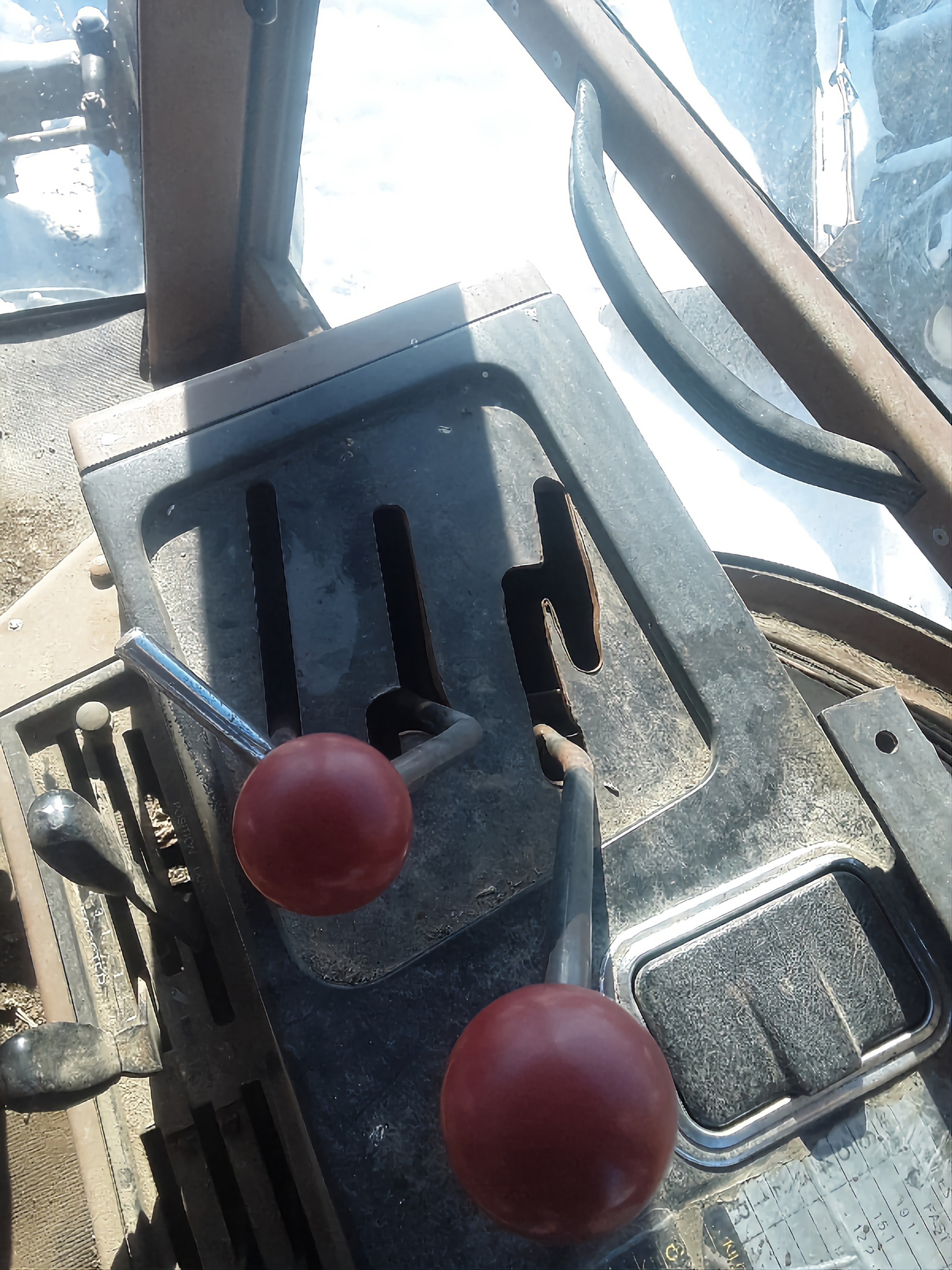

Also this is an 82 had the throttle on the dash which sticker and all is still there but on shifter console they moved the h/l and range shifter to the right and added the throttle on left right next to them on top   wish I could get pic on here   it's way neat. Was there an upgrade to do this.     Also I've been reading my 7000 series service manual and I'm gathering that it may be a stuck valve   any more input would be greatly appreciated thanks

Post Options Post Options   Thanks (0) Thanks(0)   Quote KWarby2 Quote  Post ReplyReply Direct Link To This Post Posted: 09 Jan 2022 at 5:33pm
Points: 22307
Post Options Post Options   Thanks (0) Thanks(0)   Quote DrAllis Quote  Post ReplyReply Direct Link To This Post Posted: 09 Jan 2022 at 5:40pm
That throttle is home made.

Post Options Post Options   Thanks (0) Thanks(0)   Quote KWarby2 Quote  Post ReplyReply Direct Link To This Post Posted: 09 Jan 2022 at 6:06pm
I didn't get pic resized small enough but that's what we thought. Looks really good in person   much handier
