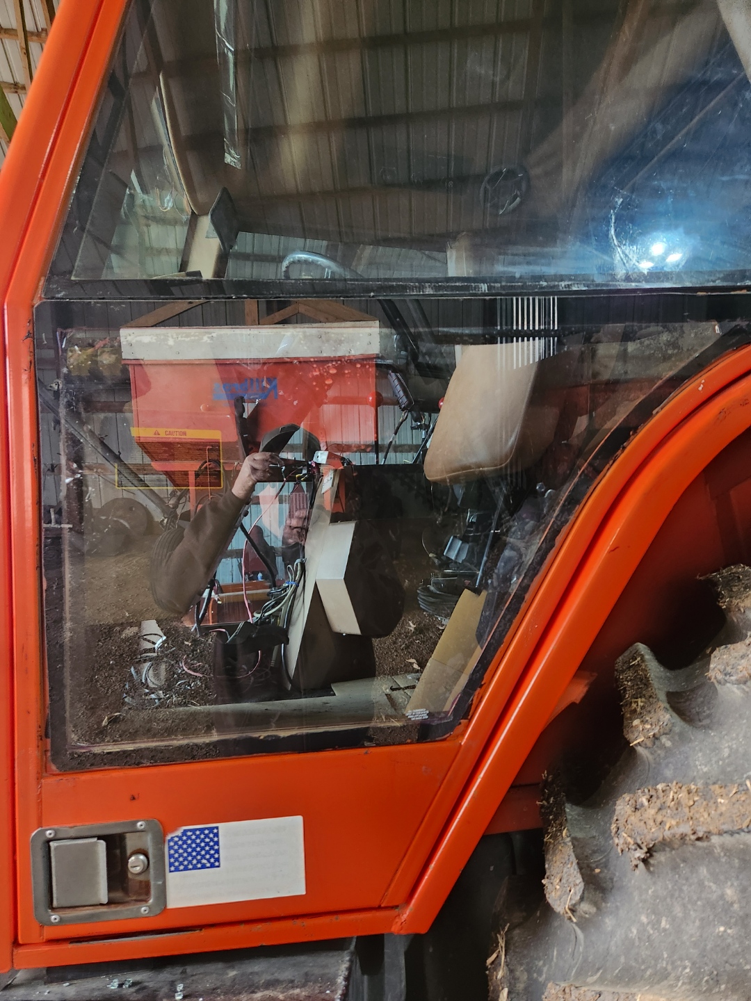

If you have any pictures of the glass in the vinyl around it post them, I install commercial glass and some residential. Auto glass can be a whole different animal so to speak but I  may be able to point you in the right direction. I made up some glass for a buddies old pick up that had plate glass instead of safety glass. It has safety glass now.

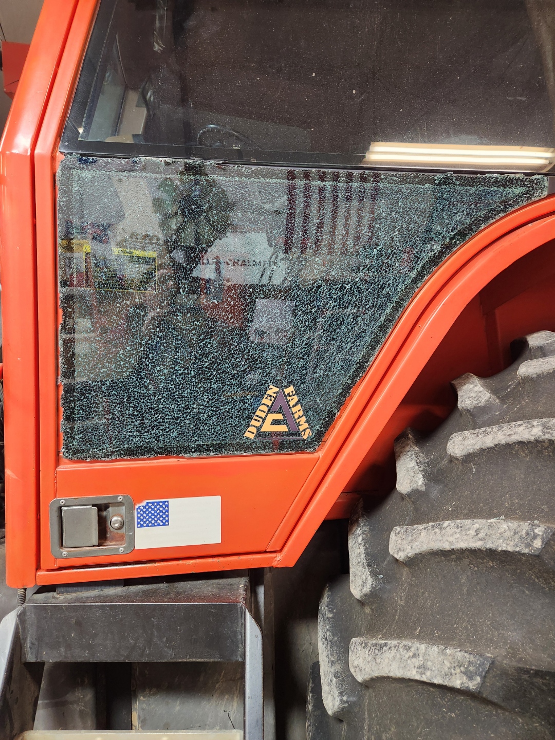

Well, i was putting the cab filter back up there a was using a small line up punch to get it lined up. got the filter and frame back in and laid the punch on top of the cab.
It rolled off the roof and just hit the top edge of the glass, it sticks about a 1/4 of an inch, and shattered the window. Just enough to hit it. Whats the chance of that happening!

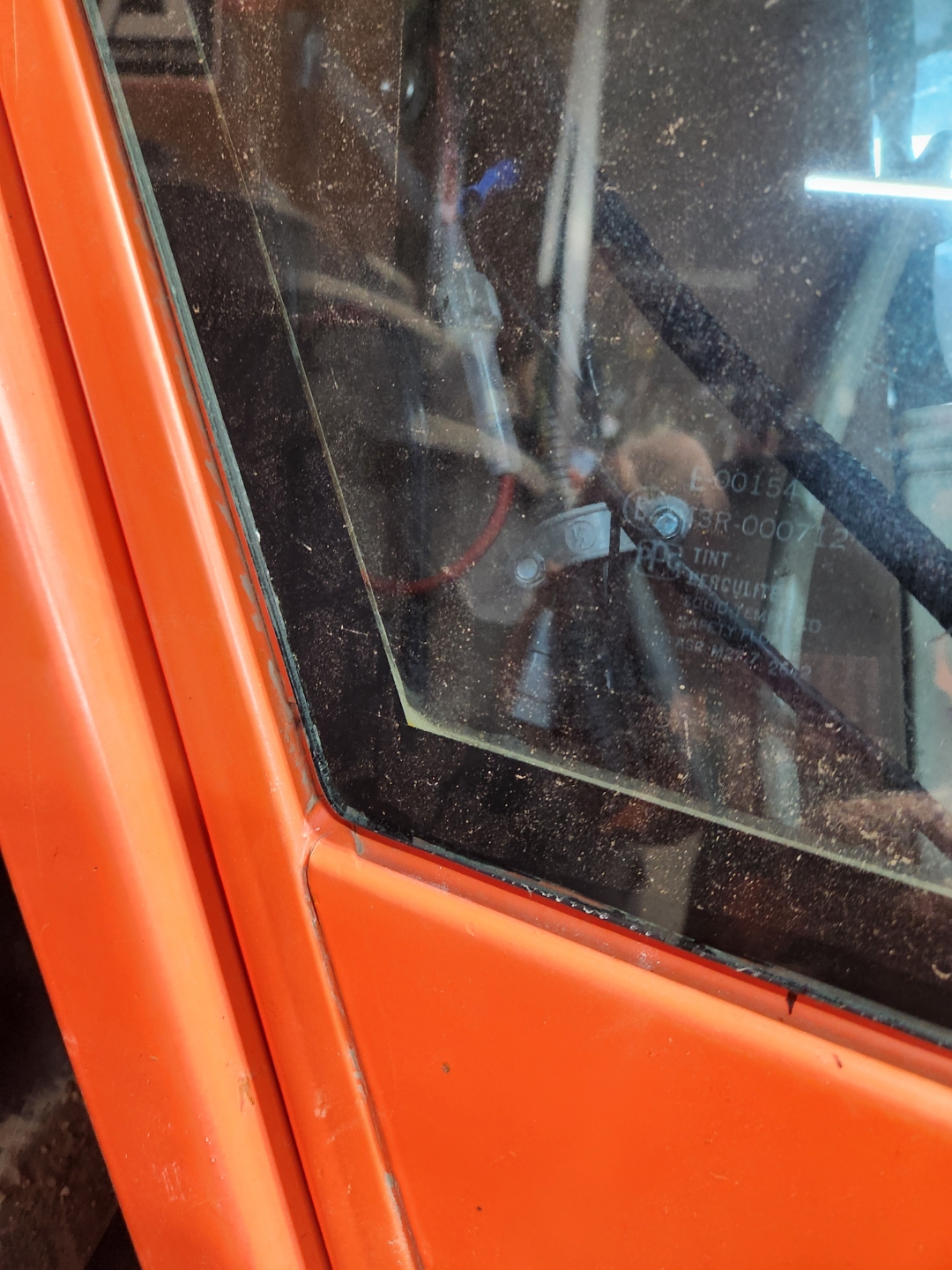

One more question, there is a black border around the glass, you can see it in the picture.
Is that primer on the glass?

It may be paint finished, or it may be the sealant behind the glass. If it is paint it may have been put on before they tempered it.

Got the glass installed, all on all, everything worked out good.
