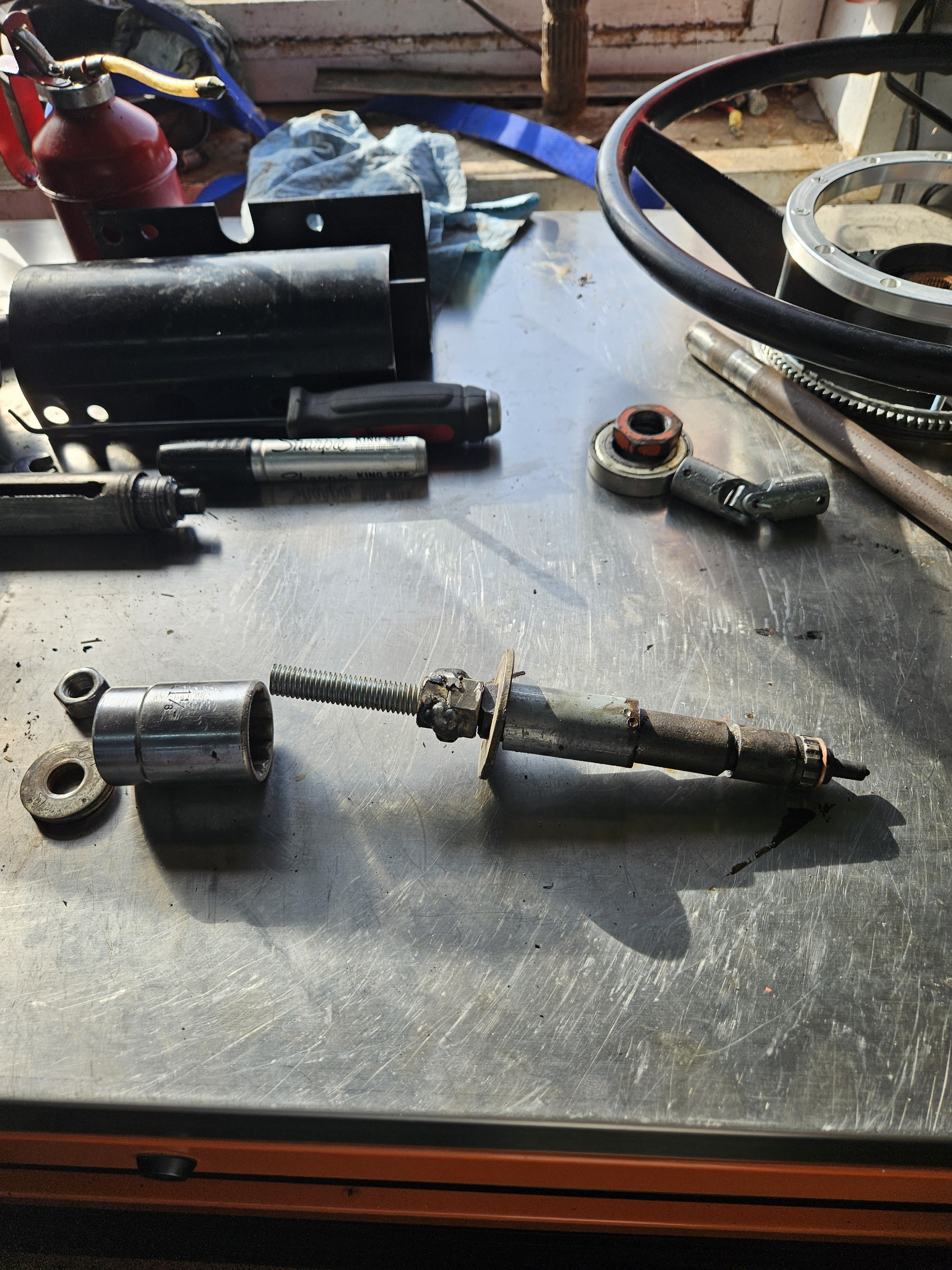

Post Options Post Options   Thanks (0) Thanks(0)   Quote 977.3Ford Quote  Post ReplyReply Direct Link To This Post Posted: 26 Feb 2024 at 2:58pm
Crisis averted. Made a crude puller and with some tapping from a hammer I was able to walk the injector out after a while.

Post Options Post Options   Thanks (0) Thanks(0)   Quote tbran Quote  Post ReplyReply Direct Link To This Post Posted: 26 Feb 2024 at 4:17pm
We used a pneumatic air chisel after soaking a day - while pulling on the nut threaded to the top.   The vibration helps big time.  The same method we use getting the head bolts to break loose on a Deutz. Hammer and pull/twist. A bosch puller can be made with a deep well socket or tube... you can buy them - or could years ago.

Post Options Post Options   Thanks (0) Thanks(0)   Quote bigal121892 Quote  Post ReplyReply Direct Link To This Post Posted: 26 Feb 2024 at 5:14pm
I have gotten them out, by just barely loosening the hold down bolts, then crank the engine.
