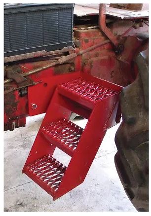

Have you tried the Noonan steps?  I put one on my 190XT and I am very happy with them.  Direct bolt on and nice evenly spaced pads.  The factory steps leave little to be desired by comparison.

that step above works great if you have two good legs... If you have one weak leg you might want a set of WIDE steps so you can step up, then pull your other foot to that same step, then step up again, etc..... Each step is wide enough to get both feet on at the same time............... plus it can be sloped more like stairs instead of a step ladder.

I bought 2 of the steps like Dseries shows, one set on my 180 and one on my 190XT, i'm going to mount the original step from the 190 onto the side of the battery box just ahead of the fender to help get me onto the platform.

Post Options Post Options   Thanks (0) Thanks(0)   Quote AC7060IL Quote  Post ReplyReply Direct Link To This Post Posted: 14 Sep 2023 at 7:34pm
Points: 90785
Post Options Post Options   Thanks (0) Thanks(0)   Quote steve(ill) Quote  Post ReplyReply Direct Link To This Post Posted: 14 Sep 2023 at 8:04pm
from ACs post.....
Edited by steve(ill) - 14 Sep 2023 at 8:04pm
captaindana View Drop Down
Location: Fort Plain, NY
Points: 2609
Post Options Post Options   Thanks (0) Thanks(0)   Quote captaindana Quote  Post ReplyReply Direct Link To This Post Posted: 15 Sep 2023 at 12:13pm
Yes they’d be perfect!
