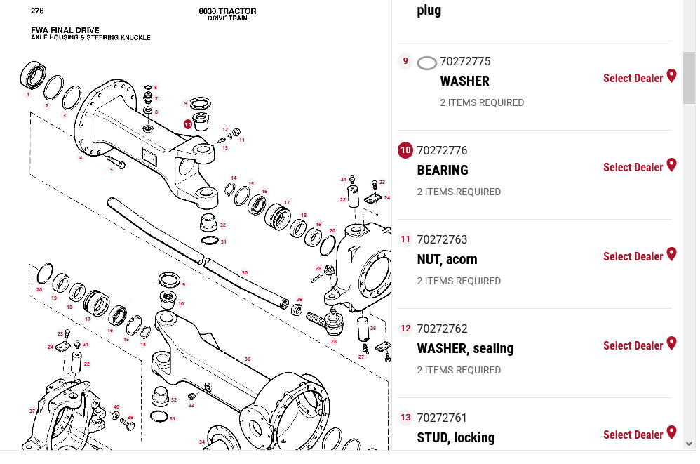

Kingpin bearings for sure.  Having mine done now.  AGCO has the bearings.  The balls and sockets in the ends of the steering cylinder are probably worn out too - mine are.

Post Options Post Options   Thanks (0) Thanks(0)   Quote DSeries4 Quote  Post ReplyReply Direct Link To This Post Posted: 23 Jan 2025 at 4:27pm
