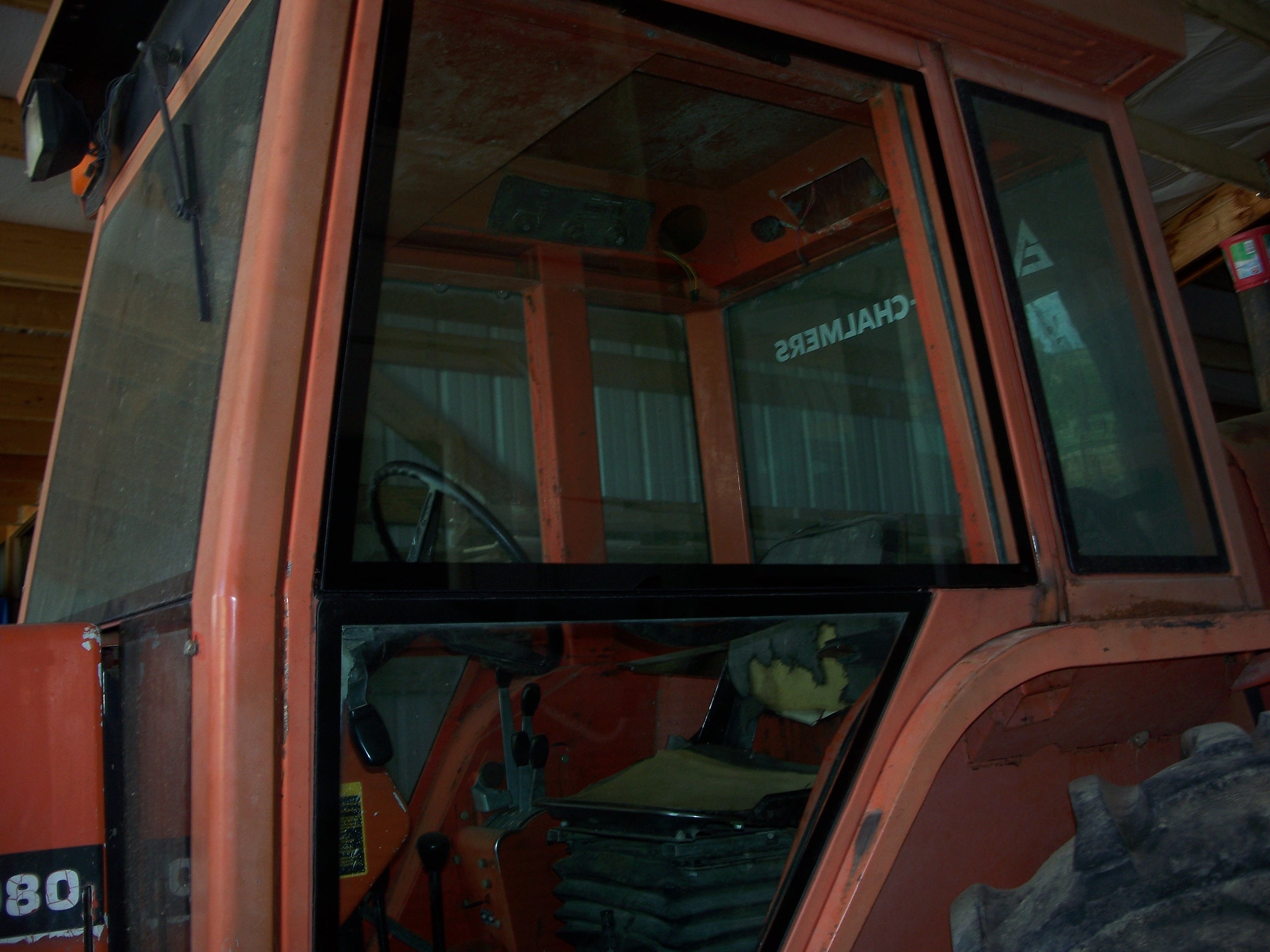

I just bought a 6080 with a broken upper door glass, NLA from AGCO.  I dropped the door off at a glass shop and they had to order the correct green tint glass, then they cut it.  They could not do the black border so I took it to the local Safelite glass installer and they used pinch weld primer for the black border and installed the glass.  It was $178 for the glass and $100 for install.  I would bet that was less than the AGCO price anyway.
