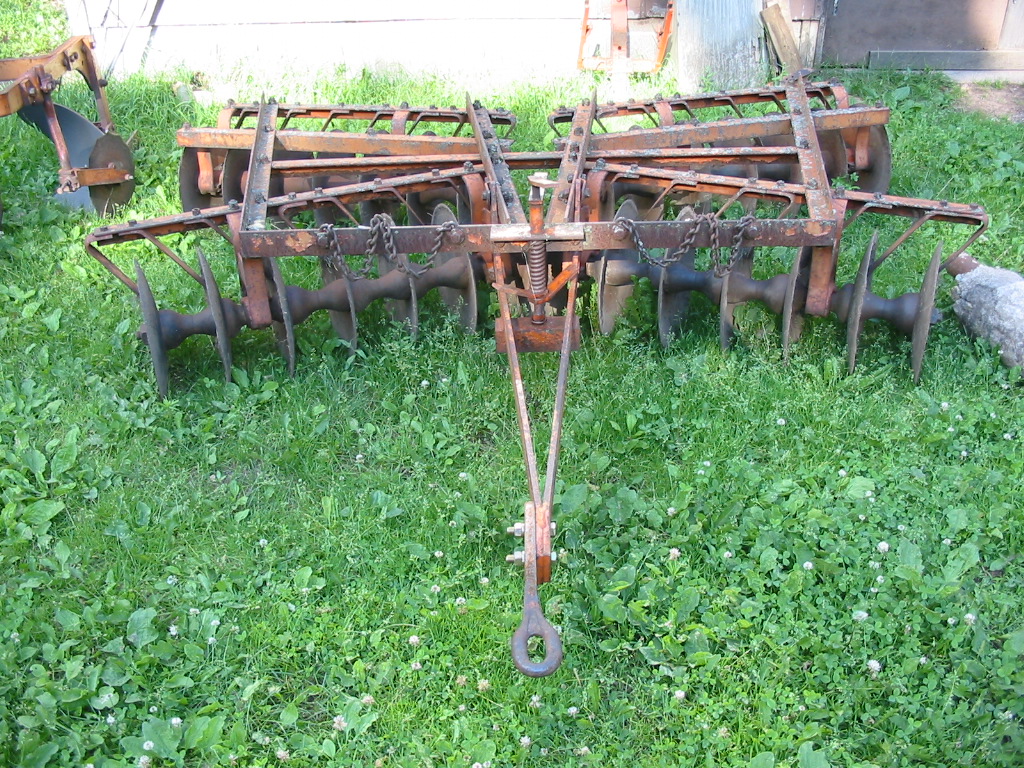

Thanks Brian... I was thinking that too but was wondering if bolting the eye to one side of the disk tounge would affect how straight the disk would pull. What was your experience?
Brian F(IL) ![]() Orange Level Access ![]() ![]() Joined: 14 Sep 2009 Location: Paxton, IL Points: 2717 |
Now that you mention it, it wasn't my disk after all. It was my rear mounted blade that I changed from pin hitch to snap-coupler eye. I'll take a look at the disk tonight and see if I can get a picture of it. |
Here are some pictures of my SC #109 disc. Note it has the ridge reducer extensions on the back gang.

ricksam ![]() Bronze Level ![]() Joined: 06 Apr 2012 Location: Trego, WI Points: 37 |
On mine the tongue is welded together at the end so I just took the loop from my plow and bolted it to the side. Seems to work fine...
