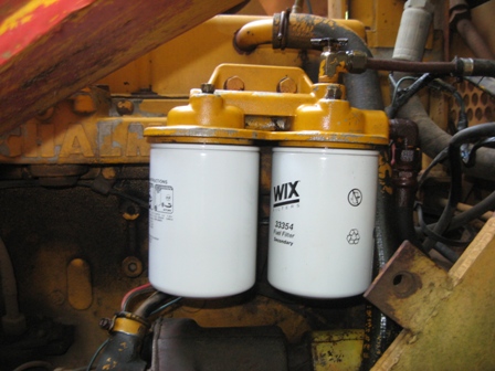

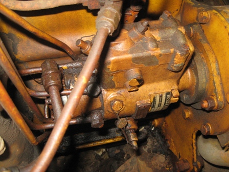

Hello again gents, Well had to play with the toy this weekend and broke it. The fact is the guy i bought it from hadn't changed any of the filters in a number of years, so after getting the engine oil and filters changed I moved on to the fuel filters. So I turned off the the tank valve and unscrewed the old filters, WOW were they BAD. Kinda like a muddy black oozy looking stuff filled both filters, surprised it ran before I started playing with it ... Anyway cleaned up the filter housing, installed the new wix filters, with new o-rings. opened the brass plugs above each  filter, opened the tank valve and let it run until no air. HOWEVER I did not open the bleed valve in the exit line above the filters, dumb. So I proceed to crank it until the batteries nearly died. No joy. After I discover the bleed valve and open it, nothing. Hmmmm. So I unscrew it from the housing and sure enough the bleed hole is plugged. I clean it up, burp more air and try it again, still no joy. I am guessing that air was pushed down to the Roosa Master (its lower in the engine bay than the top of the filters) and now it wont do its injection thing.
Roosa Master Pump (right side of engine)
Filter rack showing two brass plugs and line bleeder. (left side of engine)
My question is what do I do now? I dont have a manual for the pump so I an not sure how to bleed this thing, and do you think I also need to open the injector lines? Any help appreciated. Steve

no bleeders on pump by tag. usually not that hard to bleed a roosa, as long as it is getting fuel, and you can crank it fast enough. Ether in small amounts is very helpful.

Have pressurized the tank and have fuel at the pump but I am not getting fuel to the injectors. I guess the IP is not primed. Ed mentioned that there is no bleed on this pump ?
The pump model number is Roosa Master DCGFC 631-4GR

Found some blockage in the inlet strainer (old thread tape) on the pump but the problem was the metering valve control arm that is pushed/pulled by the governor was stuck in the closed position. Apparently just by luck the arm/valve stuck when I shut it down to change the fuel filters, thus sending me on a wild goose chase after a priming problem. To quote George Miller, "if a roosa pump has fuel, it primes!" Will update again when I get the pump back together and fired up. Thanks to all who pitched in!
